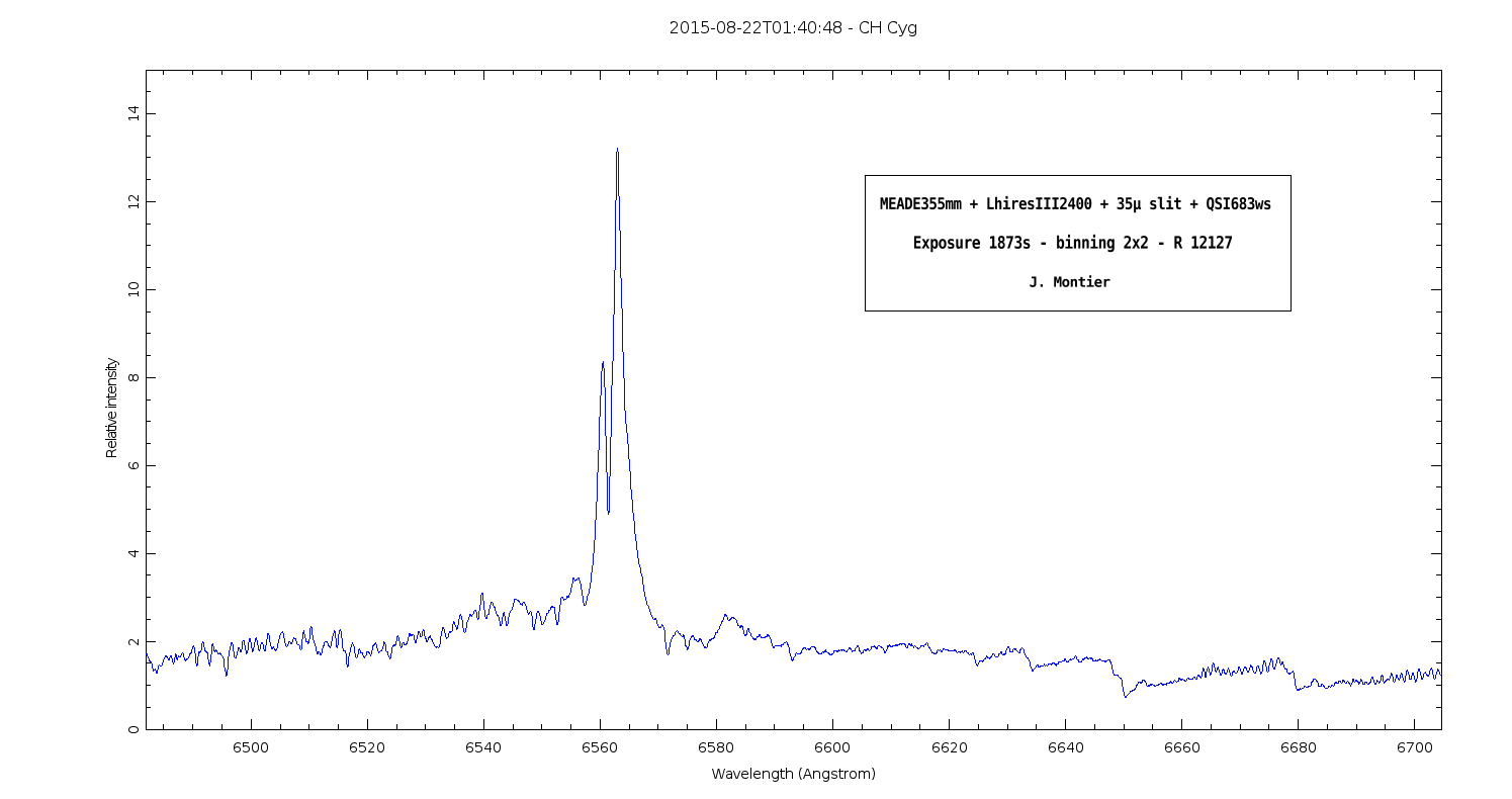

Re: Dramatic change of H alpha profile
Post by Jacques Montier »

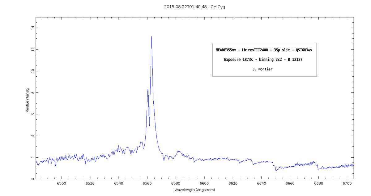

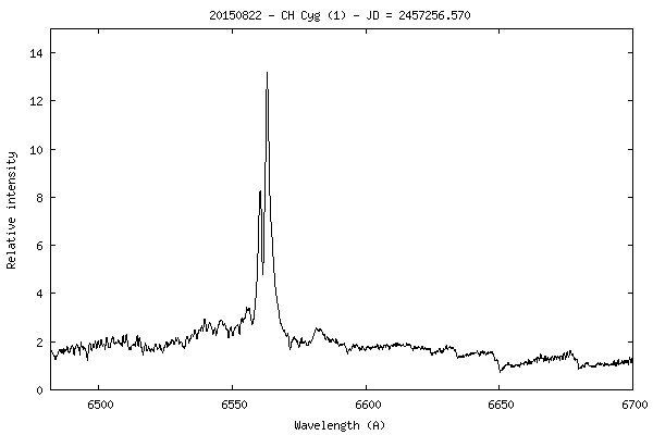

10x180s exposures of CH Cyg on 2015/08/22.
CH Cyg Halpha profile is quite stable.
Best regards,
Jacques Montier

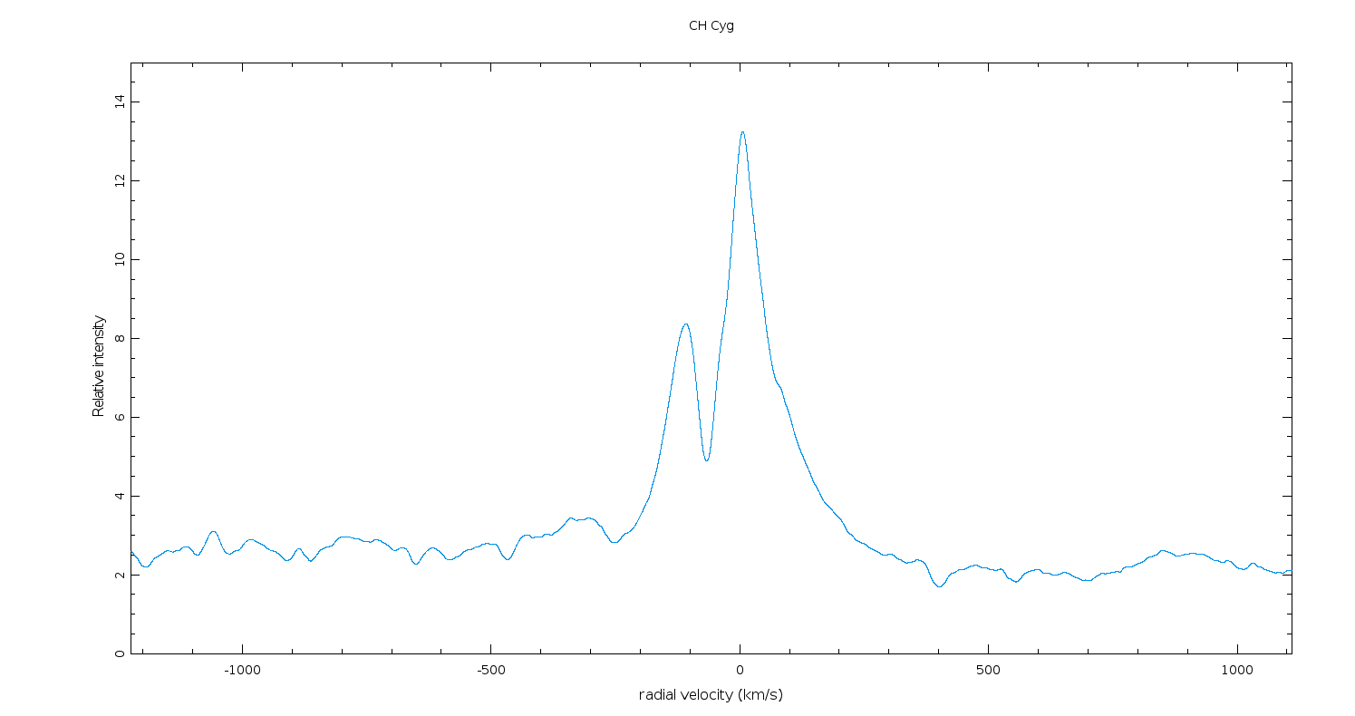

Another time series taken last night during 6 hours.
Some smalls variations in the blue and red part of H Alpha

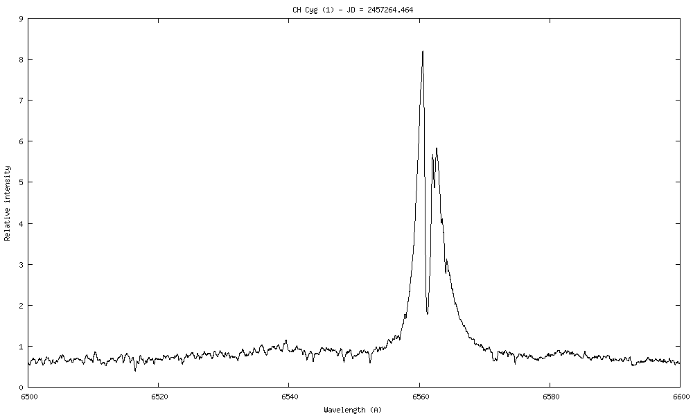

It might be very thin veils (though SNR was exceptionally good this time), but I'm not aware of any H2O line at the right peak gash (LHires 2400/23um slit) that seems to be a new feature comparing to my past observations:
The left peak returned to equal when star reached a tree, obstructing further observation.
EDIT: accidentally used a raw flat instead of reduced one, uploaded a corrected animation (no real change, my statements valid).

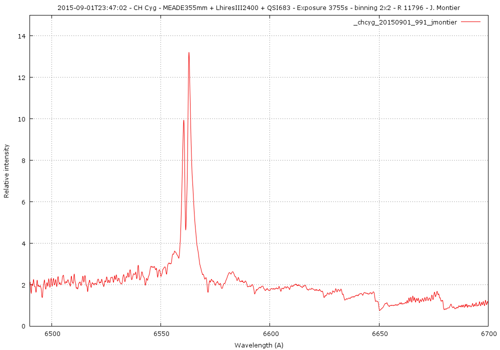

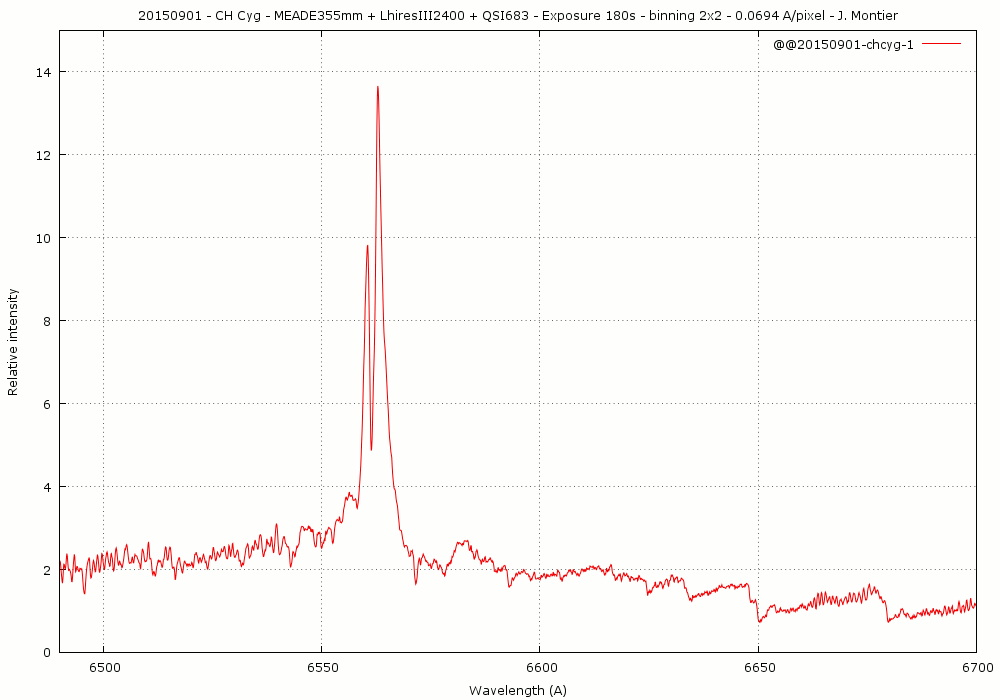

CH Cyg of the last night 2015/09/01
Time series of 18 x 180s
Regards,
Jacques Montier

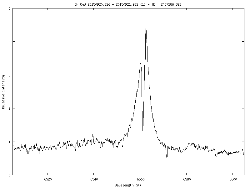

CH Cyg was not at rest yesterday (2015.09.20, 31 x 5 min):
I had to discard the 24. exposure due to cosmic ray has hit directly the H-alpha region, that has been interpolated by (23+25)/2 here.
Sky was poor at this time, so as the SNR.
