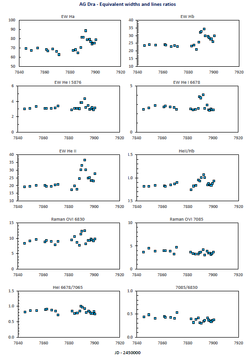

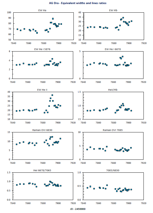

Increase of He II, and Balmer lines intensities in the last spectrum obtained by Joan
Equivalent widths mesaured on Echelle spectra: New observations strongly welcome for the next days

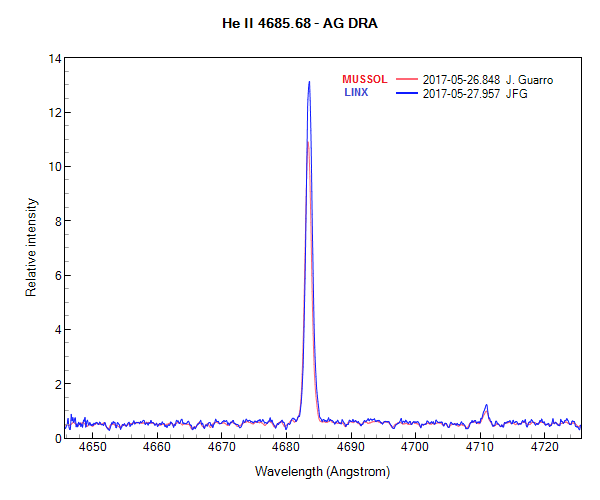

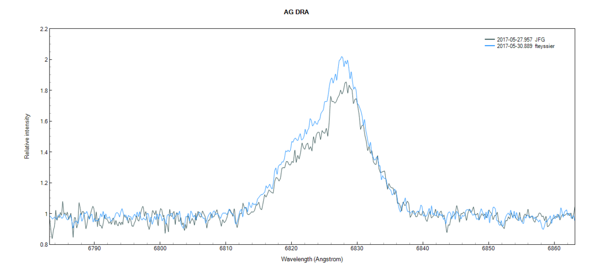

- Posts: 731

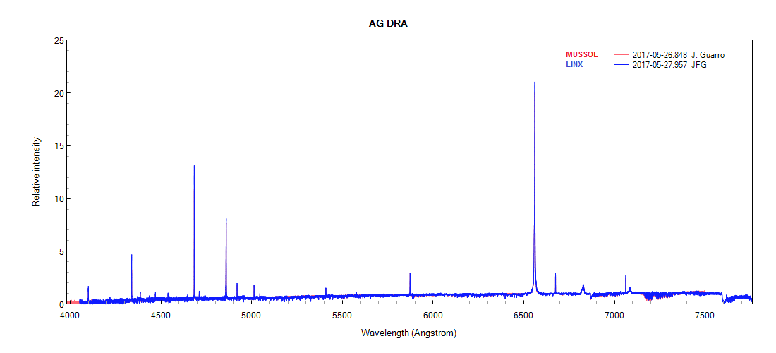

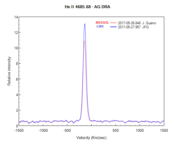

These graphs, are a complement of the François's anterior explanation.
This is de first service of the Linx.
Today is de second day cloud, the weather will improve on next Wednesday.
Regards, J. Guarro.
Regards, J. Guarro.

Jaroslav Merc
- Posts: 27
- Joined: Thu May 04, 2017 11:27 am
- Location: Prague, Czech Republic
According to last AAVSO observations from the previous night, there is an increase of brightness of AG Dra in all filters. Of course, it is based only on the observations by one observer, but nevertheless, also according to your last spectroscopic observation (the increase of EWs of Balmer lines and He II), it is worth monitoring the star in the next days.
We are looking forward to new observations. Have a clear sky!
Regards,
Jaroslav Merc
Regards,
Jaroslav Merc

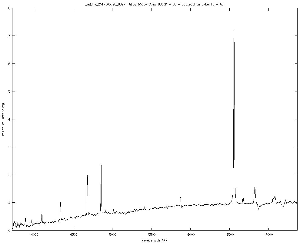

- Posts: 458
I've been having issues processing my LISA spectra...think I just solved it with another tune-up at the scope.
Here is AG Dra on 28May17:
I labeled the probable He lines...Hope we see more "fireworks" in this system!
- Posts: 1562
Clear sky last nightAccording to last AAVSO observations from the previous night, there is an increase of brightness of AG Dra in all filters. Of course, it is based only on the observations by one observer, but nevertheless, also according to your last spectroscopic observation (the increase of EWs of Balmer lines and He II), it is worth monitoring the star in the next days.
The fit is now in the base, Jaroslav
Significant increase of Raman OVI Update of EW from echelle spectra James: the identification of He I lines is correct
Your spectrum is welcome in the base!
Umberto: excellent coverage!

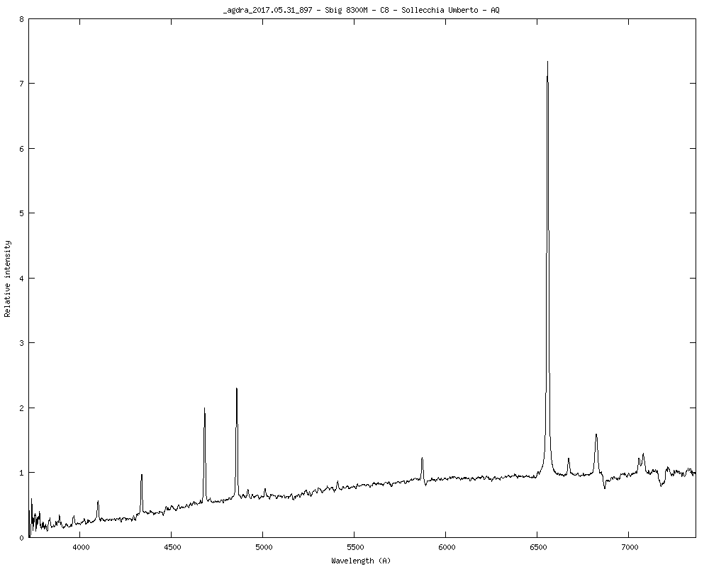

- Posts: 420
This full weekend's one night result - with an experiment, tuning the Alpy 600 focus on the UV (via mercury lamp's UV lines) + scope too (in turn loosing the IR part's focus):
Looks like this tuning brought some extra (Balmer serie full).
Also lost the H-alpha with 3 x 15 minute exposures (almost H-beta, too).
The SNR start to become good from 3650A.
However, no big change in this region.
- Peter

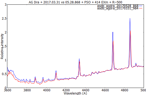

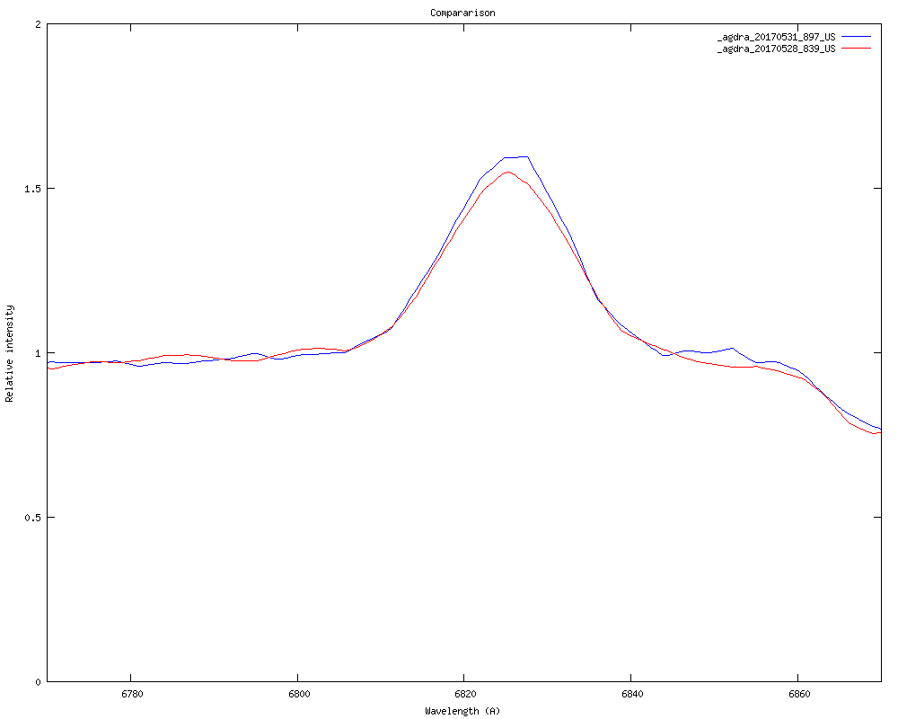

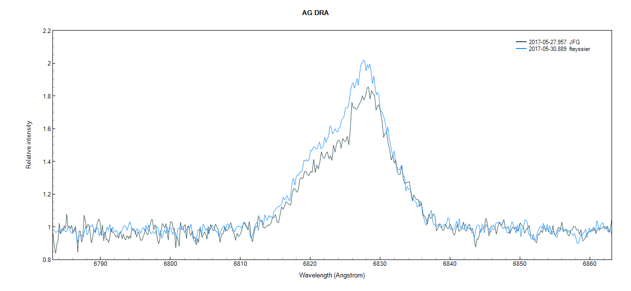

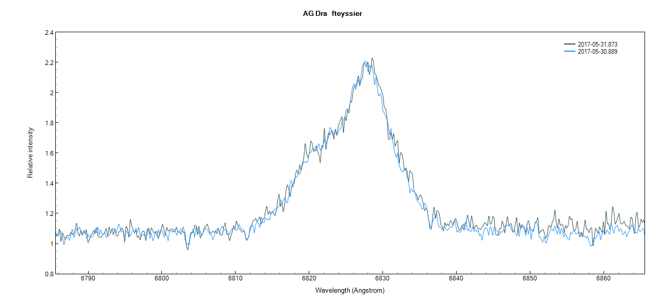

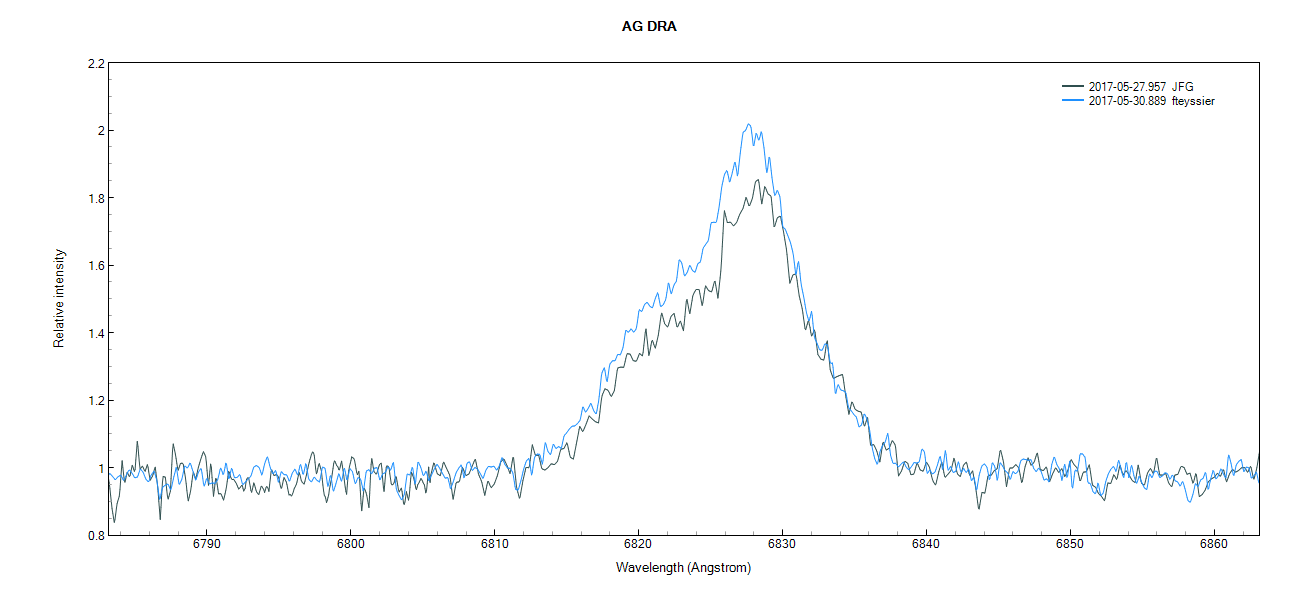

- Posts: 248
Bonjour, voici le profil hier soir et une comparaison des Raman OVI avec le jour 28/05/2017
