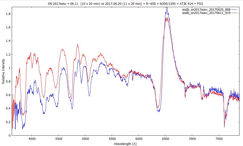

Result from this week:
Some deeper absorptions appear in the range of 5300-5850A (I can't identify at the moment).

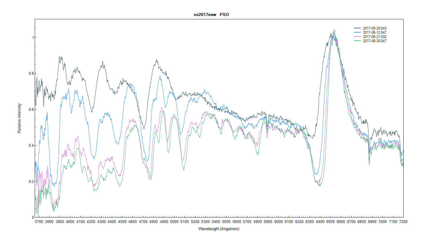

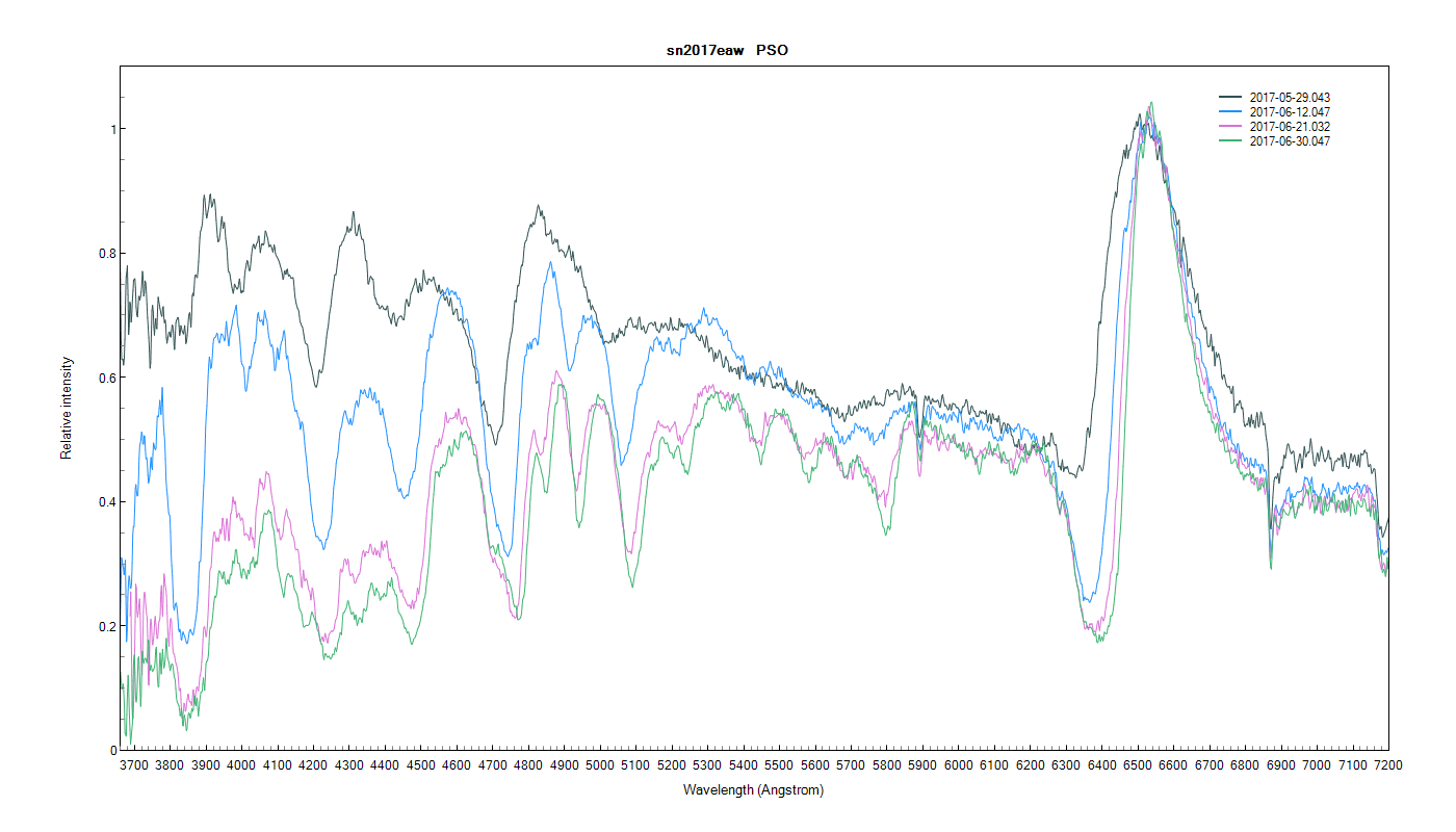

- Posts: 577
Re: Probable SN in NGC 6946
your spectra get better as time passes, despite the brightness (slight) decrease!
My last observation on June 26, compared with previous spectra (flux calibrated with simultaneous V photometry):
We can also appreciate the P-Cygni absorption RV variations, showing the photosphere that recedes to the inner and more slowly layers of expanding ejecta. To make it quicker I used my observations but I think it would be nice to use all of our spectra, plotting in a graph the velocity development.

Last week I've also made a shot (11 x 20 min - once cloud in between), but reddening seems to have settled - some absorptions in the green have become deeper: I would like to assess all RVs on a graph in the end (if manage to identify all lines), planning to shoot 1-2 weekly till possible.
- Peter
