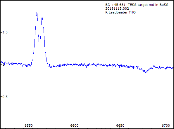

Hi Jon,
BD+45_681 7.886 B5V 44.314165 46.019957 is not listed in BeSS. It has a clear Be disc signature though. I will upload my spectra of this star to the BAA database instead
https://britastro.org/specdb/

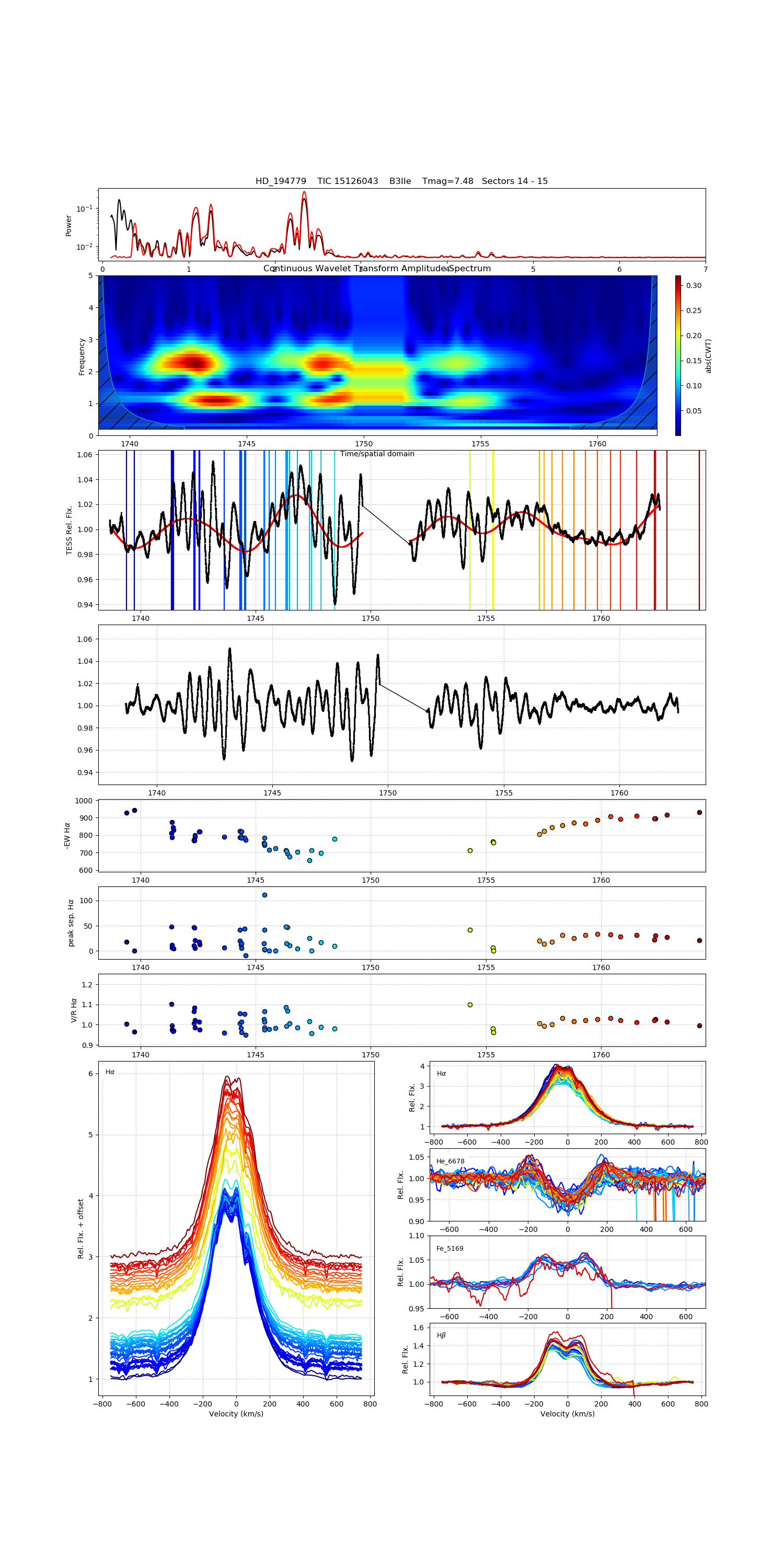

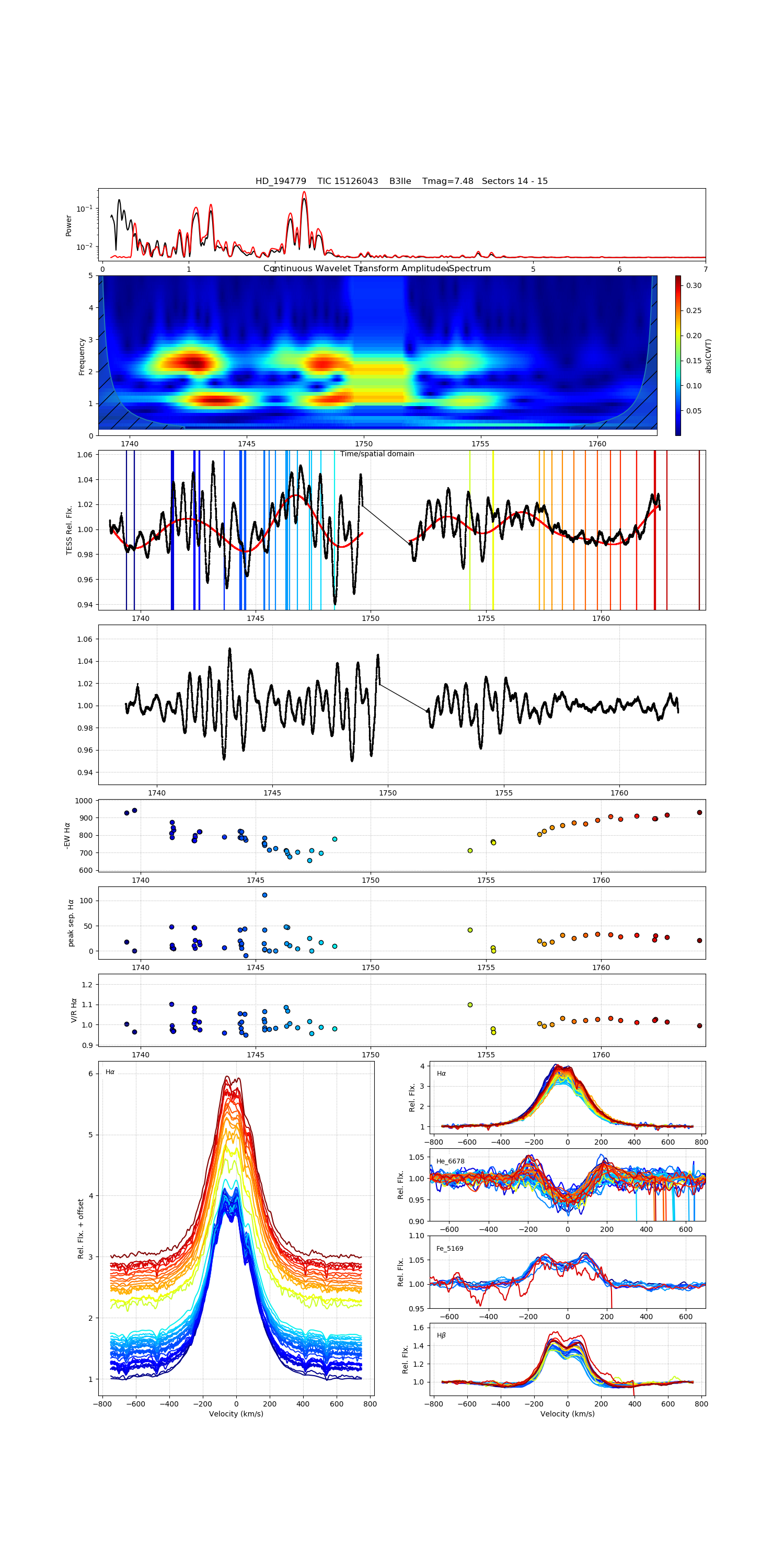

Here's an update on one of the Be stars that was being intensely monitored recently- V357 Lac. The first month of TESS data is now available (from TESS sector 16; 2019-Sep-11 to 2019-Oct-07), and there will be one more month of data coming out still from sector 17. Lots of spectra were taken simultaneously with these two sectors.
The attached plots show information from the TESS light curve and the spectra. There's a lot going on in this plot, so here is a description of each panel:
1st panel: Lomb-Scargle periodogram (y-axis log scale). This is basically the Fourier Transform of the TESS light curve. The most relevant features are that there are two frequency groups near 1.2 and 2.4 c/d. This means that sinusoidal signals with these frequencies exist in the data.
2nd: Wavelet plot. This shows how the frequencies from the top plot change over time. The two frequency groups are variable in their power. This is also clear just by looking at the TESS data.
3rd: 2-min cadence TESS light curve (black). Red: low-frequency signals showing the slower variation. The colored vertical lines are epochs of spectroscopic observations that have been submitted to BeSS.
4th: same TESS LC, but with the red curve subtracted (makes it easier to see the higher frequency signals and their changes).
5th: Halpha EW. Larger number -> more Halpha emission (relative to the continuum).
7th, 8th: ignore. These should be the peak separation and V/R values for Halpha, but they aren't being calculated correctly by my code yet.
Then the rest are some spectroscopic features when available. All the BeSS spectra cover Halpha. The big Halpha panel has time increasing upwards, with spacing scaled to the time between observations. There isn't much change in the profile of the Halpha line, but it clearly starts to decrease in strength in the first half of the dataset, then increases again. This effect is actually not caused by the Halpha emission line changing. Rather, it is the underlying continuum that is increasing, while the line emission remains relatively steady (could be increasing actually, but more work needs to be done to attempt to measure this properly).

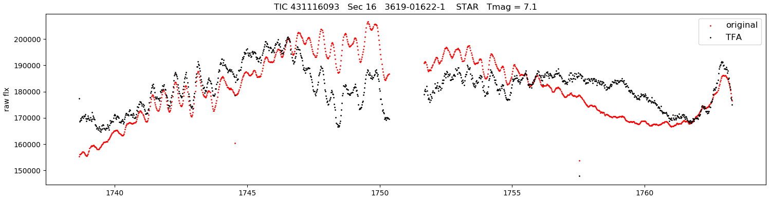

This plot shows the TESS data that I extracted from the pixels and calibrated myself. This was done because the default TESS data reduction pipeline removes long term trends in the data, because this makes it easier to find exoplanets and do things like asteroseismology. But with Be stars, we're also interested in the long-term trends. The important point of this plot is that the continuum brightness increases significantly (10-15% !), and then starts to decrease again during the first month of TESS observations. I think the red points are more reliable, but I'm still working on this part. There is a complicated convolution of astrophysical signals and instrumental signals that are difficult to disentangle properly.
Bottom line: This project seems to be going really well- excellent work! V357 Lac shows very interesting signals in its light curve, and the longer term trend is almost certainly associated with mass ejection on short timescales. The simultaneous spectra provide essential complementary information. Once the next sector of TESS Data for this star is available then a more quantitative analysis of the spectra will begin. Although the NRES telescopes had hardware problems for the first month for this star, I was able to get many spectra during the second month, which will combine nicely with the spectra submitted to BeSS. As far as I know, a dataset like this that captures mass loss on short timescales in Be stars has never existed before.
Finally, there is an almost overwhelming amount of data between all of your spectra and the TESS data. If there are any objects you are interested in checking up on (TESS data available up until Oct. 07 so far), let me know and I can send along data and plots from TESS.
-Jon

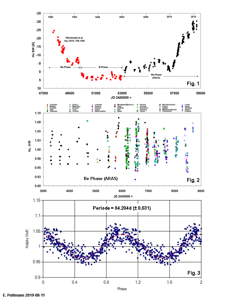

Posts: 461
Post by Ernst Pollmann »
Hi Jon,
here my monitoring of the star as collaboration with different ARAS observers.
Monitoring the Hα equivalent width (EW) and V/R of π Aqr
Hα equivalent width
As discussed in Bjorkman et al. (2002, ApJ, 573, 812), π Aqr’s previous disk likely developed in the early 1950s and persisted until December 1994. Analysis of spectroscopic data obtained after 1996, when the star was in a diskless “normal B star” phase, revealed it star has a close binary companion with a circular orbit and period of 84.1 days.
Fig. 1 indicates that the likely beginning of the disk transformation to its minimum state of pure absorption could be observed on 1995 July 15 (JD 2449914; EW = 1.1 Å). The temporal evolution of the Hα EW of π Aqr provides clear evidence of a disk-loss event from July 1995 until November 2003 (JD 2452945).
The timescale for π Aqr’s disk-loss episode (~3055 days) corresponds to 36 complete orbits of its binary companion which suggests that the companion´s orbital motion was not responsible for triggering the disk-loss episode. After the start of its minimum pure absorption state, π Aqr’s Hα EW remained until June 2004 (approx. JD 2453181). It's a nice coincidence that the ARAS EW monitoring began when π Aqr was building a new disk. As in Fig. 1, this process is going on very steeply since August 2014 (approx. JD 2456875).
Hα V/R
The recent increase of the Hα EW needs a close attention, because it might be the beginning of a large disk development, such as that in the 1950's. The fact that nothing has changed to the V/R variations yet (Fig. 2) is probably due to a slow disk re-structuring process. As more matter is added to the disk, its density structure will probably change and the density enhancement, which is moving with the period of 84.2 d (Fig. 3) in phase with the secondary companion now (Zharikov et al. 2013, A&A, 560, A30), may be modified.
What we see is that Be stars with small disks that result in a weak line emission (such that in π Aqr between 2001 and 2005) may show phase-locked V/R variations (Hα-V/R period analysis of the binary π Aqr, Pollmann, IBVS No. 6023, 2012). Be stars with larger disks (or with disks that contain more mass) and a stronger line emission show much larger periods of the V/R variations that do not match the orbital periods (examples are γ Cas, ζ Tau, 48 Lib). It is unknown what happens when a Be star disk gets larger and exhibits a stronger line emission. We suggest that the phase-locked V/R variations will not be observed anymore, but rather larger period V/R variations may develop.
However, when and whether such a transition occurs is unknown as well. If π Aqr is indeed going to increase its disk mass, then it is the right target to start getting answers to the above questions. Perhaps, there are already some data on stars that show such a transition between different periods, but π Aqr is in transition right now and a dense monitoring is very valuable.

Thanks Ernst! That's a really nice dataset and presentation of the history of this system.

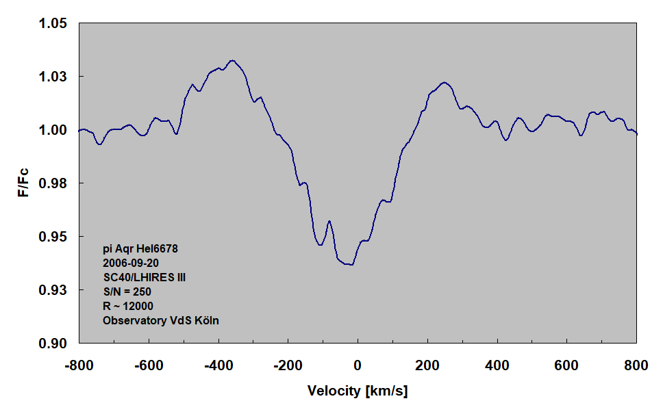

Unfortunately I can contribute spectra only after July (perhaps August) because of the beginning of the visibility of the star only during the early morning hours when the sky will be dark enough at my observatory.
But I am familiar with the spectral range of HeI6678 to achieve a reasonable S/N at acceptable integration times, because of my delta Sco observations within this spectral range. Attached you can see a pi Aqr spectrum from September 2006 as an example.
Ernst

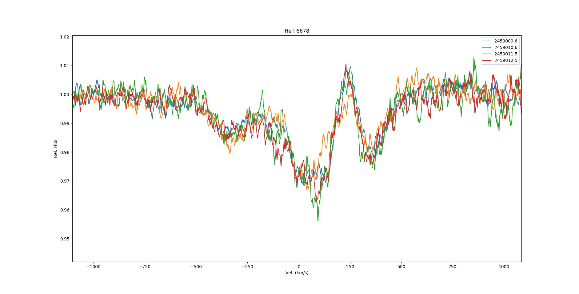

I see now that since Pi Aqr is only visible at the end of the night this presents an extra challenge that I hadn't appreciated. Still, since the BRITE satellite is observing the star for the next many months (until approximately November 2020), spectra taken in July and later are still quite valuable.
Your He 6678 line looks great- that's exactly the sort of data that will be useful to probe the inner disk as the star is ejecting mass, and in combination from the BRITE photometry will help in disentangling the origin of certain signals (photospheric vs. circumstellar). I actually find it interesting that the September 2006 snapshot is quite different from the He 6678 line today (or rather, over the last 4 nights).

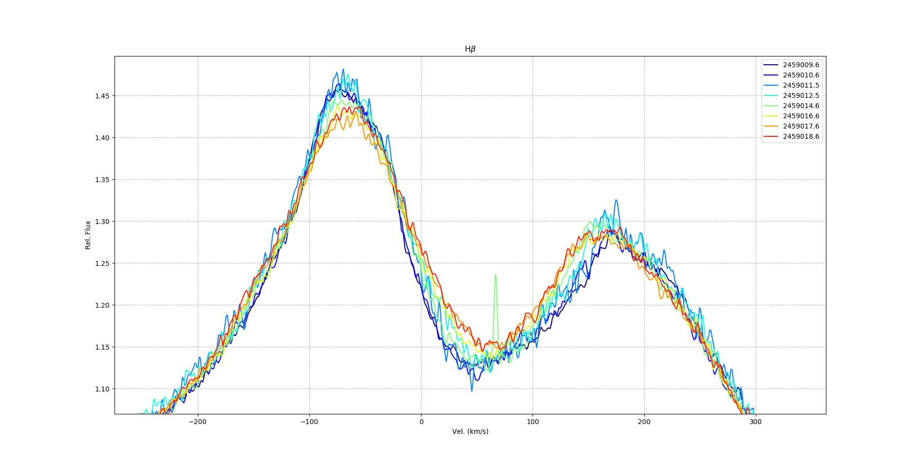

J Labadie Bartz
Posts: 46
Joined: Mon Aug 26, 2019 5:12 pm
Post by J Labadie Bartz »

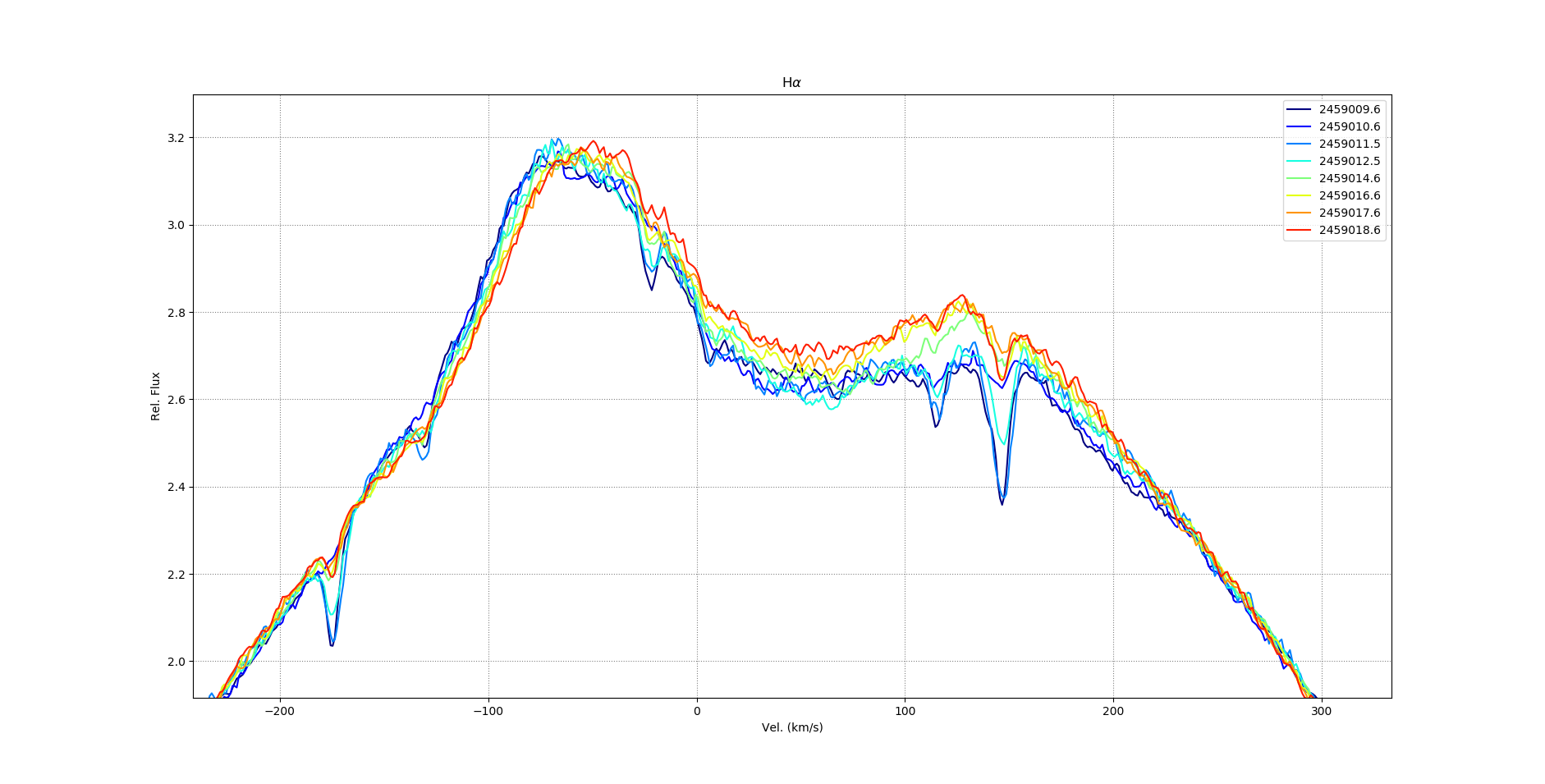

This may come as no surprise to anyone who has been studying Pi Aqr for a while, but over the last 10 days it's been interesting to watch the Hydrogen alpha and beta lines shift their peaks. Just thought it was neat to see this (presumably) rotating disk structure in real time over just ~1/10th of the orbit, and will be really nice when quantitative measurements like peak separation and V/R are made.
Posts: 461
Hi Jon,
unfortunately, most of the Echelle spectra in BeSS only show the area around HeI6678 very incompletely, so that they can often not be used.
That is unfortunate, although I had pointed this out once, but nothing has changed.
Best wishes,
