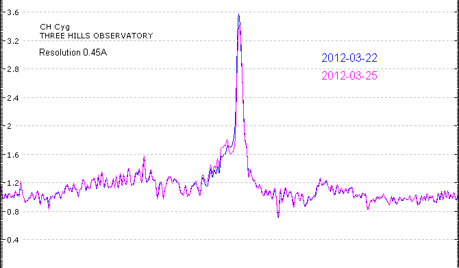

A comparison of CH Cyg H alpha on 22nd and 25th March. Conditions were very poor last night so I kept the single exposures at 600s

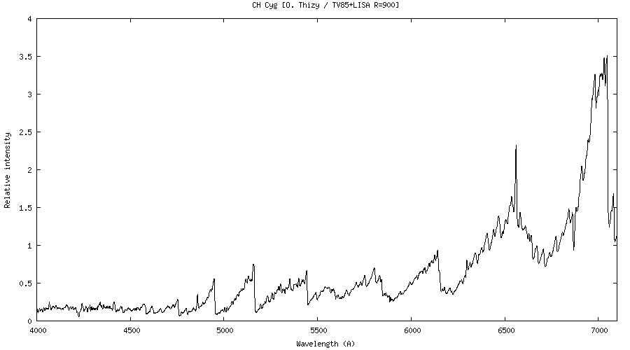

Re: AAVSO Alert Notice 454: Monitoring of CH Cyg requested
Post by Olivier Thizy »
here is an observation of CH Cygni taken last night (march 26, 2012; OHP observatory).
Not sure of the scientific interest as R~900... but it was fun to take! :-)
CH Cygni
CH Cygni
Televue 85mm F/7 + LISA spectrograph (Atik 314L+ camera); 1h exposure with very good seeing.
Olivier
