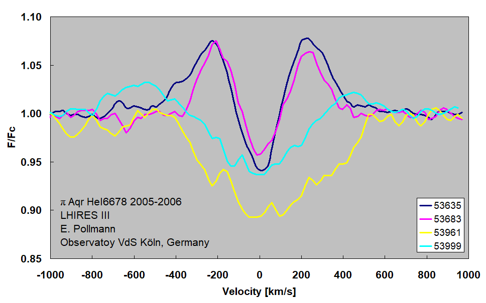

The HeI6678 line seems to be an appopriate indicator for studying the disk development and dynamic during a very early state close to the surface of the primary.
In that sense I just drawed for this line profile during 2005-2006 the attached velocity behavior which shows the drastic velocity decrease if developed Helium gas is transfered in to a ring with increasing distance from the photosphere.

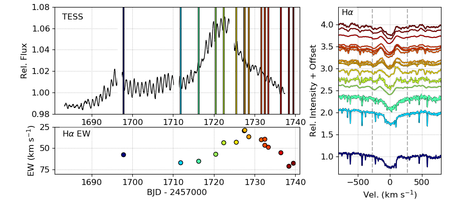

For fun, I re-reduced the TESS data for a nice target that was observed by nine observers (Charbonnel, Buil, Berardi, Lester, MAETZ, Leadbeater, Bryssinck, GARDE, and HOUPERT) plus a few NRES observations from myself over the TESS baseline. I think this is an excellent example of a short outburst seen in phot. + spec. that really highlights the power of this observing network.

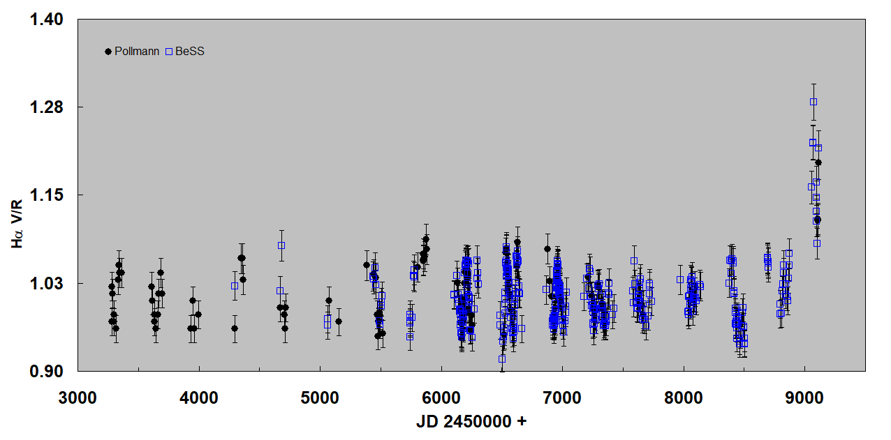

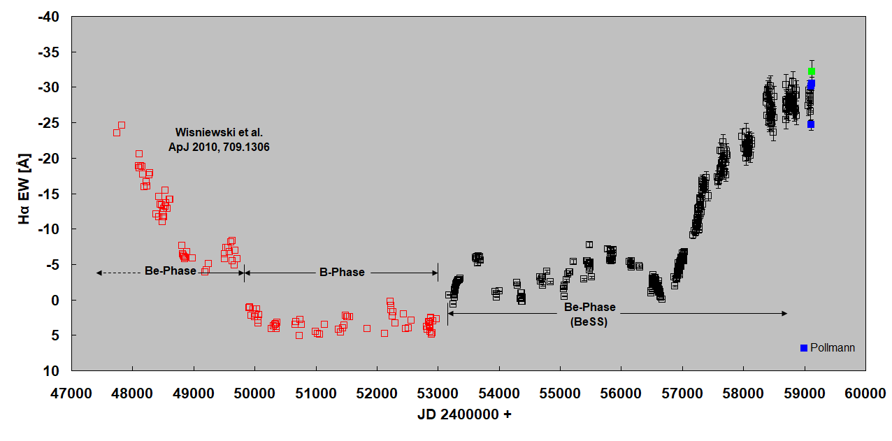

don´t forget to take into account the AAVSO spectra of pi Aqr.

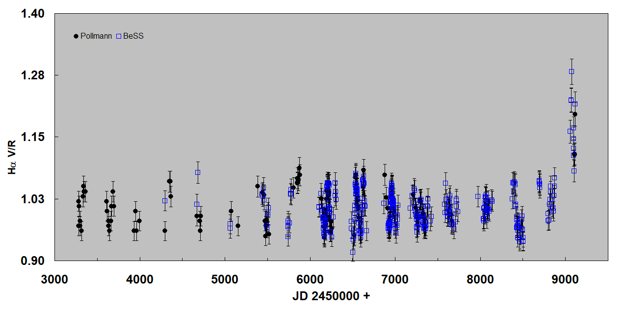

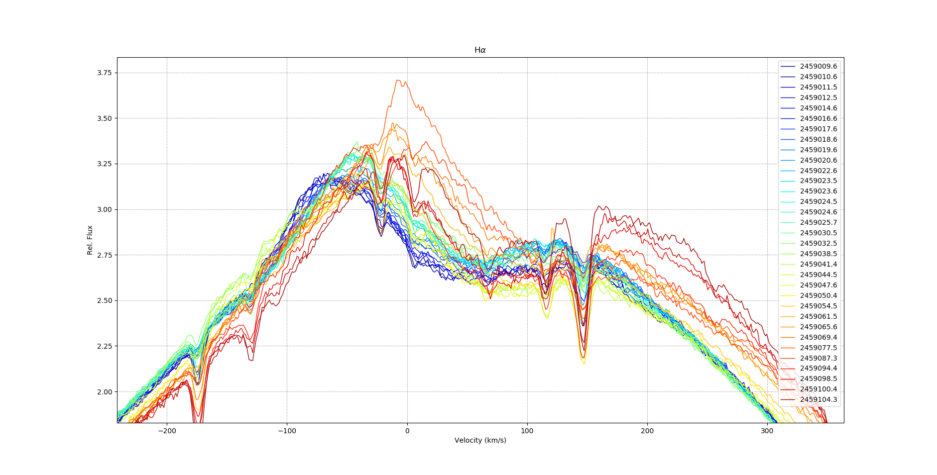

Here the current state of the EW and V/R monitoring:
Best wishes,
Ernst
J Labadie Bartz
Posts: 46
Joined: Mon Aug 26, 2019 5:12 pm
Post by J Labadie Bartz »
Hi Ernst,

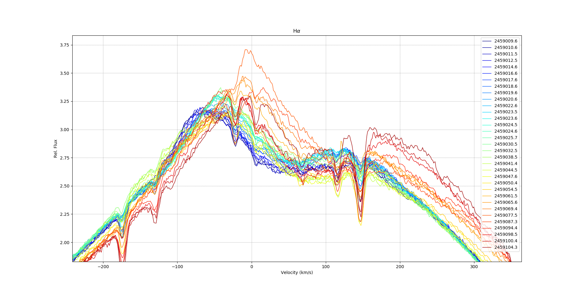

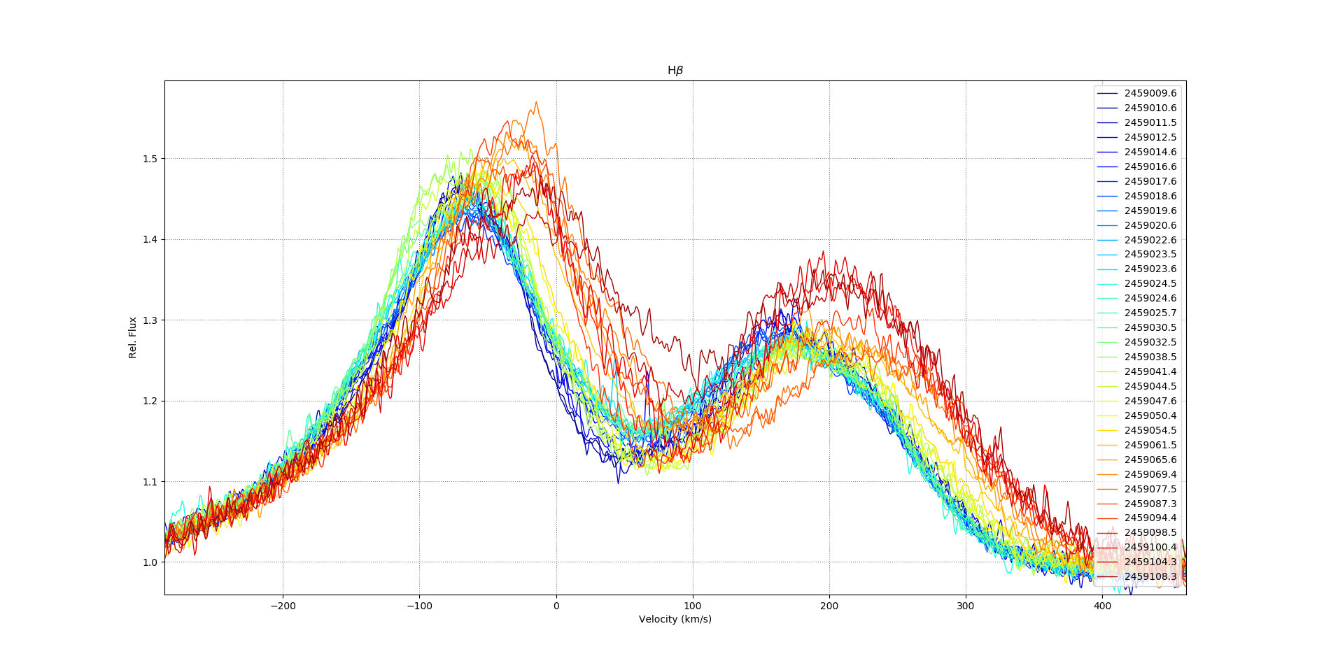

Thanks for these plots. I was aware of the recent (over the past many years) evolution of the Ha EW (thanks to similar plots that you have shared), but the more recent and dramatic evolution of the Ha V/R variation is news to me and is definitely interesting. I've talked about some observing programs to monitor Pi Aqr recently (on here and the spectro-l mailing list), and I've been getting regular NRES spectra over the past ~100 days (and am continuing these observations), plus we have been getting nightly (weather permitting) sequences of polarimetry data in Brazil over the past month. The ~80d V/R variability from the binary orbit looks clear in your V/R plot, and the recent larger-amplitude trend of V > R is something I've also noticed being NOT phase locked to the binary orbit (rather its evolution is much slower). Having this historical dataset that you show adds some nice context to this new behavior.
Although I only show the peaks in the plots here, the wings have become wider over the past 100 days, suggesting the density of the inner disk is continuing to grow. Note that the overall red-ward shift of these lines is not real- I still must properly apply a heliocentric correction to the NRES data.
