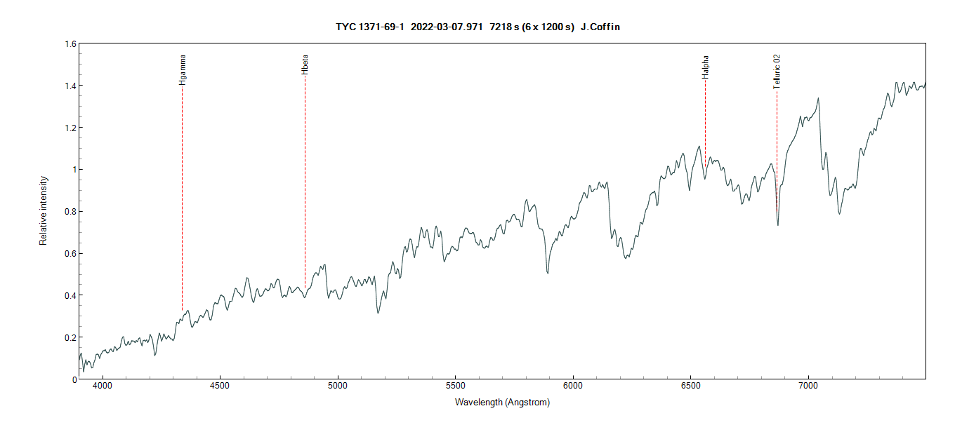

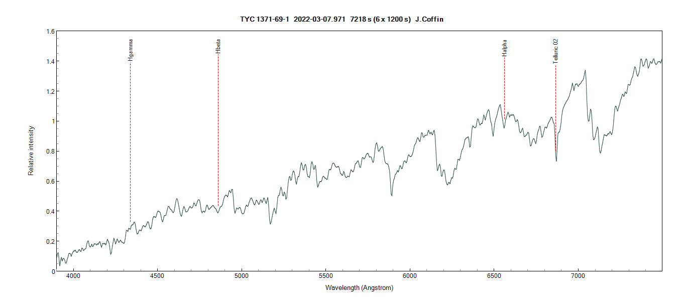

Here is a spectrum of TYC 1371-69-1 from last night using an Alpy 600, Celestron 8 SCT, 1200s x 6. I can't see any Balmer lines in emission.
This is the field of view.
TYC 1371-69-1.jpg (88.54 KiB) Viewed 20191 times

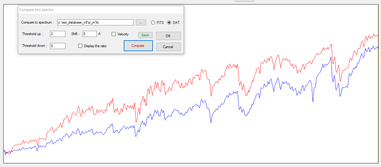

This compares the spectrum with the Pickles reference spectrum for M 1 III. It looks a reasonable match.
