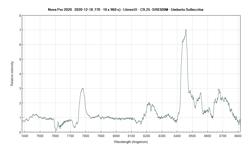

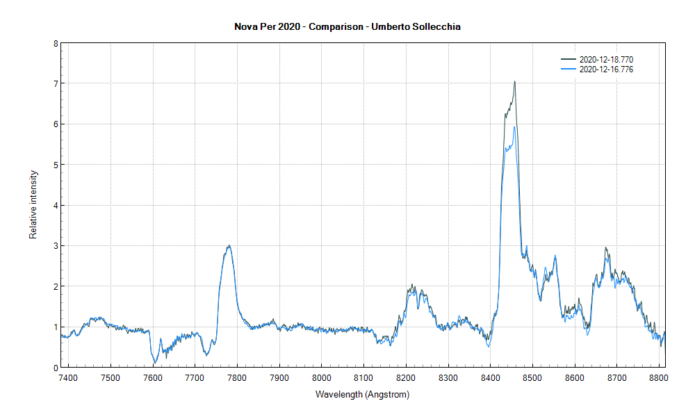

Bonsoir à tous, le profil de cette soirée 18/12/2020 et une comparaison avec la journée 16-12-2020 où une augmentation de l'OI-8446A est évidente. Un filtre rouge a été interposé.
Umberto Solllecchia
novaper2020_20201218_770_Umberto Sollecchia.png (39.39 KiB) Viewed 11363 times
u]Comparison[/u]
novaper2020_20201218_770_Comparazione -Umberto Sollecchia.png (52.57 KiB) Viewed 11363 times

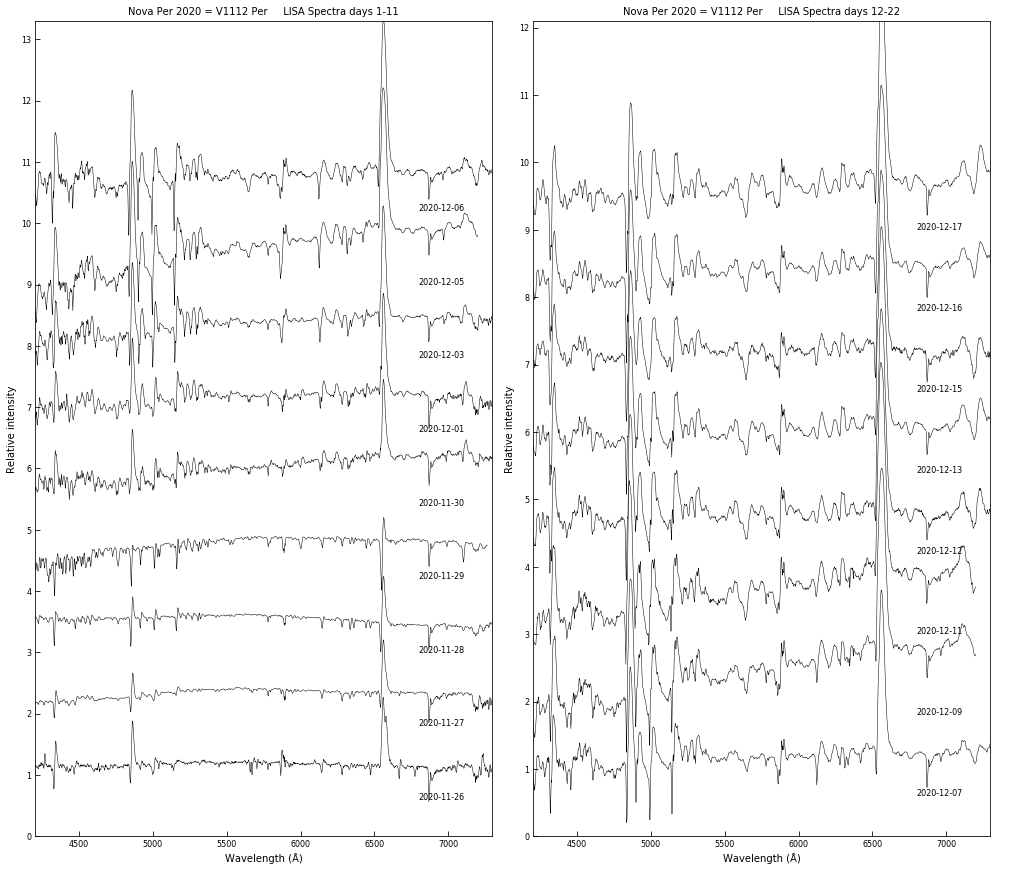

Here are two composite plots of spectra of Nova Per 2020 taken by ARAS observers using LISA spectroscopes which show its evolution during the 3 weeks since discovery. All spectra have been normalised to unity at 5500A, log-scaled and equally displaced vertically.
Spectra days 1-21.png (193.45 KiB) Viewed 11323 times
Rainer Ehlert
Posts: 135
Post by Rainer Ehlert »
Hi David,
Very interesting to see how it changed in the starting days and then more or less stabilized.
Thank you.

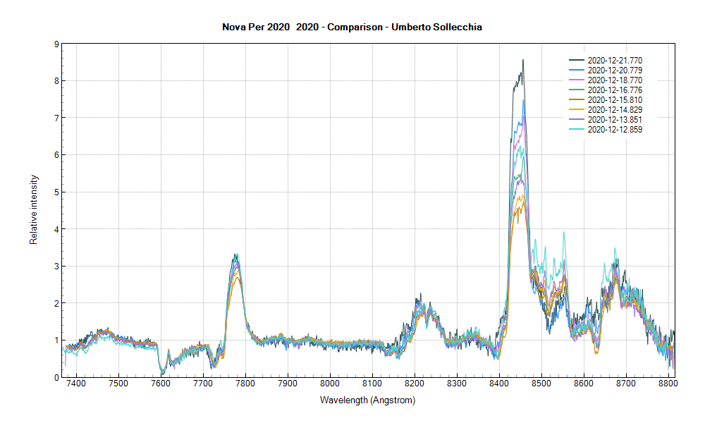

Bonsoir à tous. J'ai placé une comparaison séquentielle de mes observations dans l'IR
Umberto.
novaper2020_20201221_770_ Comparison -Umberto Sollecchia.png (103.77 KiB) Viewed 11289 times

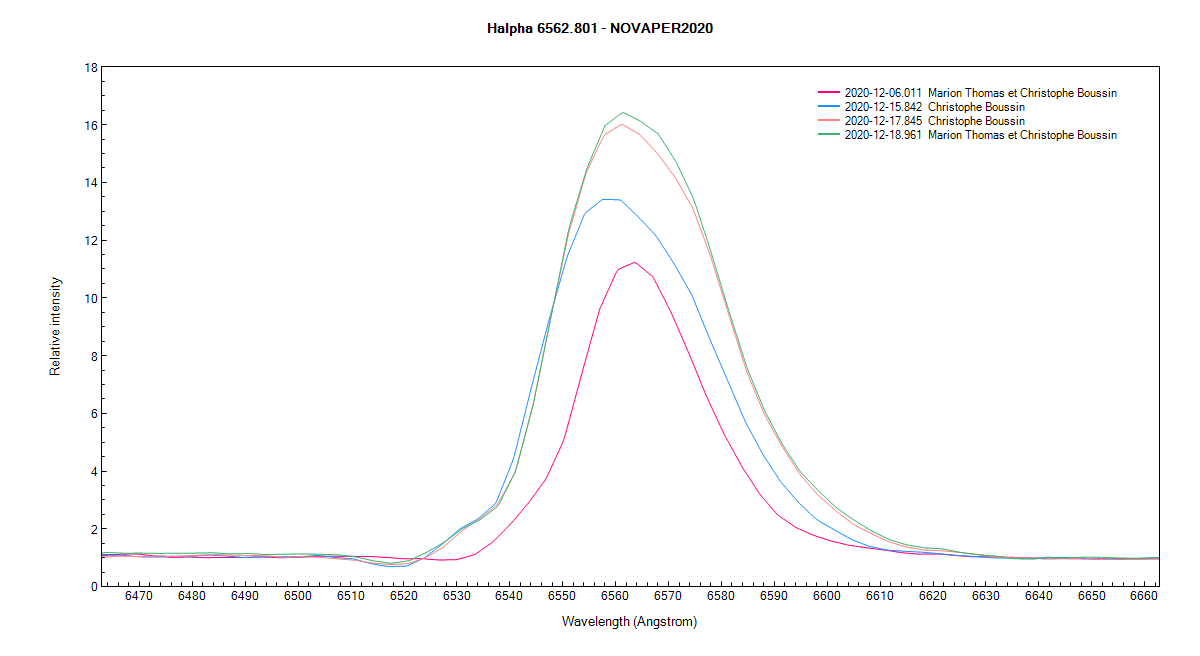

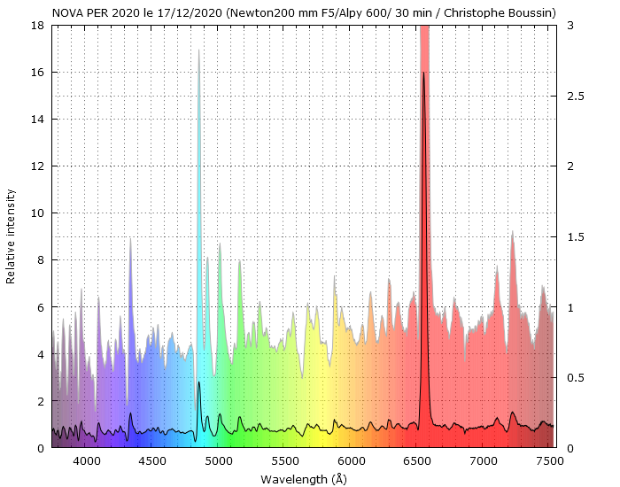

A few nights with a clear sky allowed us to obtain the following spectra of the Nova Per 2020 with an Alpy 600.
The 17th of December at 20 h 17 TU (resolution of 520, JJ = 2459201.3451 and an acquisition time of 30 min) :
Nova Per 2020 on December 17th, 2020
_novaper2020_20201217_845_Christophe Boussin_3750_7540.png (80.38 KiB) Viewed 11263 times

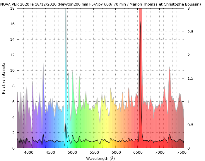

The 18th of December at 23 h 04 TU (resolution of 521, JJ = 2459202.461 and an acquisition time of 70 min) :
Nova Per 2020 on December 18th, 2020
_novaper2020_20201218_961_Marion Thomas et Christophe Boussin_3750_7565.png (86.82 KiB) Viewed 11263 times

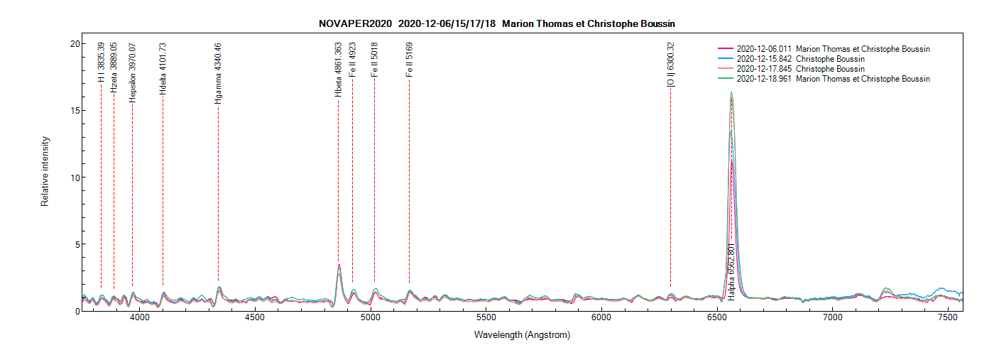

Nova Per 2020 on December 6th, 15th, 17th and 18th, 2020 (identification of some lines from PlotSpectra).
The relative intensities of the FeII lines as well as that of the [OI] line at 6300 A seem to have increased slightly in a few days...

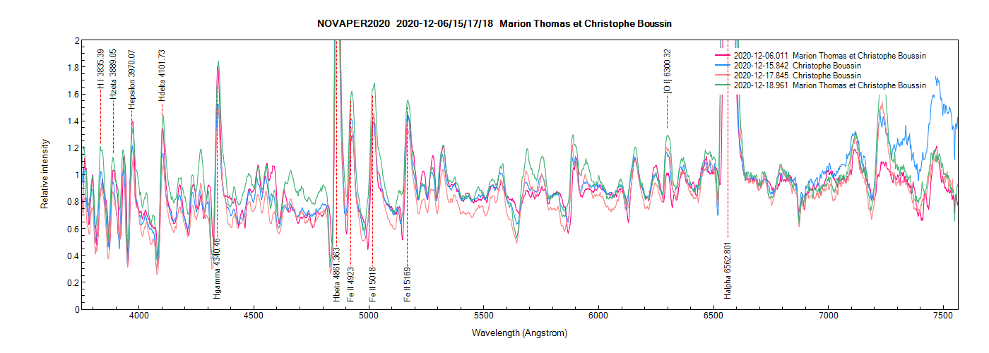

Nova Per 2020 on December 6th, 15th, 17th and 18th, 2020 (zoom).
...and the relative intensity of the Halpha line continues to increase :
Nova Per 2020 on December 6th, 15th, 17th and 18th, 2020 (Halpha).
novaper2020_20201218_961_Marion Thomas et Christophe Boussin_Halpha.png (46.63 KiB) Viewed 11263 times
Clear skies,
Marion THOMAS et Christophe BOUSSIN

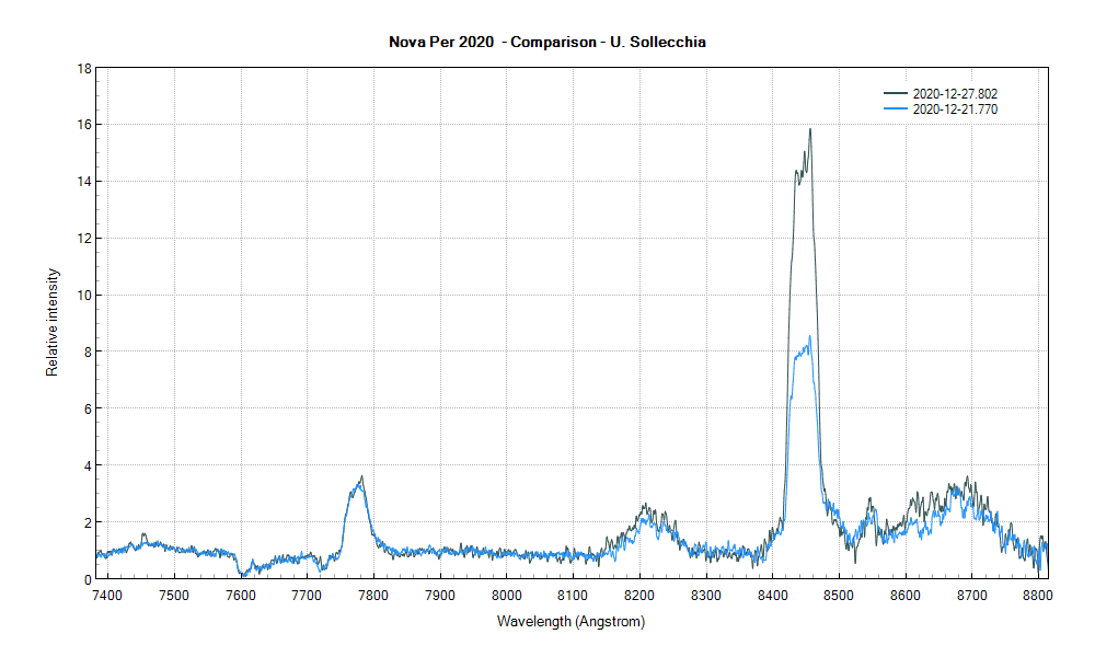

Bonjour à tous, la nova va au repos. L'augmentation de l'intensité du CaII 8446A se poursuit.
Voici une comparaison entre le 21-12-2020 et le 27-12-2020.
Umberto Sollecchia
novaper2020_Comparison_Umberto Sollecchia.png (52.39 KiB) Viewed 11132 times

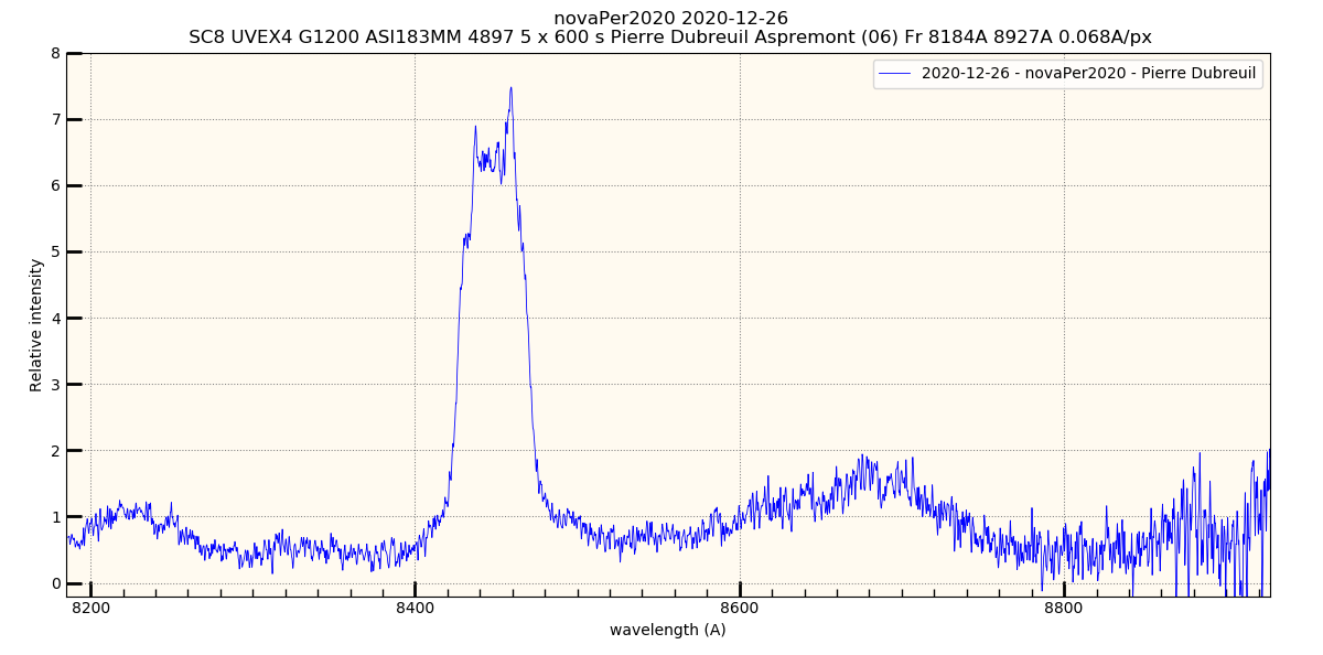

Posts: 207
Post by Dubreuil Pierre »
Bonjour Umberto
Super suivi de cette Nova.
Quelle est la configuration du materiel employé ?
Le 26/12 lors d'essais avec UVEX(4) j'ai choisi le champs autour du CA II.
La Nova etait une cible.
2
NovaPer2020  le 16/16/2020
NovaPer2020 UVEX(4) 8185A to 8927A.png (111.68 KiB) Viewed 11097 times

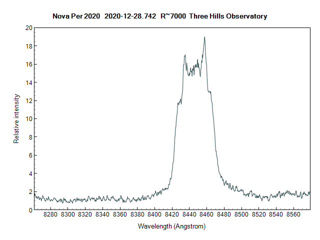

Aspremont 06 (fr)
The OI 8446 line at R~7000 (LHIRES 1200)
