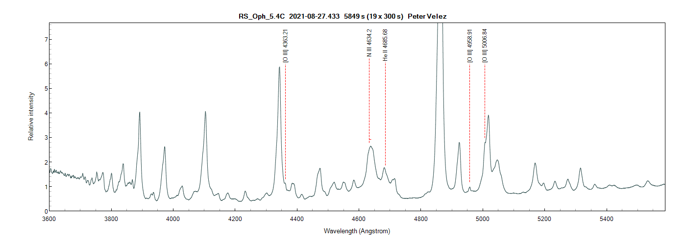

Another RS Oph - taken last night.
I have marked the features that Francois has highlighted as well as [OIII] noted in Steve Shore's recent ATel.
Pete

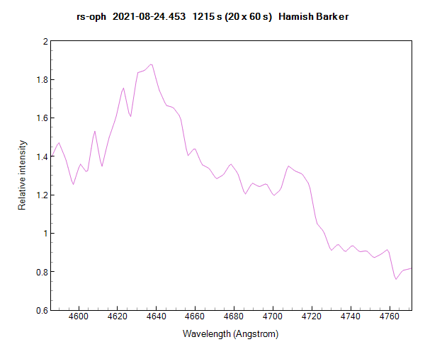

not sure if my spectrum does show the bump at 4685 on 2021-08-24.5 (perhaps wavelength calibration needs fixing?) or it could be noise.
rs-oph_20210824_453_Hamish Barker-zoom4685.png (15.67 KiB) Viewed 19610 times

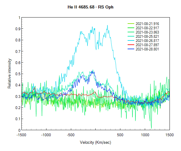

And a short fading of He II wich almost desappared during one day.
This behavior of He II was totally unforseen (and not detected during former outburst) and very strange in the current.
This fading was so surprising/understadable that we use low resolution in order to verify.
It has been established thanks to high cadency, daily monitoring of the 2021 outburst.
A great moment!
ARAS Group monitoring of RS Oph 2021: Rapid profile variations of He II detected

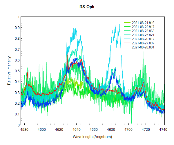

In the last two days the He II 4686,5411A lines have dramatically altered in both strength and profile, detected with optical grating and echelle spectra (observers and nstruments are available at the ARAS Database website). As reported in ATel#14881, on Aug. 25.8 both lines were present with roughly symmetric profiles and |vrad,max| ~ -1100 km/s. On Aug. 26.8 the profiles were similar but about 1/2 the previous normalized flux. The profile now, Aug. 28.8, has < 1/10 the relative intensity and virtually no emission associated with the component centered at +270 km/s (+10 < vrad < 1300 km/s). Notably, the fine structure peaks on all He I profiles at around -240 km/s and -20 km/s are also present on He II and its blue wing extends to vrad ~ -1200 km/s, like He I (the wing of Hbeta extends to -2200 km/s). In this same time period, the O I 7772 A component shows emission confined to the same velocity interval as the He II emission deficit, although O I 8446 A shows a similar profile to the other permitted lines, including e.g., Fe II 5018, 5169 A. Although weakened in relative flux, N III 4636 has otherwise not changed from our previous observations. The only significant structural change is in the ionized He profiles. We urge continued, high cadence spectroscopic monitoring; all spectra described here are available through the ARAS database.
The evolution of He II from echelle spectra secured by Joan Guarro and François Teyssier
Rise, fading (red) and recovery (blue)

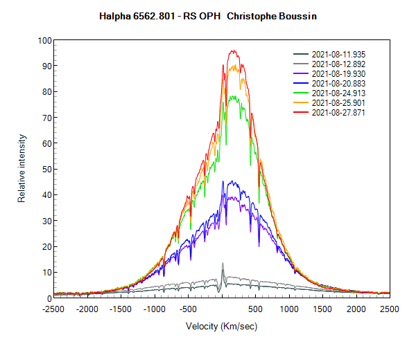

Here is my comparison between my last spectrum of the Halpha line of RS Oph at high resolution on August 27 at 20 h 54 TU (resolution of 18249, JJ = 2459454.3706, acquisition time of 60 min (6 x 600s)) obtained with my LHIRES III (grating of 2400 lines / mm) and the previous ones.
Halpha line of RS Oph on August 11th, 12th, 19th, 20th, 24th, 25th and 27th 2021
rsoph_20210811_12_19_20_24_25_27_Halpha_Christophe Boussin.png (48.41 KiB) Viewed 19528 times
Clear skies to all !!

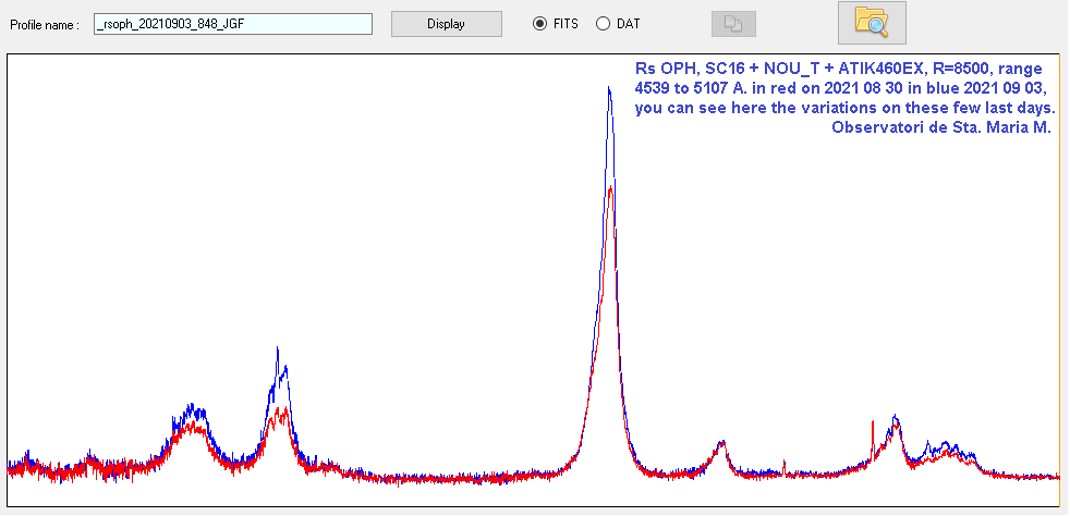

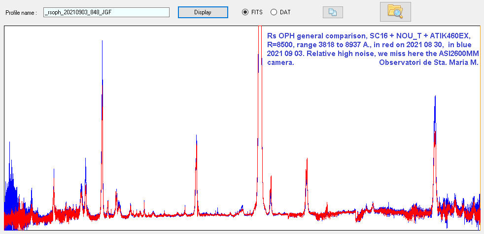

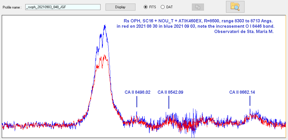

That are some changes on RS Oph graphics on 4 days.
Regards, J. Guarro.

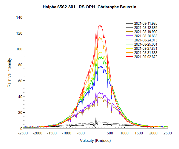

Here is my new comparison between my two last spectra of the Halpha line of RS Oph at high resolution on August 31 at 20 h 42 TU (resolution of 19094, JJ = 2459458.3626, acquisition time of 50 min (5 x 600s)) and on September 2 at 20 h 56 TU (resolution of 19069, JJ = 2459460.3721, acquisition time of 30 min (3 x 600s)) obtained with my LHIRES III (grating of 2400 lines / mm) and the previous ones.
Halpha line of RS Oph on August 11th, 12th, 19th, 20th, 24th, 25th, 27th, 31th and on September 2nd 2021
rsoph_20210902_Halpha_Christophe Boussin.png (50.78 KiB) Viewed 19312 times
