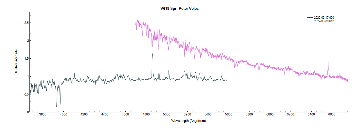

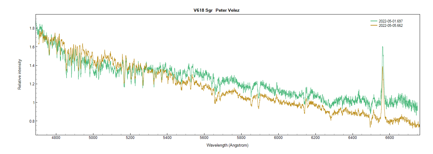

V618 Sgr is certainly a fascinating target at the moment.
I've been keeping an eye on it of late. I adjusted the grating angle for the UVEX from the Hb - Ha range to the UV/Blue this week. Here is a comparison between 9 and 17 May 2022. Disregard the continuum as my reference star was not well selected. What is clear is the way the emissions have popped in the space of a week.
Also attached is spectra taken on 1 and 5 May 2022 - there is no sign of emission apart from Ha.
Pete
Pete

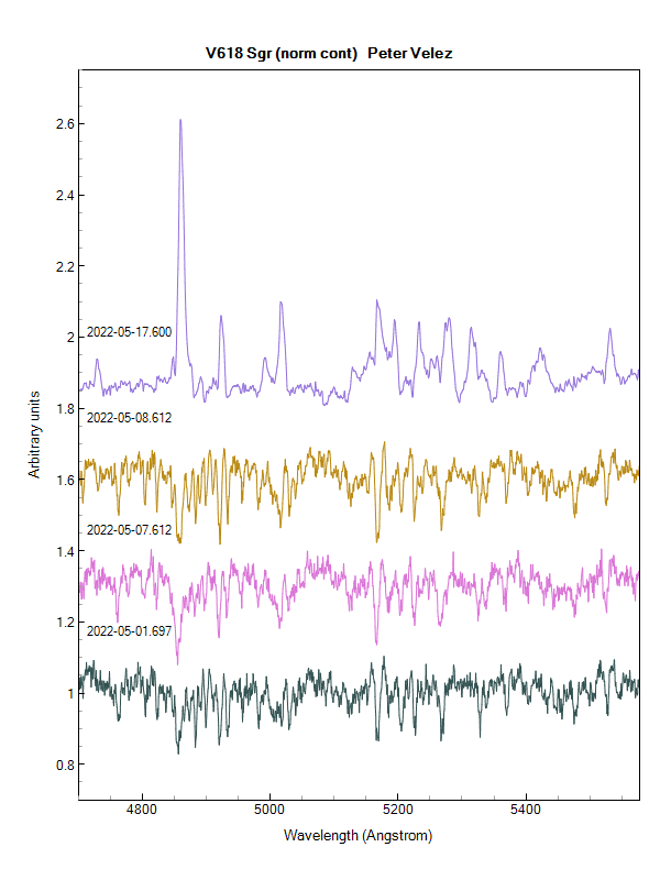

I continue to wrestle with getting the continuum correct in my spectra. The below graph gives a better view of the evolution of V618 Sgr. These are spectra taken on 1, 7, 8 and 17 May 2022. All have been normalised to their continuum so they are directly comparable. I have limited the graph to the region that overlaps between the spectra.
I'm pleased the 2Spot guys produced a similar result - I was concerned that I might have imaged the wrong star at first!
Pete
Pete
