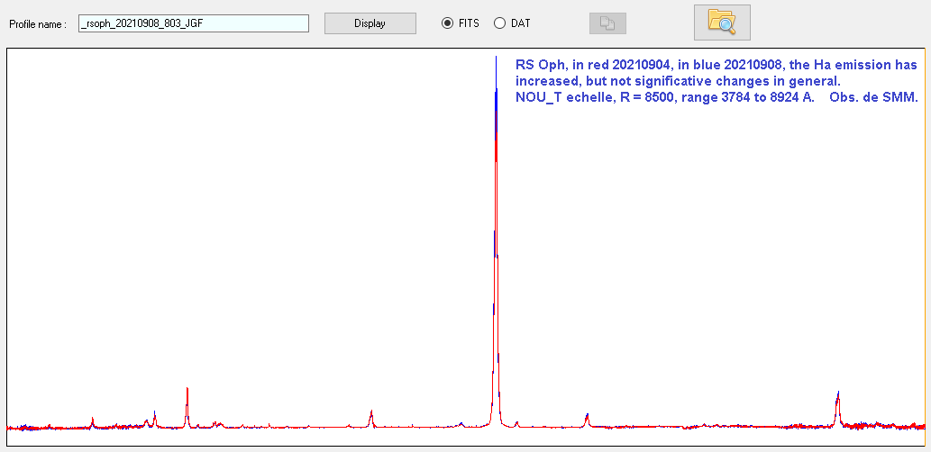

- Posts: 722
Nice presentation François !
About you and Steve's speeches I have understood the role that the echelle spectrographs play, it seems that is important. So it seems that we need some more of them, although low resolution ones are really a good support. Am I wrong ?
That is RS Oph last night.
Amitiés, Joan.
Amitiés, Joan.
- rs oph com.png (14.63 KiB) Viewed 20298 times

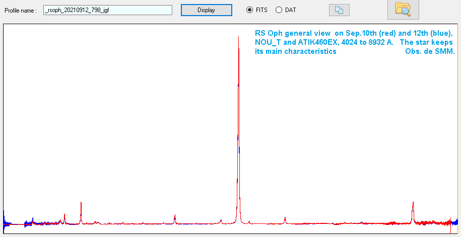

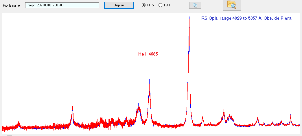

- Posts: 722
Piera was cloudy these last few days, so I have observed with the remote SMM equipement, with a mediocre Thorlabs echelle grating and a ATIK460EX. That are the outcomes, you can see the RS Oph ones.
Cheers, J. Guarro.
Cheers, J. Guarro.
- RSOPH1.png (13.77 KiB) Viewed 20239 times
- RSOPH2.png (15.39 KiB) Viewed 20239 times

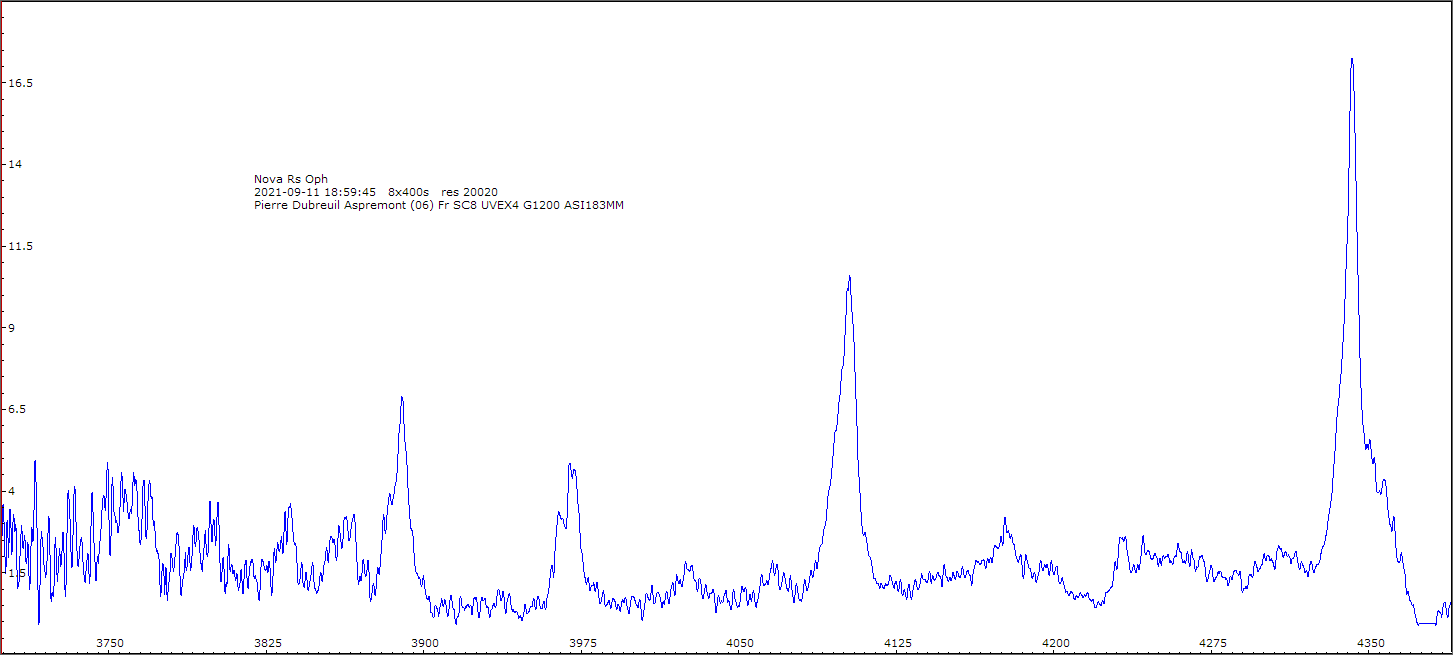

- Posts: 206
Nova Rs Oph proche UV hier soir le 11/09/2021
UVEX(4) fente claire 25µ G1200

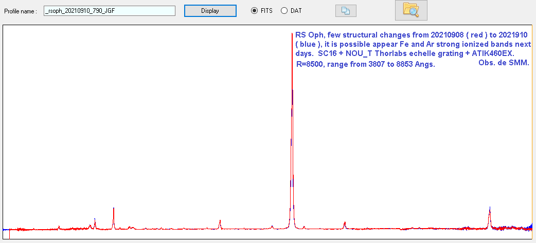

- Posts: 722
There are not appreciable changes these two last days in RS Oph.
Cheers, J.Guarro.
Cheers, J.Guarro.
- rsoph20213.png (13.67 KiB) Viewed 20137 times
Animation covering 2021-08-25 to 2021-09-11 showing the emerging [FeX] line
A new line has appeared at 5303A between 20210911 and 20210919
