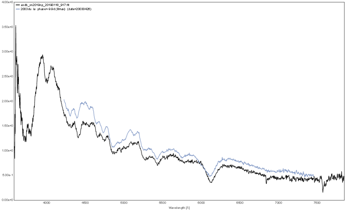

Last night's result (300/1200 Newton, Alpy 600, 18 micron slit, ATIK 414 EXm, 8 x 1800 sec, 2019.01.18,917, R~670), using Gelato's comparison graph (gelato.tng.iac.es):
The moon was high and had to subtract lots of background (30 min exposures at -20C), but the features matching very well.
There is only some shift in the H-alpha absorption .
This SN is reported now at 13.7 mag (http://www.rochesterastronomy.org/snimages/), but since no obvious emission, had to produce good SNR at continuum level.
The weather was good, but I was rather unsure when the clouds will come. Nevertheless, taken ref.stars 3 times (HD89744) as IR and response, so the response calibration quality should be good.
Gelato says 100% SN Ia match, and enlists outstanding confidence with SN2003du (phase: -9.9d).
I believe that my extra UV end here is real (except the last 1-2 pixels cutoff).
Happy hunting!
PS: attaching the zip
asdb_sn2019np_20190118_917.zip
(9.76 KiB) Downloaded 968 times

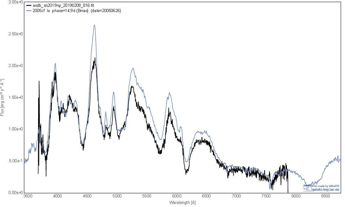

Last night's result, 13.7 mag, 3 x 1800 sec:
The are many match possibilities (seems the SN IA is more common), but the phase=14.9d is realistic.
The object was low a bit, with some fog present.
asdb_sn2019np_20190208_816.zip
(9.49 KiB) Downloaded 1059 times
