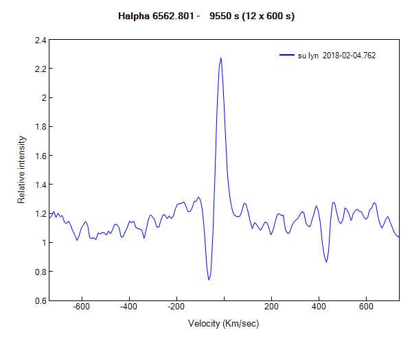

H alpha range
Ha in RV

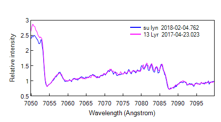

James,
He I 7065 range : no line
For line identification, you have to consider the emission spectrum as a all.
He I 7065 appears with He I 5876 (triplets) and also He I 6678.
No He I in emission in SU Lyn

Posts: 457
Re: SU Lyn Call for observations by Katarzyna Drozd
Thanks for the feedback and Nice results Francois!
Here are my SU Lyn spectra results shot in Ha, Hb, He5885/Na doublet, & CaK bands (2-5Feb2018):
Is the star M5III 13 Lyr in Miles/Edoline database or did you use it as your IRC star by shooting 13 Lyr just before dawn?
The line identification for NeIII for the CaK round 3866A is tentative I used Plotspectra's option and that NeIII line on the annotation list
looked like a match. I'll look for that other NeIII line you mentioned.
