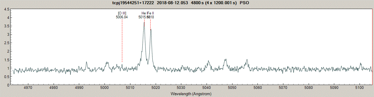

Hi Peter, all,
yesterday I also observed the symbiotic with Lhires III and 600 l/mm grating.
The detail around He I 5016 (unresolved pair with Fe II 5018) seems a little different than your. The signal is poor but feel like there is something near the oxygen line wavelength. To be explored...
