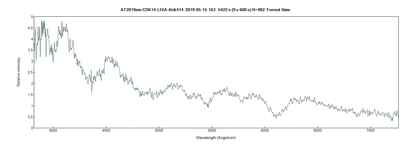

Here is my contribution on AT2019ein taking 9 600sec exposures using my Shelyak LISA with 23 micron slit. Amazingly, guiding was really good using the target star on the slit. I smoothed the data slightly using a filter value of 1.5.
Woody

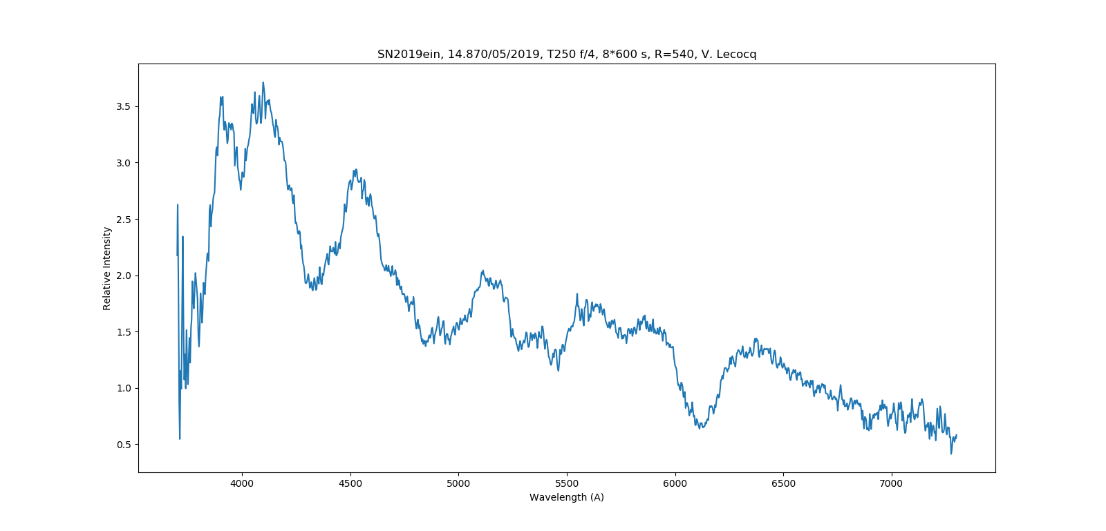

Post by Vincent Lecocq »
hello,
here's also my modest contribution to this event. Low resolution spectrum (Alpy600, CCD Atik 414 sur un Newton D=250 f/4) taken yesterday, with a very present moon (but clear skies heavenly !!),
Vincent

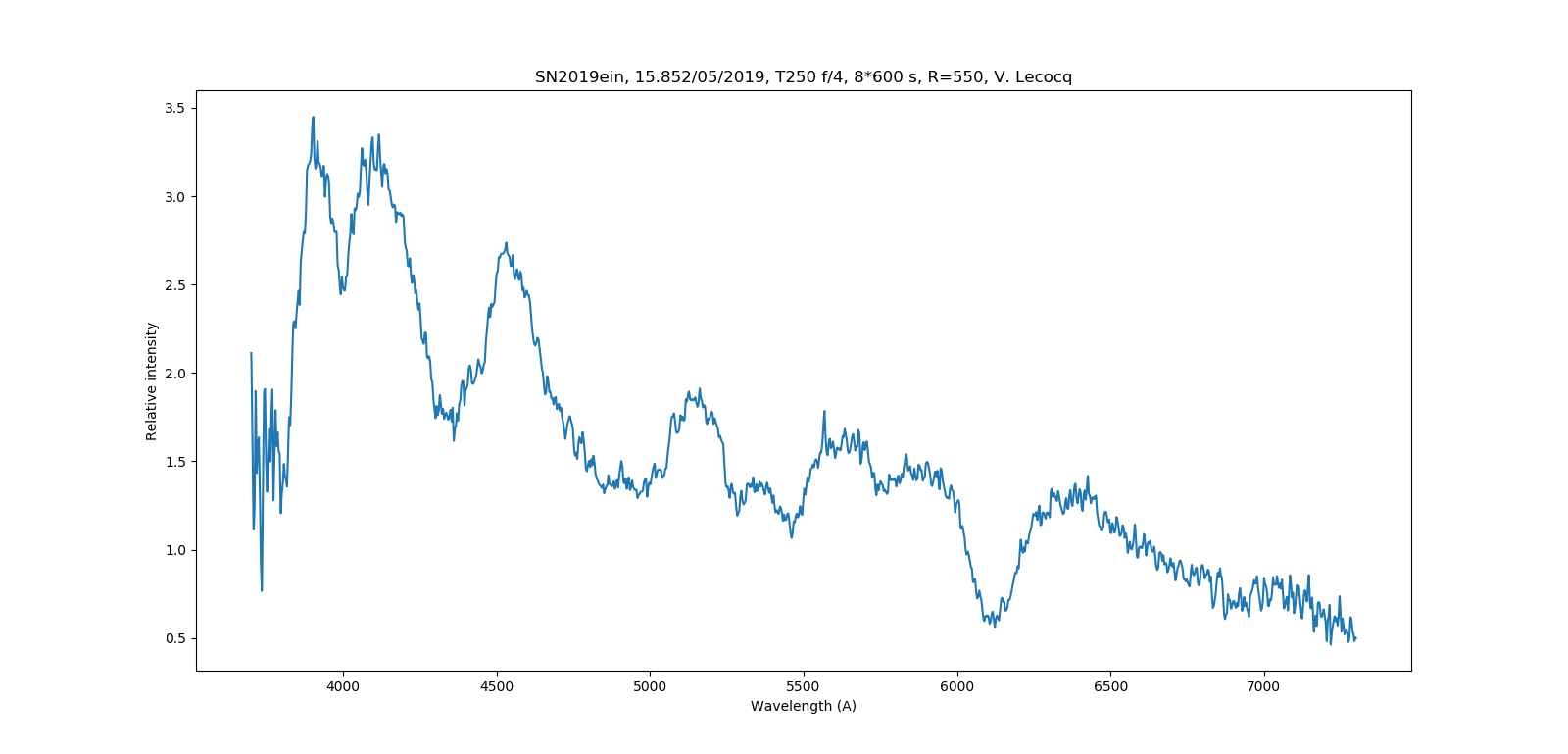

and here it is for yesterday's night ... still very present moon of course, but last chance of good weather for somedays ... .
