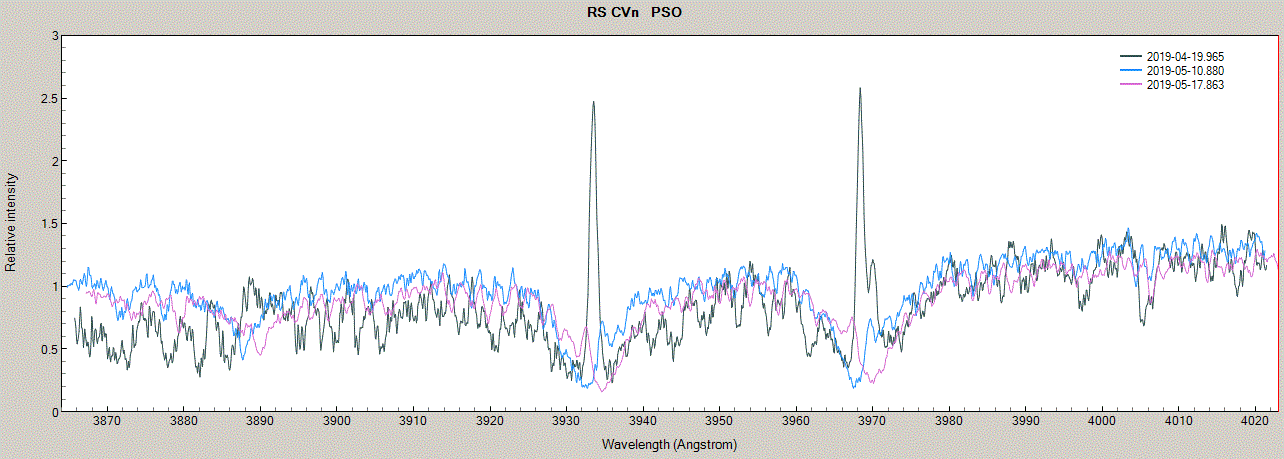

I've sent you 2 nights (2019.05.10, 05.17 + RS CVn: also on 2019.04.19) of 4 program stars (RS CVn = HD 114519, HD115404, Ksi Boo = HD 131156, Sig CrB = HD 146361).
Out of these 4 targets, RS CVn is showing an always different profile - like shooting different stars:
For the other stars, I cannot see much change (continuum slope varies somewhat - should be the choice and manual handling of reference star).
I am suprised to see the S-index being used for RS CVn - browsing through the articles for RS CVn referred to by Simbad (at least 3 I could find), the CaII + Heps emissions are measured in either EWs or fluxes (with different continuum subtraction techniques - either approximated or using a real or reconstruced templace star).
Hope we can continue the exploration and learn further!

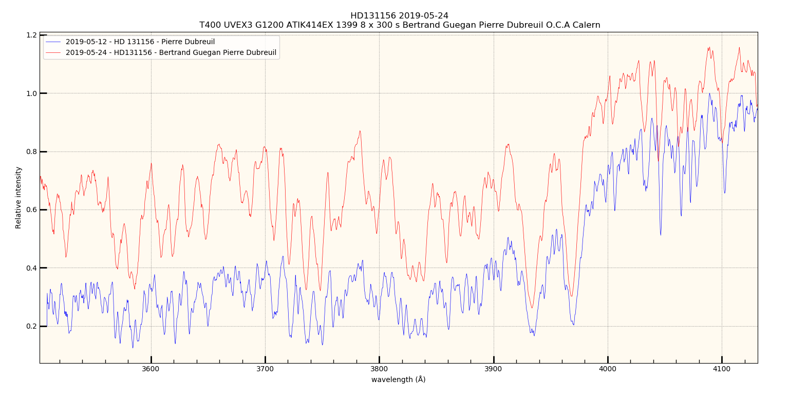

Actuellement en mission NP sur le C2PU Calern, nous profitons aussi du T400 amateur pour utiliser UVEX(3) .
actuellement avec reseau 1200 et fente 25microns.
Ci-dessous comparaison d'un spectre T400 et une précédente acquisition avec C8.
a suivre
Pierre et Bertrand
