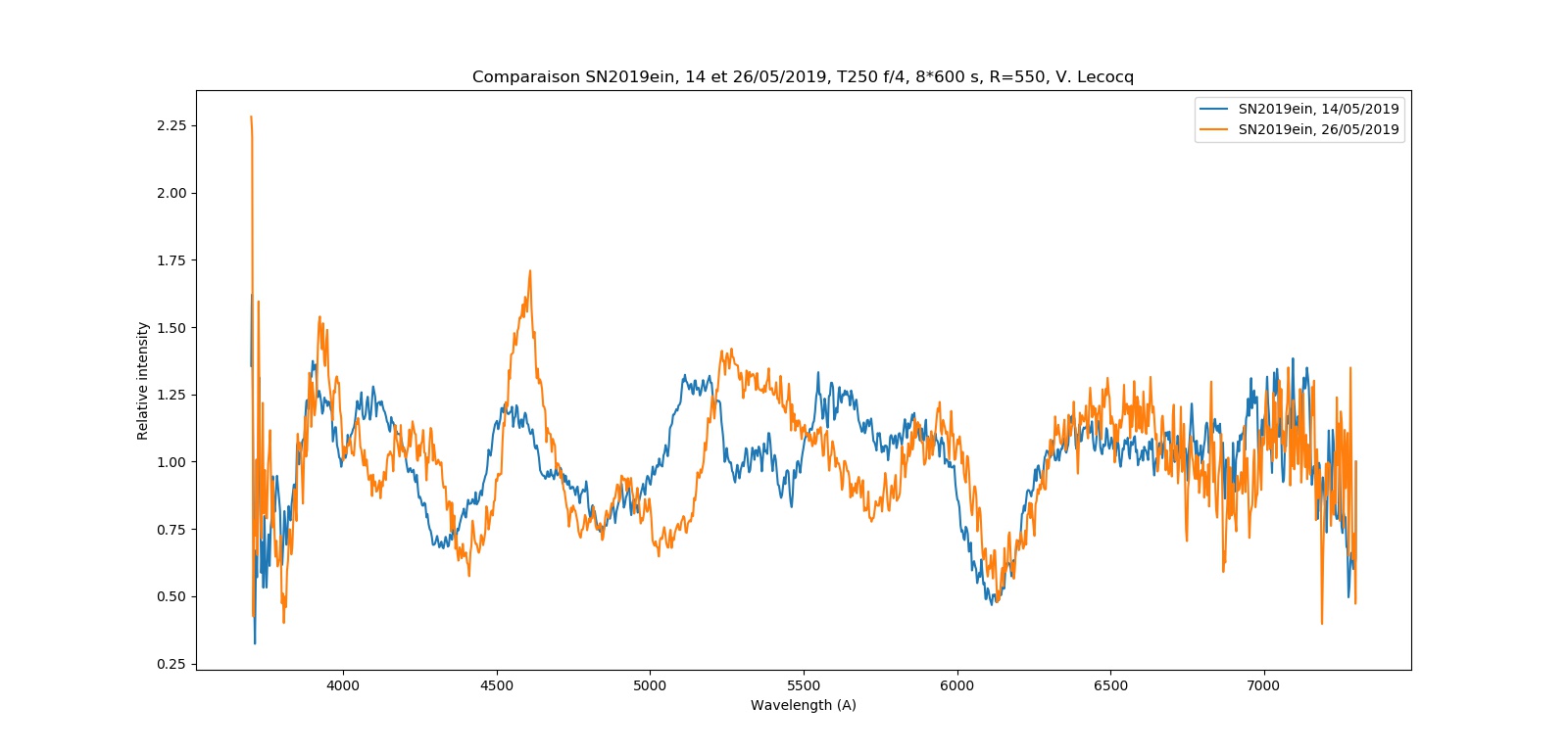

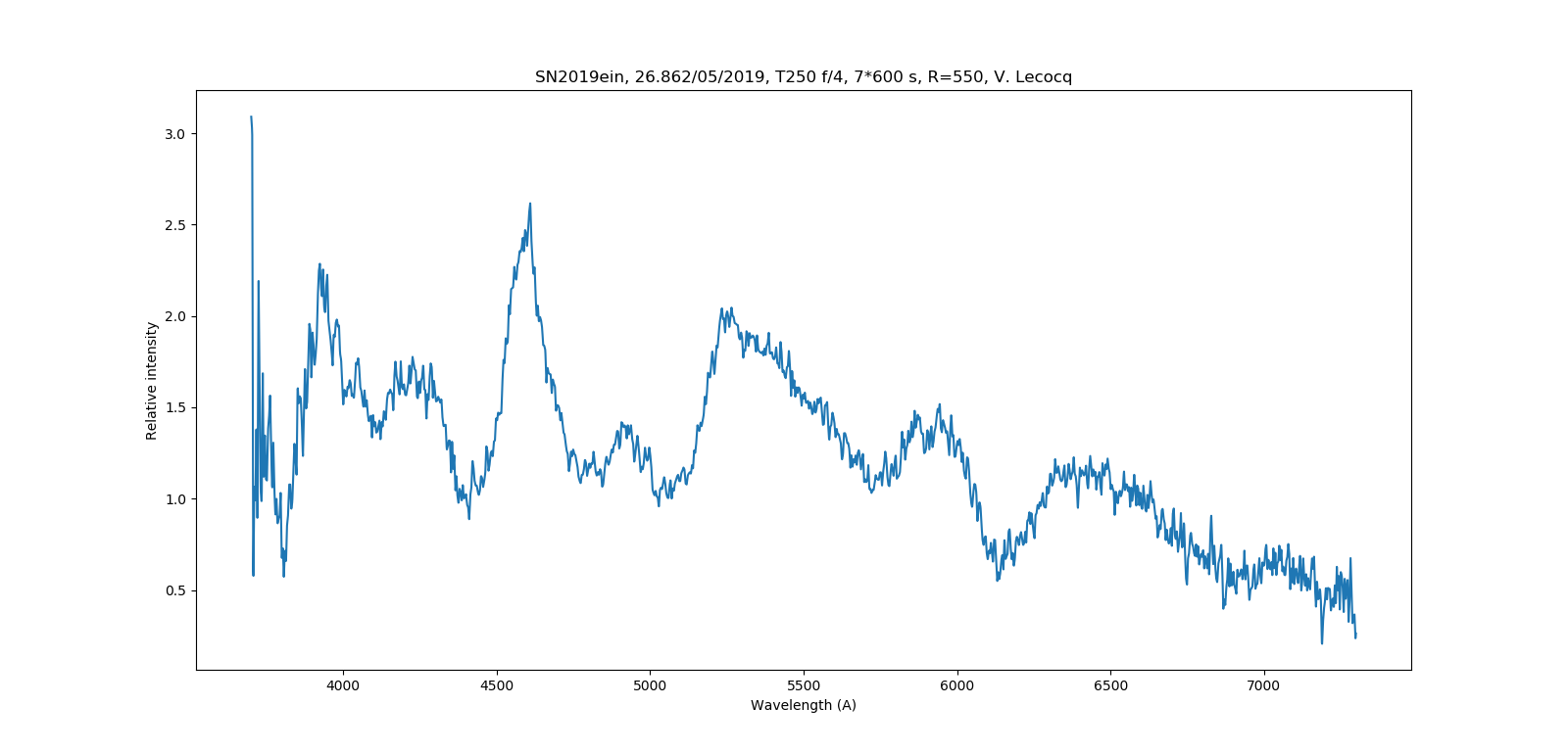

here's my last spectrum of SN2019ein, dated 26th may.
The evolution from 14th may is impressive (spectra corrected from continuum), it's nice to follow such events ! The blue shift has effectively decreased ... .
Vincent
