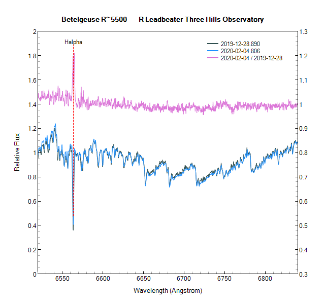

James Foster wrote: It still looks like Betelgeuse EW at Ha has decreased significantly since last year.
I agree. Dividing my spectra for 2020-02-04 by 2019-12-28 confirms that the H alpha absorption has indeed reduced since the end of last year.

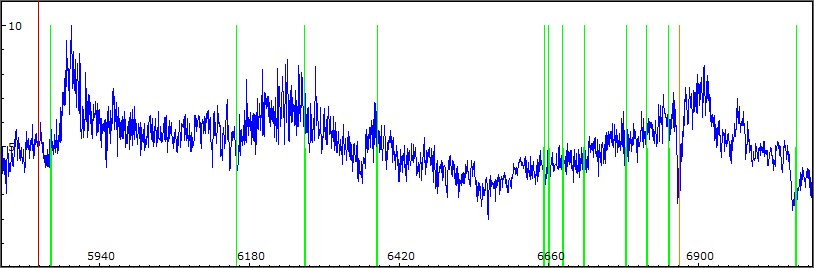

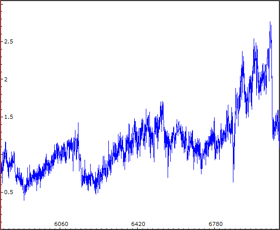

Hi All,
I finally made time to take a spectrum with my L200. My guide camera isn't very good and the guiding optics seem out of collimation (lots of astigmatism), so it was hard to tell when i was on the slit, and it was getting late, so only 1x8 seconds exposure, then a hurried reference using Mintaka (O9III) before it all got too low behind the garage.
So not a very good result, lots of noise, doubtful reference/camera response correction etc, but a start! I also took a division of the spectra with M4v reference spectrum from the Vspec library. There does seem to be an absorption at 7051A (TiO?) and perhaps incompletely corrected Atmospheric O2 band at 6867A. The big peak in the division spectrum at 5890 I'm not sure if is just my instrument not having picked up the depth of the Na absorption line, or perhaps there really is something happening there.
I'll try to improve (left everything hooked up and threw a tarp over it) if the weather is clear tonight, with more exposures and hopefully I'll be able get the guider collimation sorted with a T42 tilt plate between the spectrograph and focuser.
Hamish
