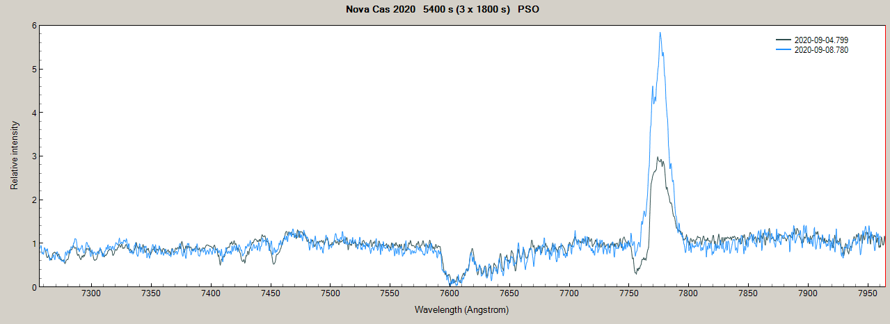

Quick update, for those who can follow O I 7772 or 8446:
O I 7772 has lost its P-Cyg profile (always there from the beginning, at a similar magnitude).

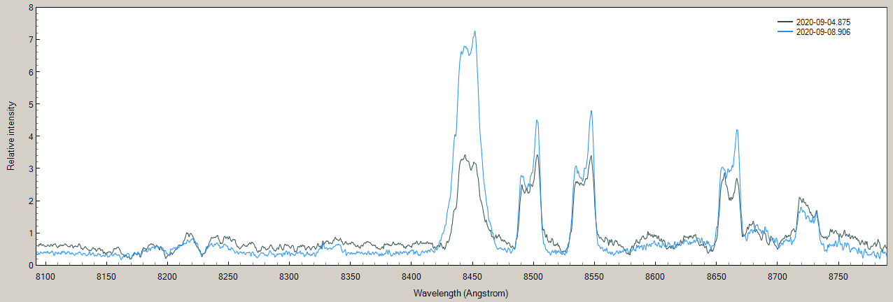

The Ca II IRT region (9 x 1800 sec):
O I 8446 has doubled its height and EW ratio compared to Ca II IRT, and widened.
Having more spectra on the process queue, related to previous 2 comments...
