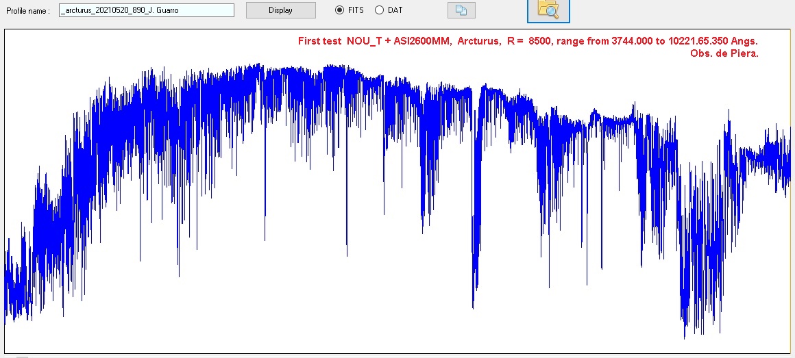

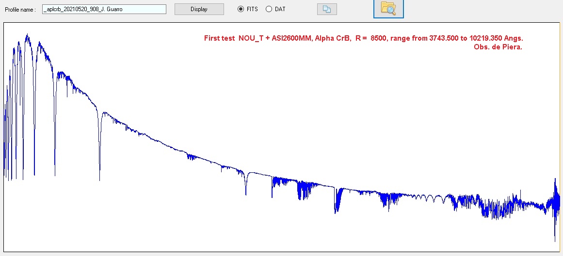

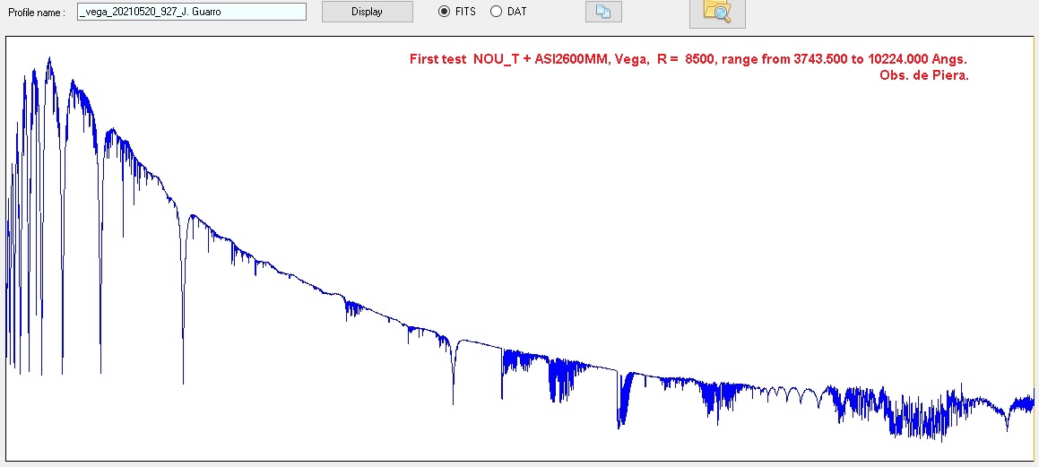

Hello at all,
After many months with bad weather, at last I have been able to observe. Now I show here the first results of the NOU_T with Nikon 85mm. f1.8 and the ASI2600MM.
I think I'll keep this combination. I hope that you like these graphics.
Cheers, J.Guarro.
Cheers, J.Guarro.
- Apl CrB.jpg (88.75 KiB) Viewed 15483 times
- Arcturus1.jpg (171 KiB) Viewed 15483 times
- VEGA1.jpg (92.79 KiB) Viewed 15483 times

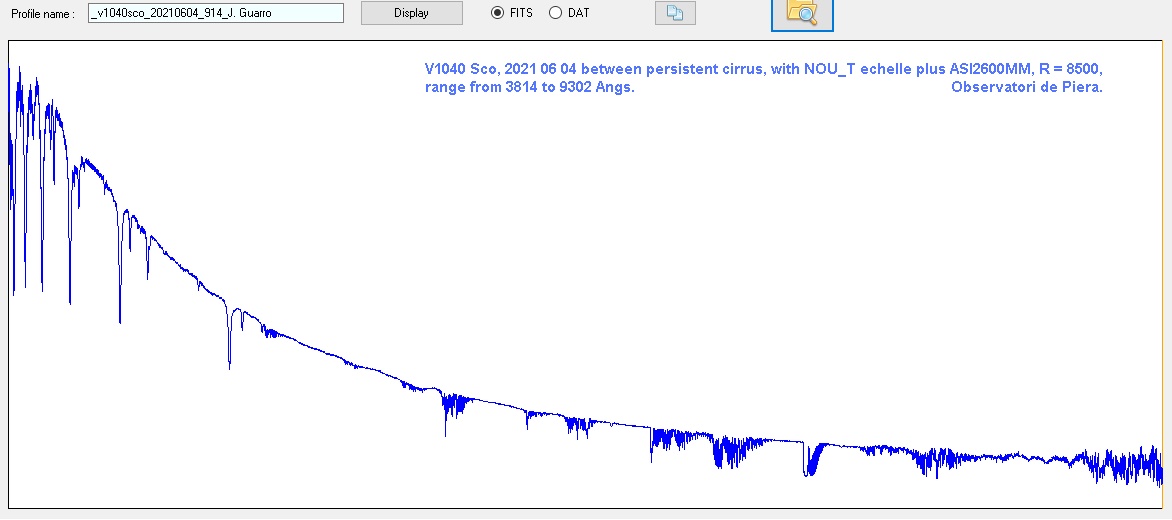

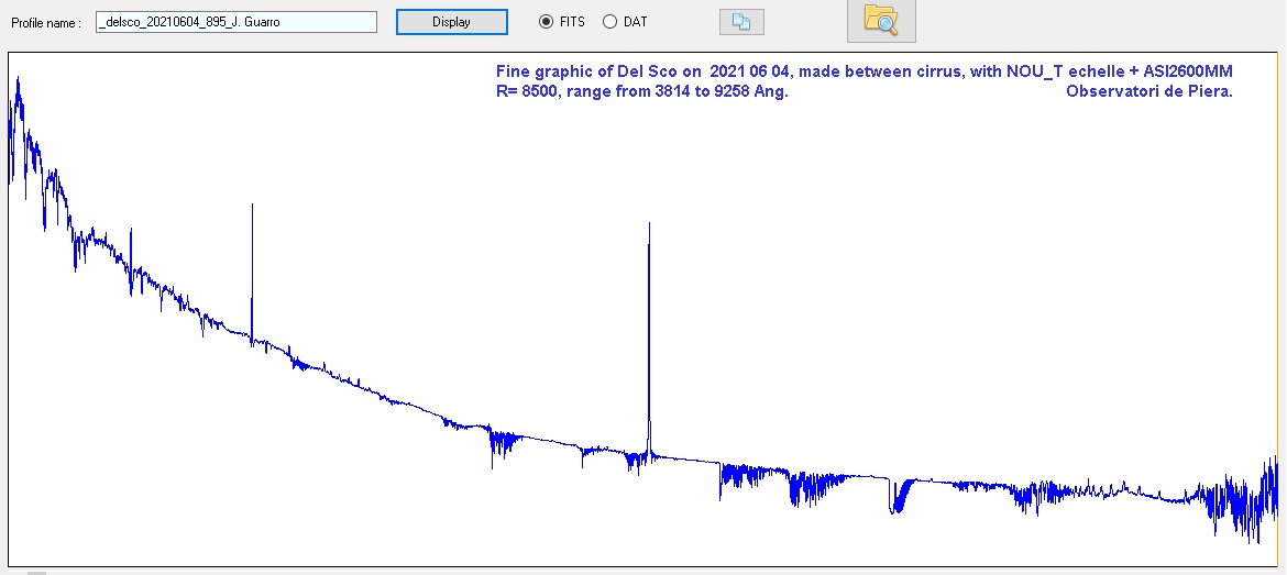

Grazie mille, Umberto !Hello at all,
Here are the other two graphics of the NOU_T echelle with the ASI2600, I haven't madeany more than the 2021 05 20 outcomes, it seems impossible but this year here nearthe Mediterranean Sea the weather is cloudy, but it doesn't rain..
That is the link for their fits.
https://drive.google.com/file/d/1IN_zdt ... sp=sharing
Regards, Joan,
Regards, Joan,
- V1040 Sco.jpg (86.11 KiB) Viewed 15045 times
- Del Sco.jpg (85.04 KiB) Viewed 15045 times

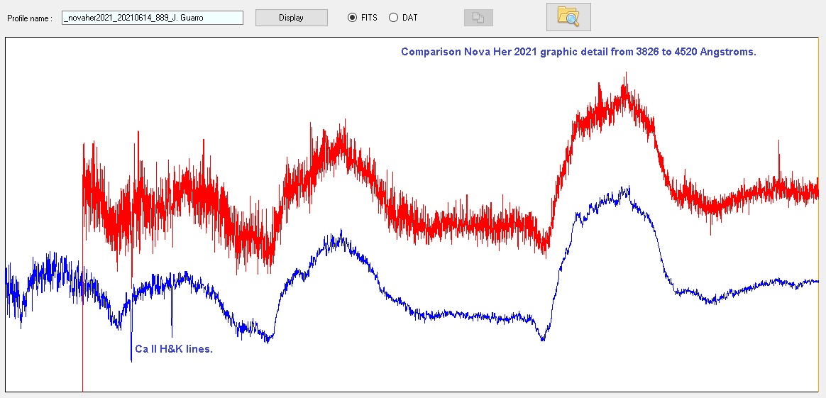

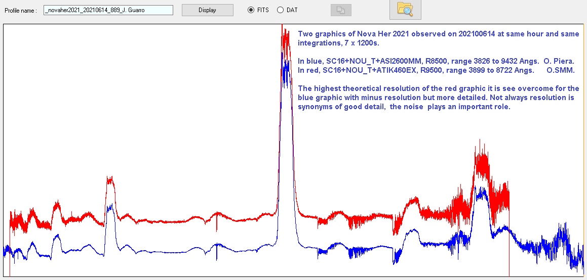

- Posts: 731
Re: NEW NOU_T ECHELLE RESULTS

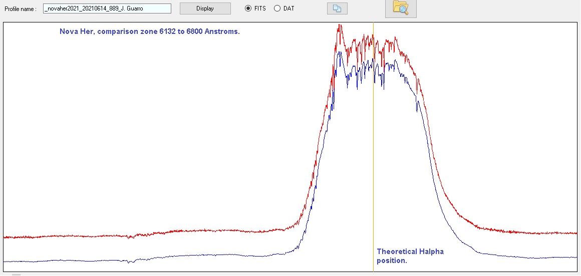

Hello at all,
Nova Her 2021 has served to me for making a performance comparison of the cameras ATIK460EX and ASI2600MM, in a real observation work.
That has made with two SC16 and two NOU_T echelle, one placed in Piera and the other one in Santa Maria de Montmagastrell, ( SMM ), at night was hot, 27ºC. The camera refrigeration were near the edge of -5ºC for the ATIK and -10ºC for the ASI.
You can see and take out your own conclusions.
Regards, J.Guarro
Regards, J.Guarro
- Nova Her 2021 asi 2.jpg (159.42 KiB) Viewed 14828 times

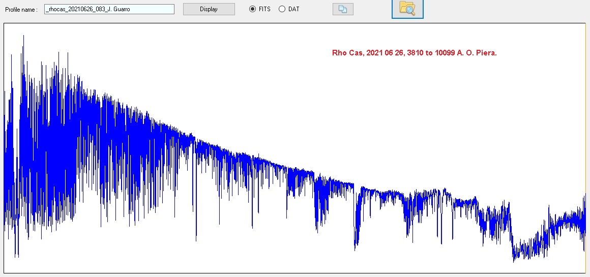

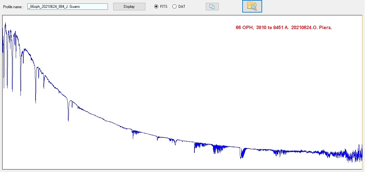

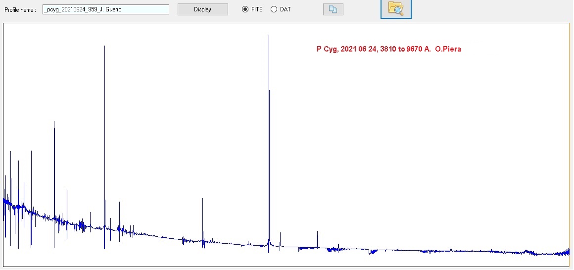

- Posts: 731

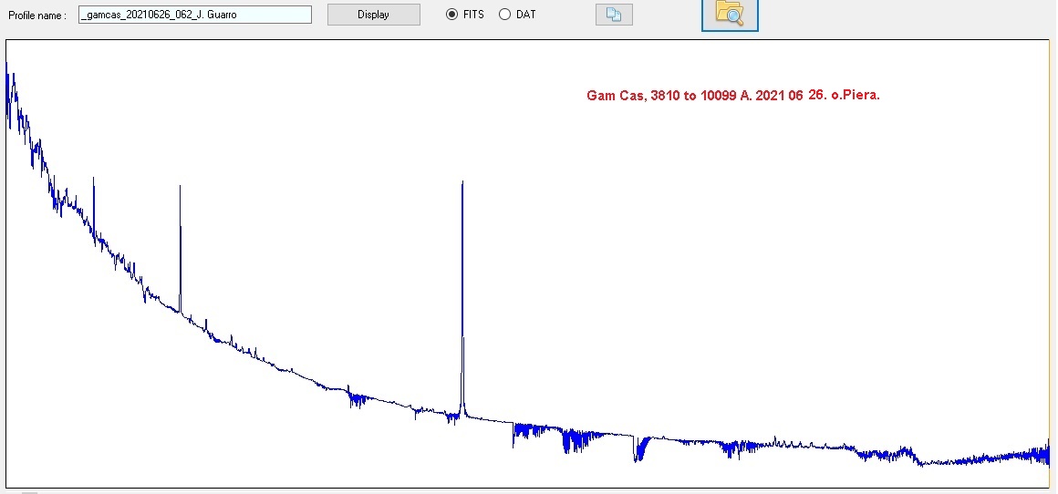

I leave some results more here, in my opinion the NOU_T with the ASI2600MM and ISIS, make very nice results.
I know that the resolution is "only" 8500, but in some cases, resolution is synonyms of noise..
Greetings, J. Guarro.
- 0624_gamcas.jpg (66.9 KiB) Viewed 14603 times
- 0624_rhocas.jpg (135.24 KiB) Viewed 14603 times
- 0624_pcyg.jpg (66.17 KiB) Viewed 14603 times
- 0624_66oph.jpg (70.57 KiB) Viewed 14603 times

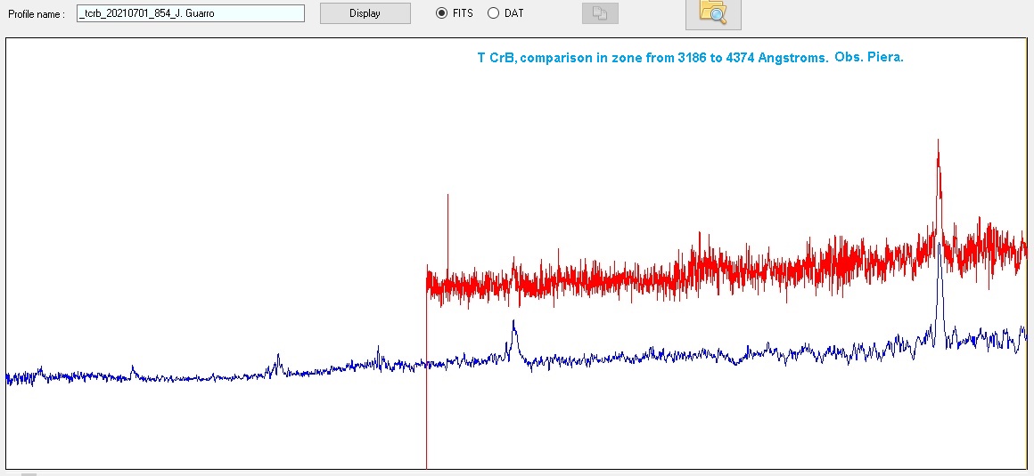

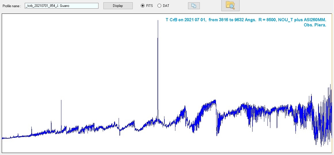

- Posts: 731

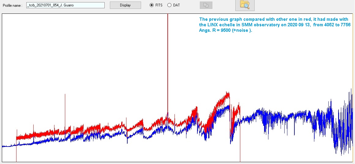

Some thinks about T CrB.
Regards, J.Guarro.
Regards, J.Guarro.
- T CRB1.jpg (97.18 KiB) Viewed 14468 times
- T CRB2.jpg (127.33 KiB) Viewed 14468 times
- T CRB3.jpg (107.51 KiB) Viewed 14468 times
