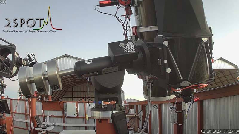

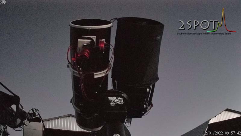

- 1 newton 305mm diameter at f/4 with an Alpy 600 spectrograph
- 1 Ritchey Chretien 305mm diameter at f/8 with an eShel fibre optic spectrograph
Here is what the setup looks like as it is installed in Chile
we can now produce low resolution R=600 spectra with the Alpy 600 and high resolution R=11000 spectra with an eShel.

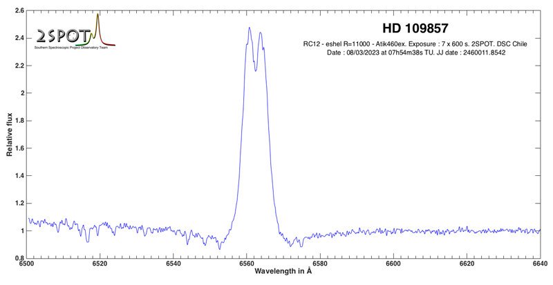

HD 109857 (mag. V=6,49)

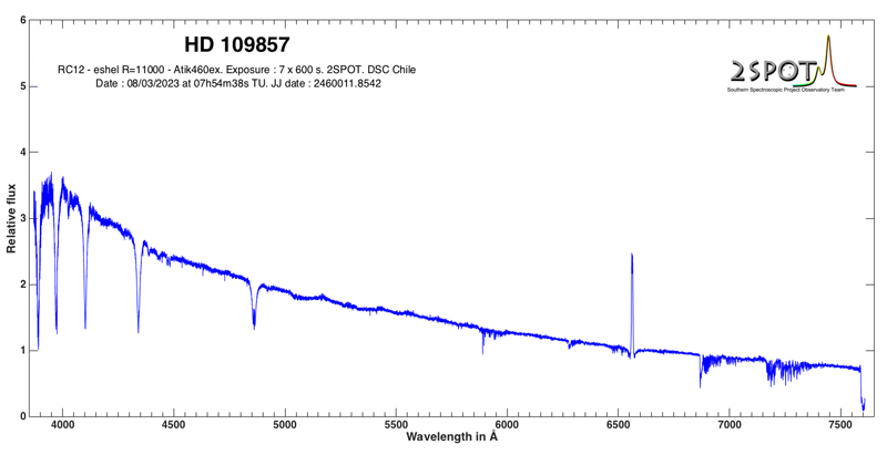

The full graphe of all orders.
And detail on H Alpha line

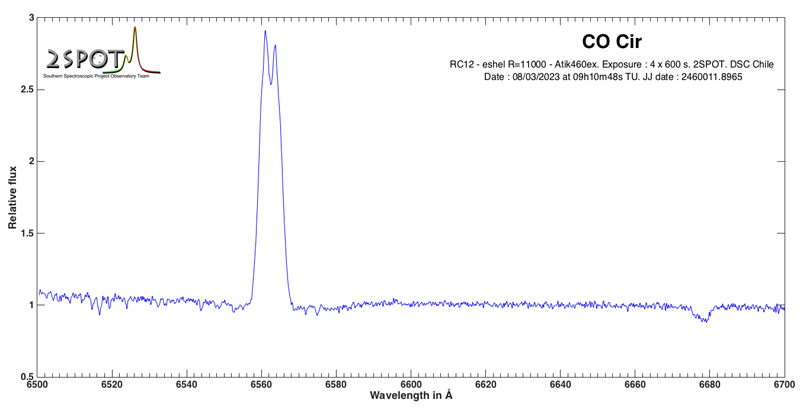

CO Cir (mag. V=5,88)

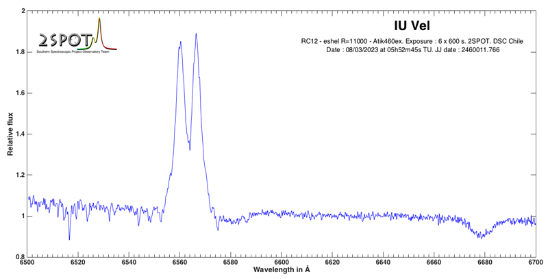

IU Vel (Mag. V=6,05)
