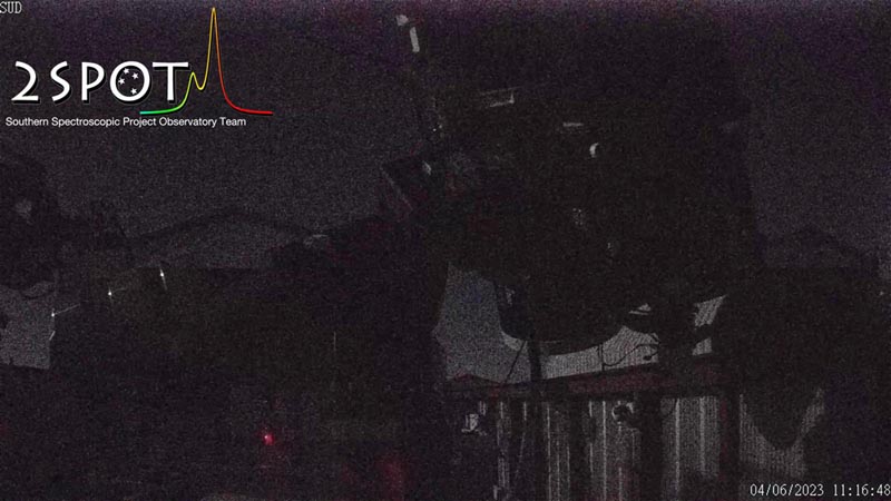

Despite the current full moon, we are observing from Chile, which is not too much of a hindrance to making high resolution spectra with the eShel spectrograph.
Here is a night-time image of the setup being acquired, which is clearly visible because of the light of the full moon

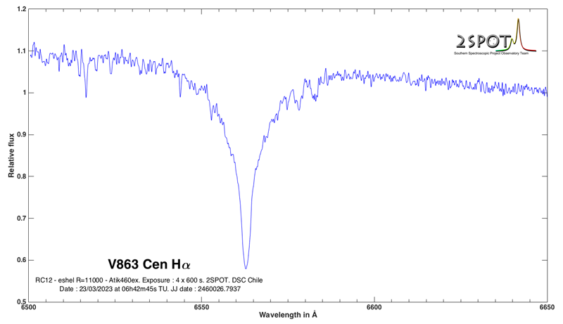

First detection of an outburst on a Be star with our new setup, the spectrum has passed in emission which means that the disk of matter in rotation around the star is reconstituted.
There are 5 years that separate these 2 spectra, the first one in 2018 was made by Terry Bohlsen. But as the southern sky is much less observed than the northern sky, it is finally easy to make discoveries like this one.
Here it is the eShel spectrograph which was used (thus in high resolution R=11000 in average orders and more in some orders).
Here is its position when pointing the target.
It is the RC12 and the eShel which were used here for this spectrum, not the Newton and the ALPY 600.
