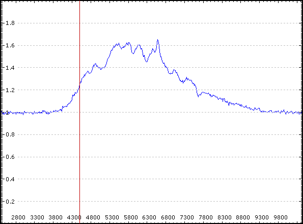

I had a closer look at how much background signal there is compared with the spectrum. Attached is the result for DN Tau without background subtraction and with the background normalised to 1. It is worse than I had imagined and I like to think I live under reasonably dark skies

I have recently been discussing various aspects of this with David Boyd who is also interested in this campaign and you may have come across through the BAA. Here is what I suggested to him about focusing. The attached conversation relates to measurements of Nova Cep but applies generally. I think the doughnuts were move obvious this time as I deliberately focused on H alpha for the nova, using Gamma Cas (This was very easy to do and I think I might use this technique more often. Focusing on H alpha did not seem to degrade the focus significantly at the blue end and brought out some nice emission lines in the far red in the nova)

- DNTau_20130206_incl_background.png (10.55 KiB) Viewed 40909 times
