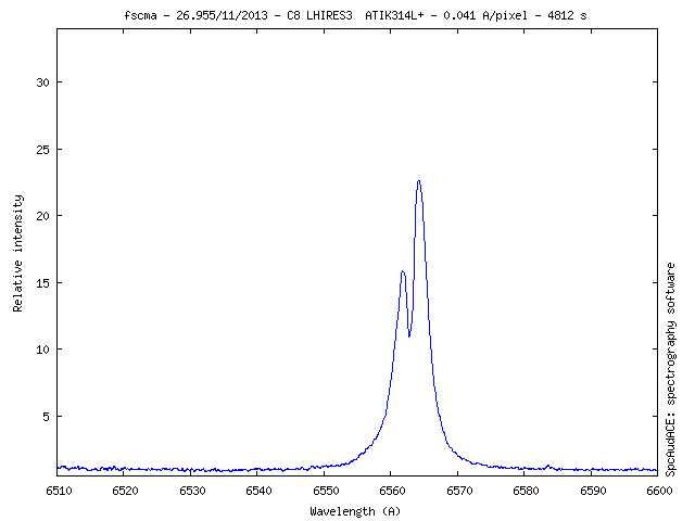

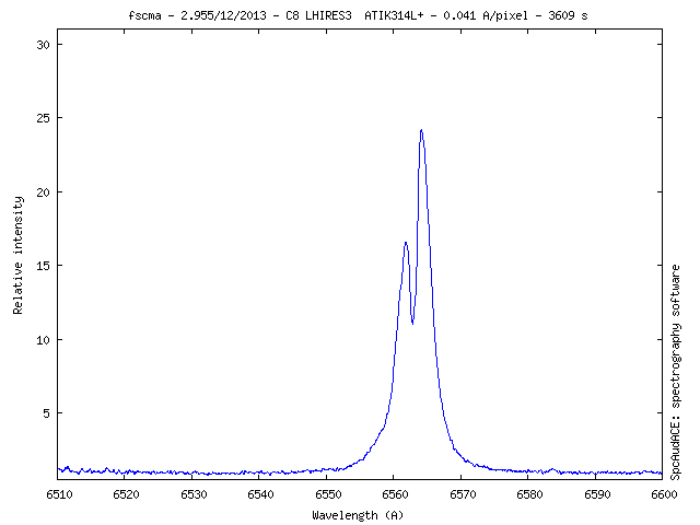

FS Cma observation:
André Favaro
3 spectra for 3 hours obsevation
32 spectra made from  26 nov 2013 to 14 march 2014
