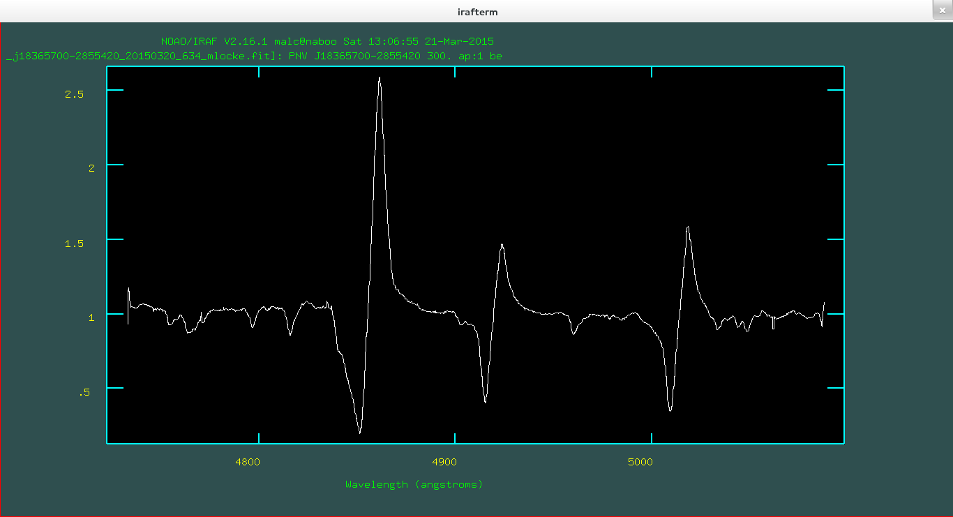

My spectrum of the H_beta region from 2015/03/20.634.
0.4m SCT, L200 @ 1800 l/mm, 24um slit, SBIG ST8. 12 x 300 seconds, R ~
9000.
No photometry but I made a visual estimate of 4.9. Considerable change
since the last spectrum in ARAS.
