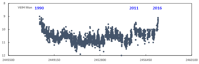

The current ouburst rivals in luminosity the one of 1990

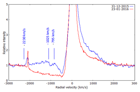

Note : the absorption looks to a P Cygni profile but isn't : a P Cygni profile is formed by scaterring in a continuous wind so the absorption can't be detached as it is sometimes the case for V694 Mon. The absorption is formed in the jet (wich is in our line of sight - like a blazar, for instance BL Lac)
"The structure of the lines differs distinctively from classicalP Cygniline profilesfor a stellar wind. Compared to stellar winds, there is a lack of absorption at low velocities pointing to an outflow geometry, where the acceleration region is not in front of the dominating radiation source. The maximum outflow speed of−6000 kms−1 exceedsalsothe speedof novaejecta byabouta factor oftwo and is far beyond velocities observed in any other symbiotic system. Also the strong variability in the absorption structure is indicative that the mass outflow differs completely from a radiatively driven stellar wind" (Schmid & al., 2001)
The lines are Fe II (42).
Identification of number of lines in Schmid (2001)
Evolution of H alpha absorption from 2015-12-31 (Peter Somogyi) to 2016-01-21 (Tim Lester)
