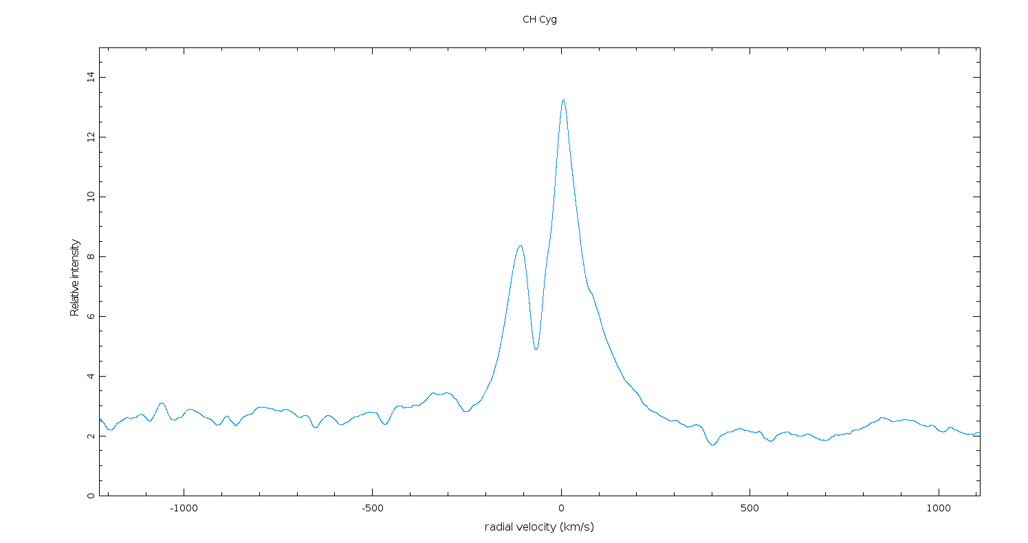

A time serie graph of CH Cyg during 3H30
Jacques Montier
Posts: 242
Re: Dramatic change of H alpha profile
Post by Jacques Montier »
10x180s exposures of CH Cyg on 2015/08/22.
CH Cyg Halpha profile is quite stable.
Best regards,
Jacques Montier
