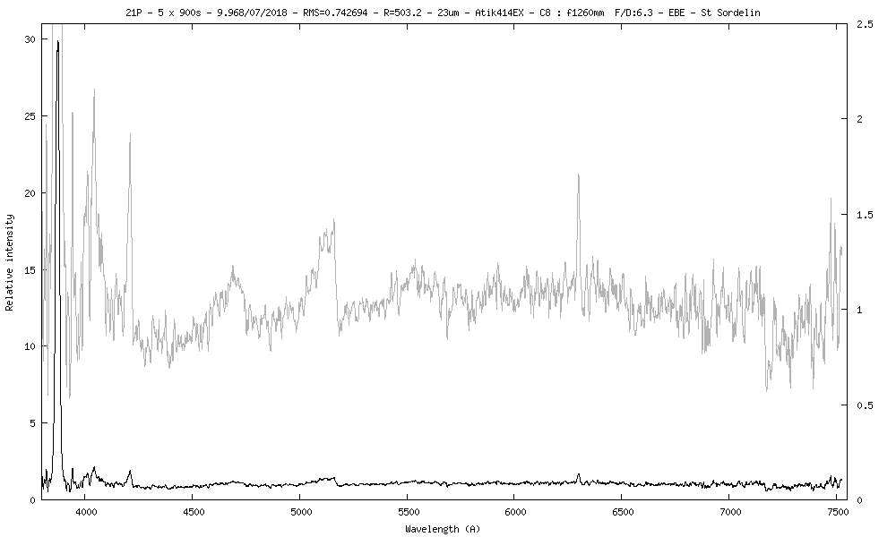

Ciel impeccable, mais signal moyen...

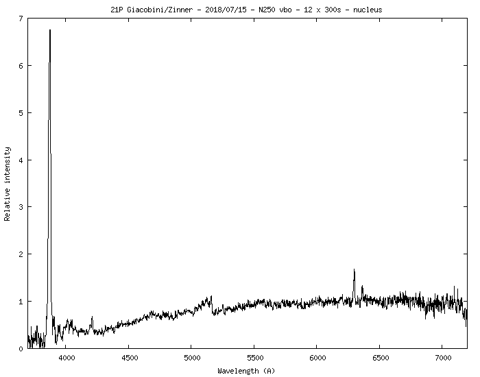

This comet was one of the target of the last OHP worshop.

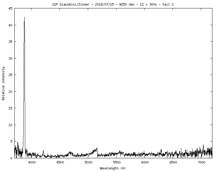

After a talk with Christian Buil, I made 3 processings of the main spectra : one to get the nucleus spectra and the 2 others to get the tail spectra. It was difficult to process because I've not made a spectrum in order to remove the sky signal but I think I had a "clear" zone in the upper part of the slit I used to remove this signal. The Sun spectra (G2V) was not removed too.
The spectra of the nucleus
The spectra of the front of the comet tail
The rear part of the tail
This was the first low resolution spectrum of this kind of object I've made. Really interesting !
