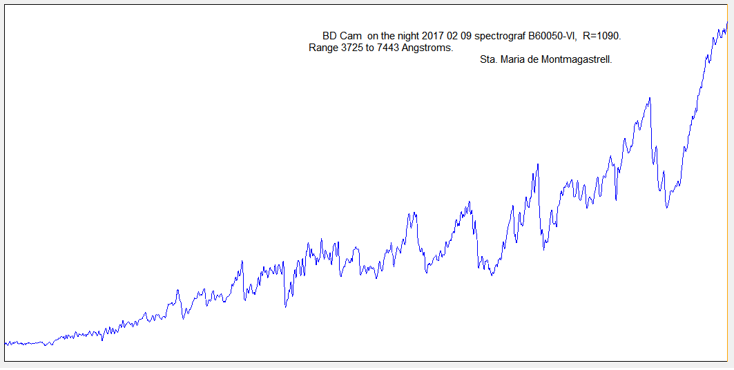

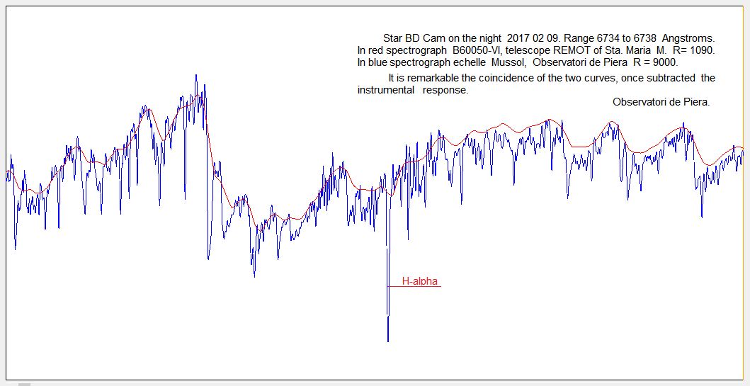

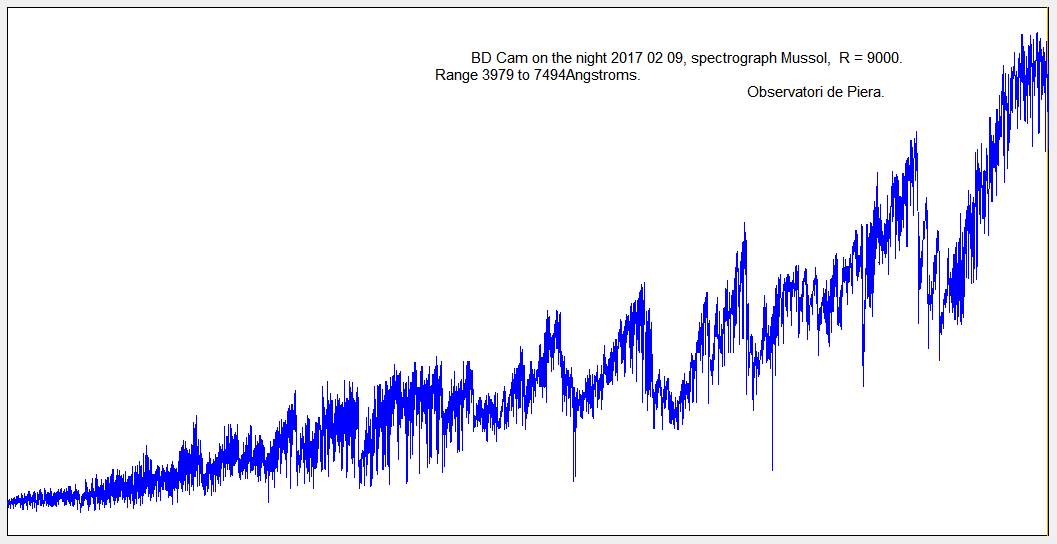

Hello :
These observations of the last night of the symbiotic star BD Cam.
Now the bad weather returns.
Regards, Joan.
BD Cam
- Posts: 731
BD Cam
- BDCAM-2.png (16.14 KiB) Viewed 10071 times
- BDCAM-3.png (31.82 KiB) Viewed 10071 times
- BDCAM-1.png (32.52 KiB) Viewed 10071 times

Nice spectra and coincidence with the echelle Mussol, Observatori de Piera.
I might shoot this tomm in the CaK to get a baseline for future observation
because the variability seems constrained to the UV and near IR, He bands.
See: https://en.wikipedia.org/wiki/BD_Camelopardalis

Yes, interesting comparison !
Joan, je n'ai pas reçu tes spectres
James,
BD Cam is a low excitation symbiotic
The emission appears only in the far UV 1200-1800
The main interest of BD Cam is ... its brightness.
Scarce observations in low resolution are welcome, because the star can evolves, strenghthening its radiation (intensity and hardness)
Remember that the fascinating CH Cygni has been considered as M giant standart until the 60's when appeared first its emission spectrum
See also SU Lyn (mag 8-9), detected as a symbiotic star recently
Observing any late giant can lead to the discovery of a symbiotic behavior

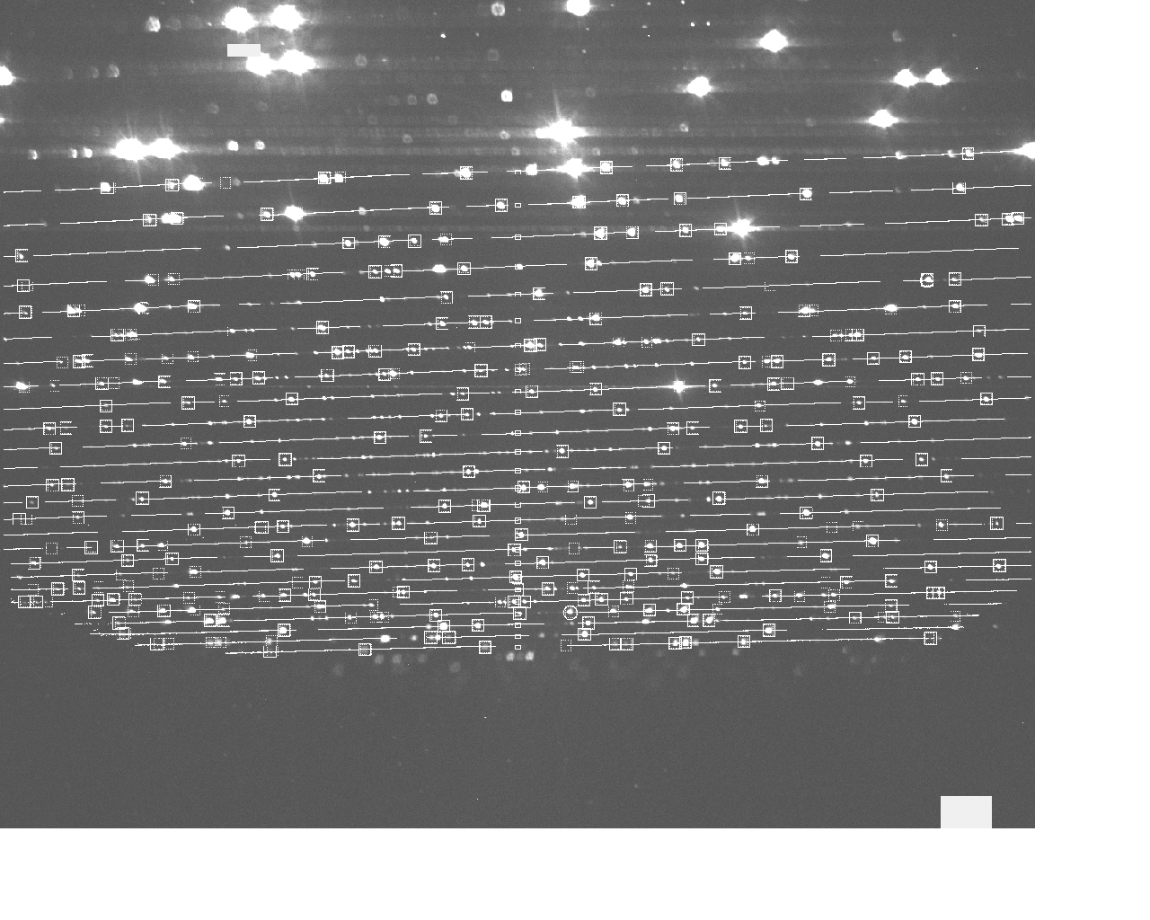

My Echelle, Mussol, is designed for the visible spectrum. Possibly could focus a bit on CAK (missing little), but it would be detrimental to the whole of the visible. Moreover, different optical elements and CCD detectors in my power, are focused on the visible spectrum. The result is a set of devices that only open a little door to the ultraviolet. This correspont at the bottom of the image.
At the top we have the infrared, far more generous. Also part childIX approach. Everything depends on the purpose of the observations.
For example, the serious study of Be stars is centered on the H-alpha, so no need to use an Echelle. A normal spectrograph with a resolution from 6000, gives very good results for measurements, like an Echelle.
Other types of stars, symbiotic, WR, New Star. Interesting also areas between 4000 and 5500 angstroms, an Echelle here makes things easier. The other option is to change the angle of the grating in the simple spectrograph. In this sense it seems Echelle le is for people a little lazy.

Joan, looks like your using 26 orders out of 34 possible; albeit, the bottom 2 UV(?) rows would be hard to process with low SNR.
If I every move to a darker sky location, get a 0.5 meter or larger telescope, I'll definitively invest in an Echelle system
based on the superb resolution and spectral coverage. Great BD Cam work!
