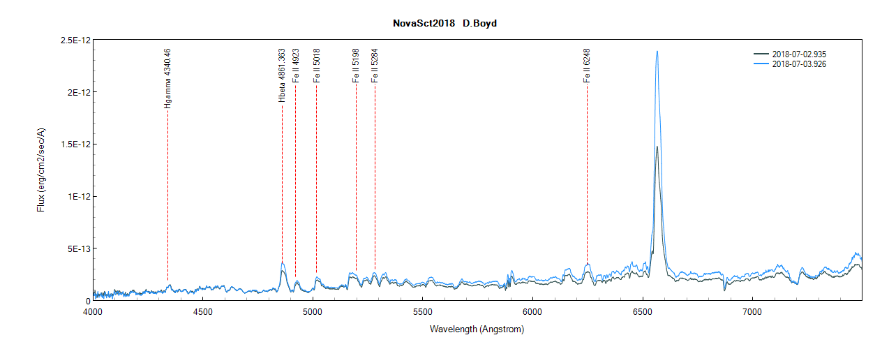

David Boyd
Posts: 164
Re: TCP J18292290-1430460, mag 10 in Sct
Post by David Boyd »
Spectrum last night (3 July) very similar to the night before except H-alpha stronger. The star is also slightly brighter V=10.76 compared to V=10.92 on 2 July.
