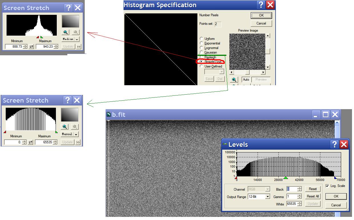

Sorry , I forgot to say that QHY6Pro's photo insists of 3 parts: over scan area + object area + optical black area. All of them are showed together.
- result.JPG (170.74 KiB) Viewed 9710 times

Dear Robin:
Thank you very much! I have just looked at bias and made a screenshot. I do not know if the histogram is good or bad?
Dong .Li
Dong .Li
- histogram.JPG (200.24 KiB) Viewed 9697 times

The shape of your histogram looks rather strange and it also looks clipped at both the low and high end.

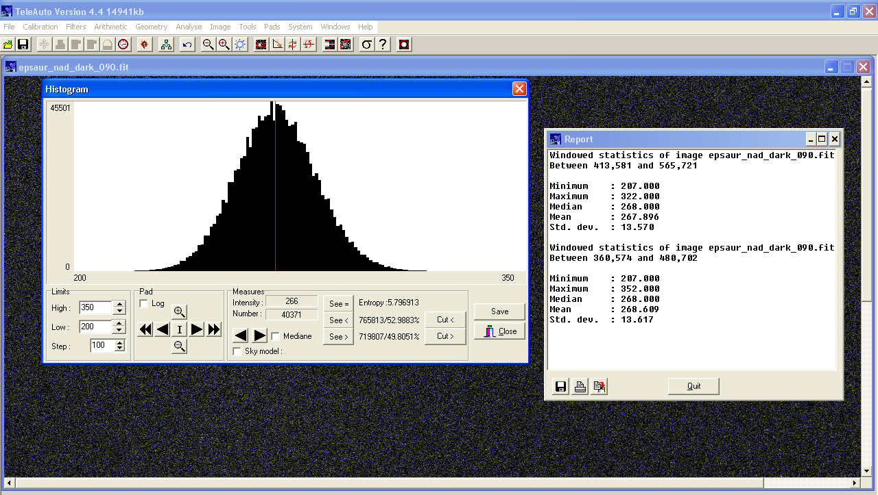

Attached is the histogram of a single 300 sec dark frame from my ATIK 314L+

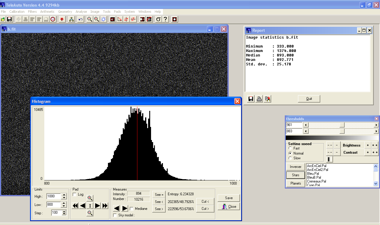

Re: evaluation of noise and gain for QHY6Pro
Hello Dong,
I checked your bias frame. The histogram looks fine. I think your histogram plot must be incorrect.
Hello, Robin:
Thank you! This time I open MaxIm and find 2 buttons "histogram and levels", last time it is default as straight-line, so I think that this makes that strange shape; when I change into Gaussian, it becomes a bell-shaped one just like yours, and so does the "levels".
I think that this is the reason that histogram plot is not correct, don't I?
Regards,
Dong . Li
Regards,
Dong . Li
