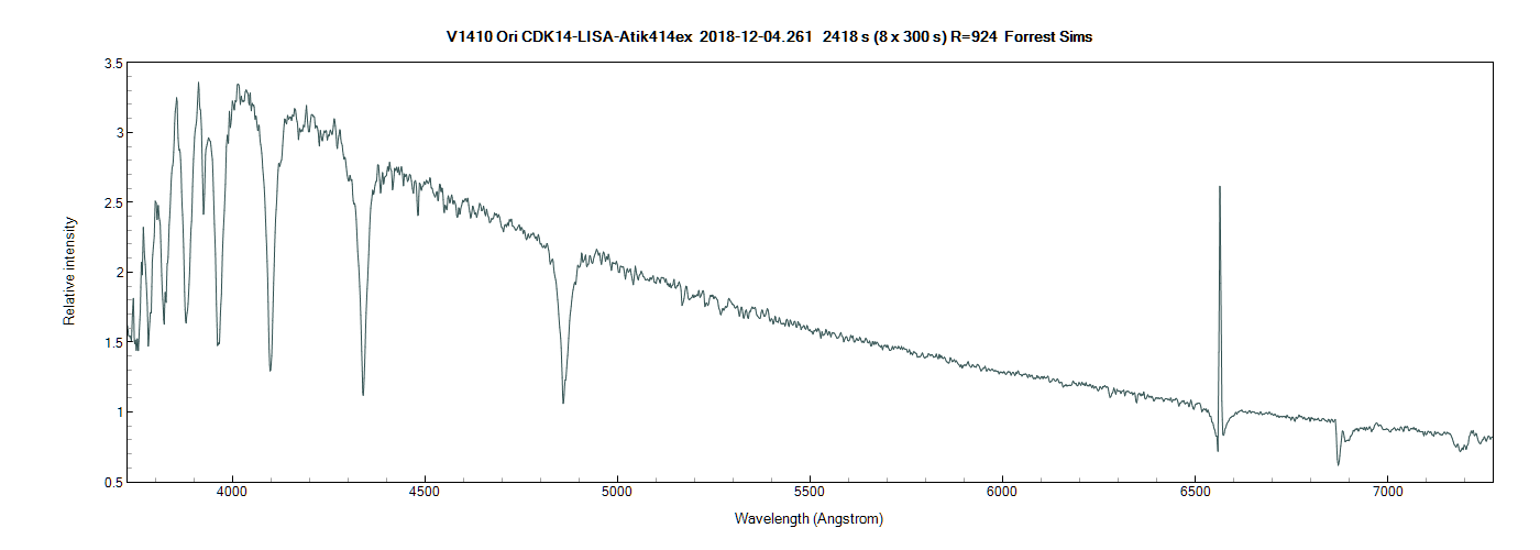

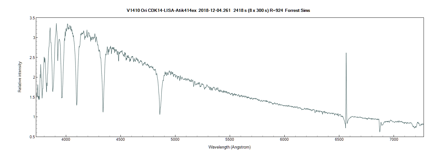

Here are spectra of R Mon and V1410 Ori. R Mon was a more difficult target at approximately magnitude 11.8. Located at the tip of the diffuse Hubble’s Variable Nebula, it is a bit hard to put the star on the slit and guide on it. You can see what the target looks like at the tip of the nebula in the attached auto guider image. The spectrum of R Mon shows HeI, many Fe lines, OI and SII emission lines.
The spectrum of V1410 Ori looks very much like the one David posted from 2018-11-21.862.
Woody
R Mon autoguider plate solved image
R Mon platesolved.jpg (30.35 KiB) Viewed 35478 times
Annotated R Mon spectrum
V1410 Ori Spectrum
V1410 Ori Spectrum
