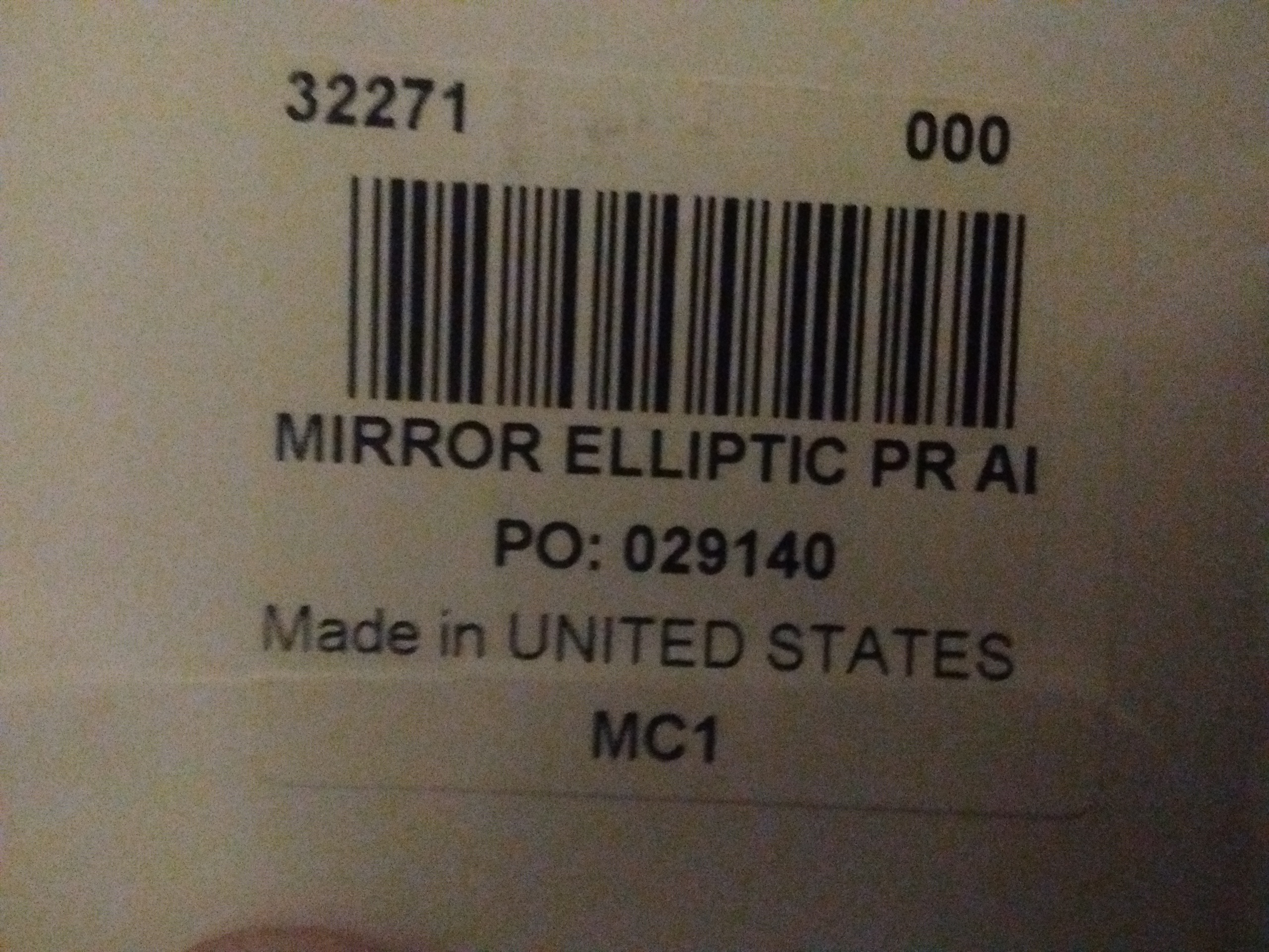

Postby Robin Leadbeater » Thu Jan 31, 2019 10:13 pm
Hi Etienne,
This is the one used in the original kit
Posts: 1286

Postby etienne bertrand » Wed Feb 27, 2019 11:08 am
Merci Robin, mais je ne sais pas trop quelle référence choisir..

Re: miroir plan elliptique Edmund - LhiresII - reference ?
Postby Robin Leadbeater » Wed Feb 27, 2019 6:07 pm
The original LHIRES used part #32-271 (as printed on my envelope)
https://www.edmundoptics.fr/p/elliptica ... minum/2247
