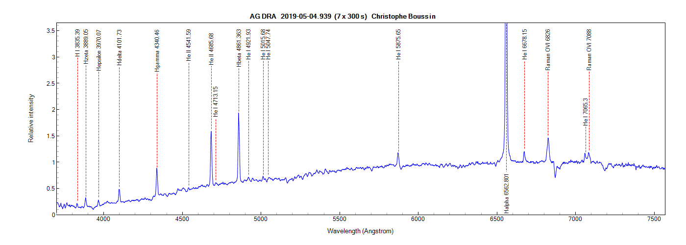

Here is my last contribution to the AG Dra monitoring.
I obtained the following spectrum the 4th of May at 22 h 31 TU with my Alpy 600 (resolution of 506, JJ = 2458608.4388) and an acquisition time of 35 min :
AG Dra on May 4th, 2019
_agdra_20190504_939_Christophe Boussin_3700_7570.png (76.96 KiB) Viewed 9215 times
AG Dra on May 4th 2019 (identification from PlotSpectra)

Still quiescent
Only the singlet He I 6678 is sllghtly increasing:
