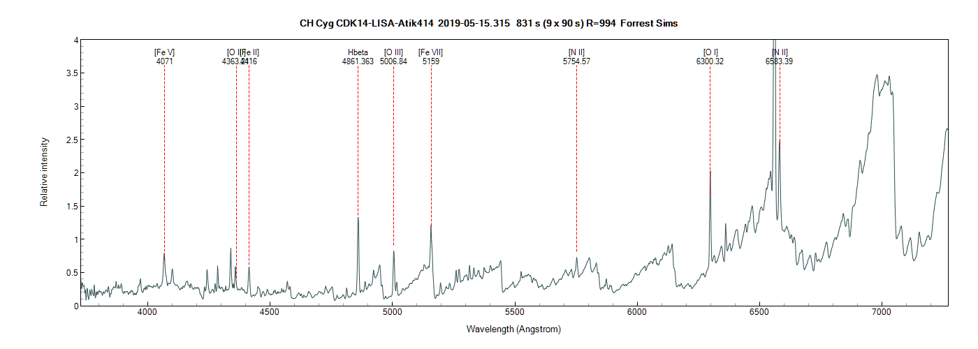

Here is my low resolution contribution on CH Cyg from last night using the Shelyak LISA. I have exaggerated the vertical scale. I have attempted to identify the Oxygen, Fe and Nitrogen lines. Do these look correct?
Woody
Re: CH Cygni: still surprizing
Hi Woody,
Correct, unless high ionization Fe lines.
CH Cyg is a peculiar symbiotic, powered by accretion and temperature of the hot component ~ 50 000 K (only!).
Most of the lines are low ionized lines (allowed and forbidden) such as Fe, Ti, ...

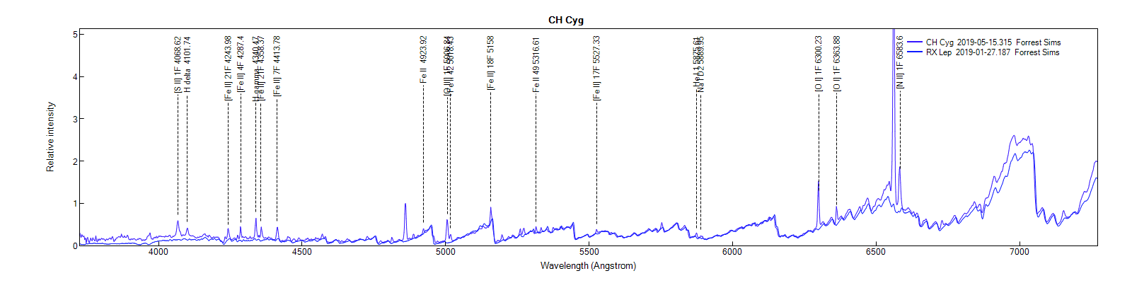

Hi Woody,
Here's an identification on your spectrum
I used your spectrum of RX Lep to detect the lines which appears at that resolution
More lines could be identified in the range 5000-5500

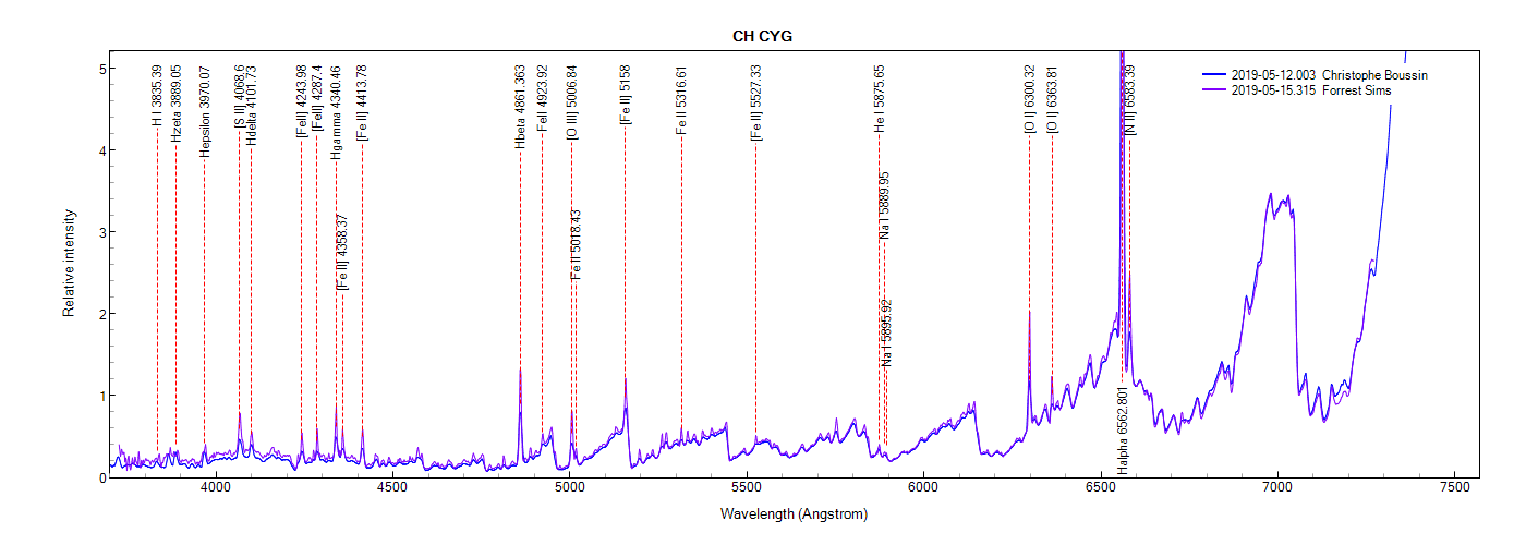

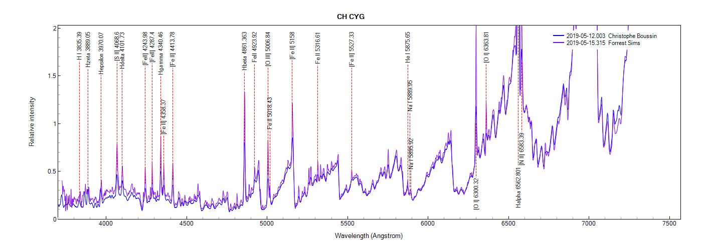

Just to highlight the effect of the resolution on the detection of spectral lines, here is a comparison of the Forrest Sims spectrum (LISA) of CH Cyg with mine (Alpy).
I indicated the position of the same lines identified by François.
CH Cyg on May 12th and 15th, 2019 (comparison)
CH Cyg on May 12th and 15th, 2019 (comparison, zoom)
