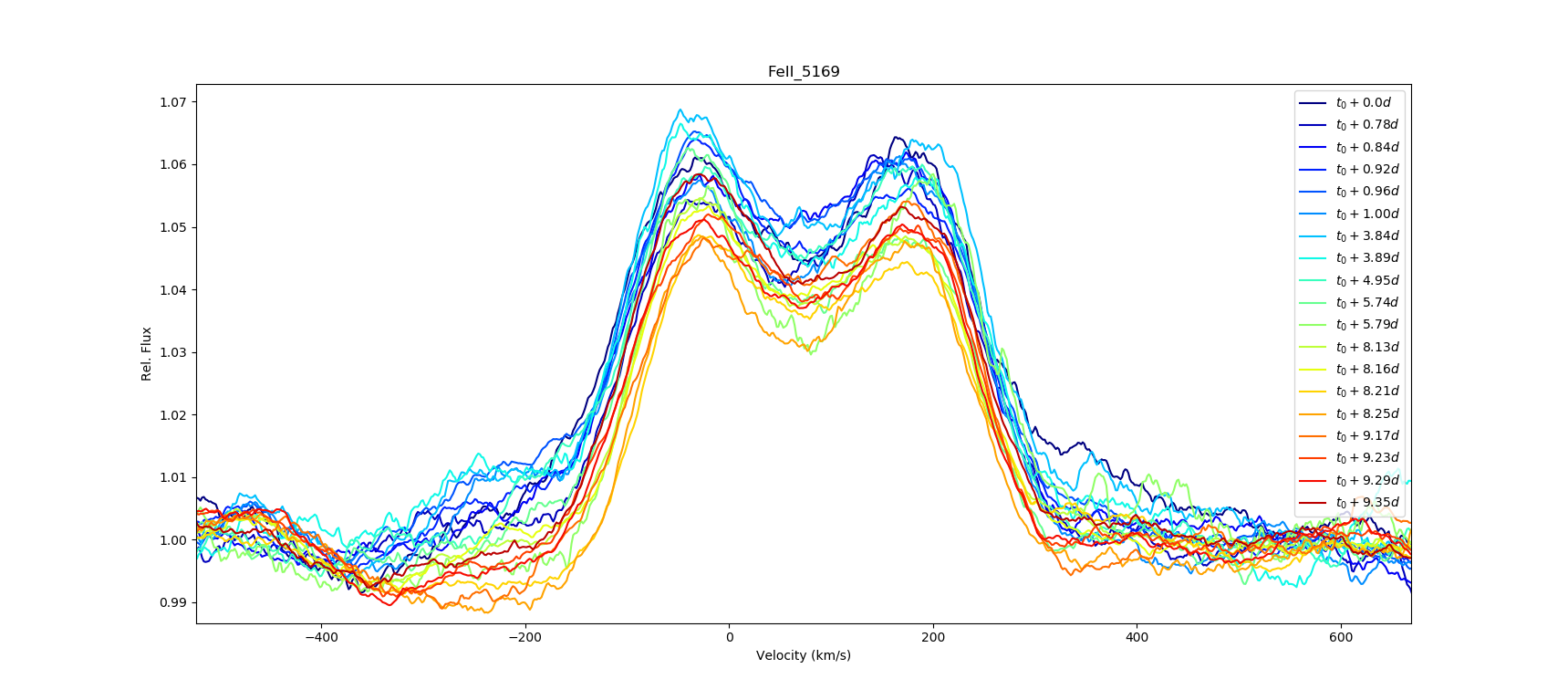

Continuing to see interesting variability in V357 Lac. The first spectrum here is on the night of Oct. 4.
Also working on V442 and, where the first spectrum is on the night of Oct. 9.

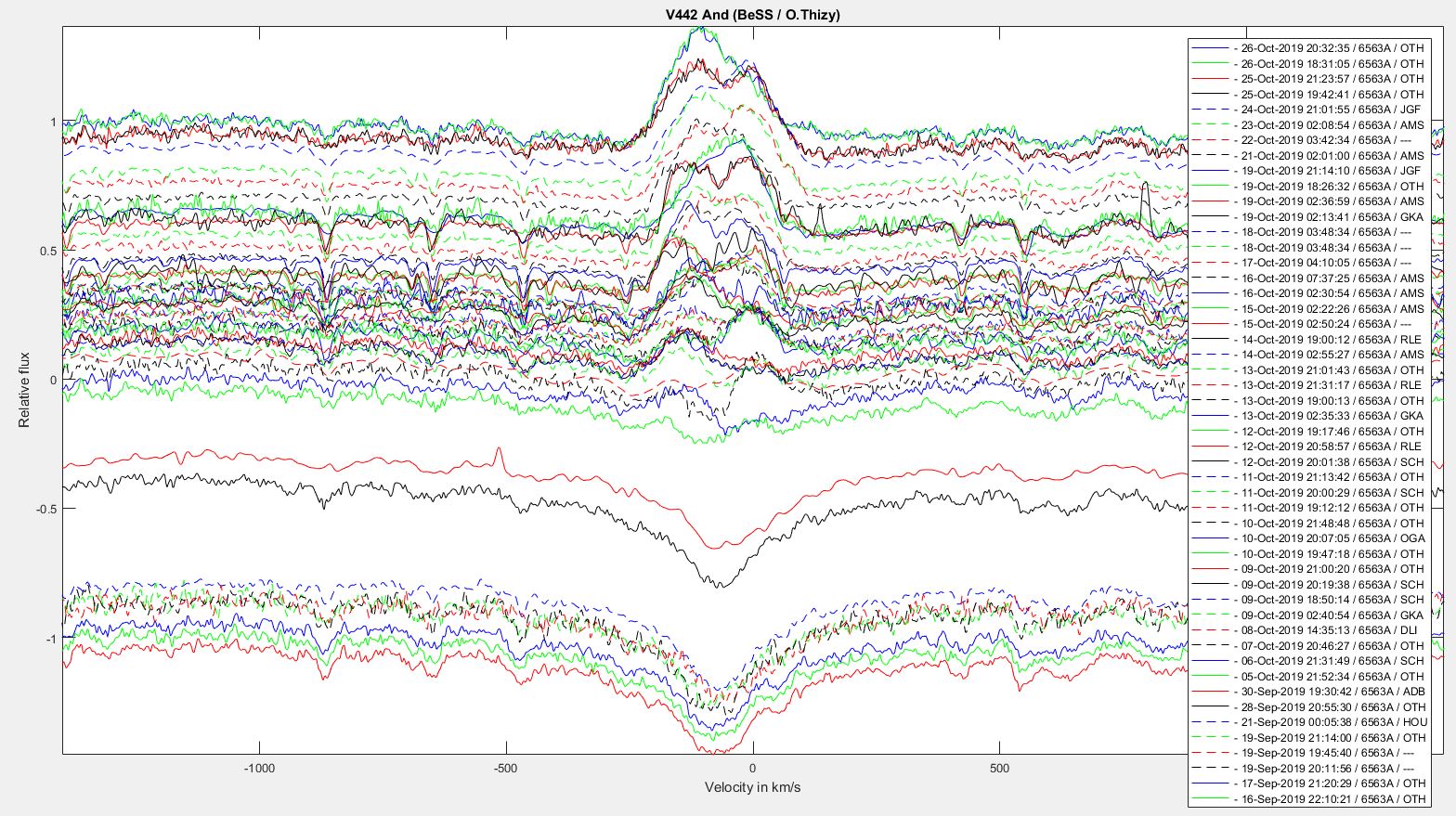

- Posts: 370
Updated graphs for V442 And using several spectra from BeSS (thanks to all observers!).
Same in 3D with colored spectrogram:
Using the first spectrum as baeline (ie: substrated) to only show the emission line:
Olivier
Olivier
