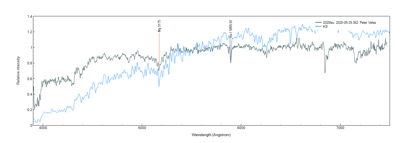

Your initial diagnosis was also correct - I had taken a spectrum of the galaxy itself rather than the foreground star. I attach a plot of my "SN" spectrum against a K3V spectrum. The K3V spectrum is shifted by 1129km/s - roughly 20 Angstroms. Both the Mg triplet and the Na line match up well to my spectrum. I've marked these on the plot. Feel free to critique.
I'm now keen to dispel this misconception of the foreground star as a SN by taking a decent spectrum of it. Once the moon goes away, I'll revert to this target.
Pete

BTW - I have been using both ISIS and Demetra to reduce the data I have collected so far. Its fair to say that the results are not consistently identical. I expect this is largely a result of the learning curve which I am navigating at the moment. I find it harder to remove sky background in Demetra which is why some of my spectra have very suspect emission lines. For binned images, the calibration achieved in ISIS is more suspect. The process to produce a response curve also yields different results.
So at this stage, I wouldn't accept the continuum of my spectra as necessarily reflective of the target at this stage. This is why the overall shape of my spectra and the K3V Pickles data are not the same. That said, I am confident of the absorption lines which fit quite well in my view
Will post about this on the Software part of the forum soon.
