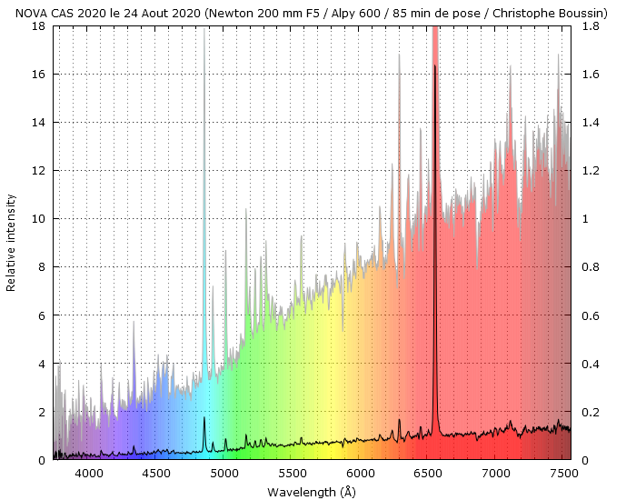

With a less favorable weather than at OHP, I think, I have, I obtained the following spectrum of the nova Cas 2020 the 24th of August at 22 h 51 TU with my Alpy 600 (resolution of 501, JJ = 2459086.4521) and an acquisition time of 85 min :
- Nova Cas 2020 on August 24th, 2020
- _novacas2020_20200824_952_Christophe Boussin_3750_7565.png (91.71 KiB) Viewed 9690 times

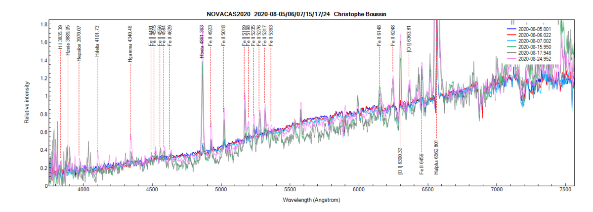

- Nova Cas 2020 on August 5th, 6th, 7th, 15th and 17th and 24th, 2020 (identification of lines from PlotSpectra)
Like the Balmer lines, the FeII lines are increasingly visible !

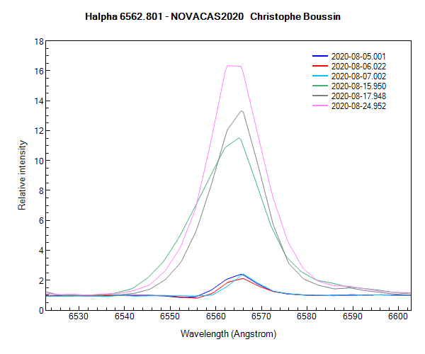

Evolution of the Halpha line :
- Halpha line on August 5th, 6th, 7th, 15th, 17th and 24th, 2020
- novacas2020_20200824_952_Christophe Boussin_Halpha.png (28.14 KiB) Viewed 9690 times
The relative intensity of the Halpha line is still increasing !
