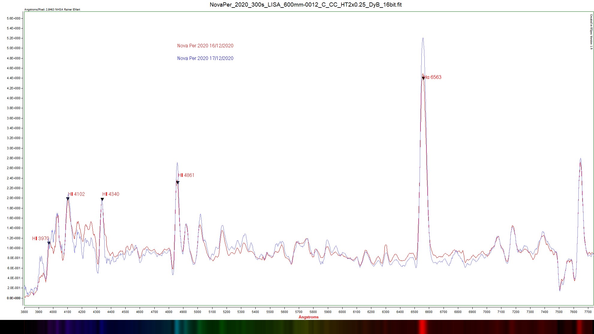

Still good weather and here a comparison of Nova Per from 16 and 17/12.
LISA on TOA 130 @ 600mm and camera QSI 520i.
Lots of fun.
Lots of fun.
