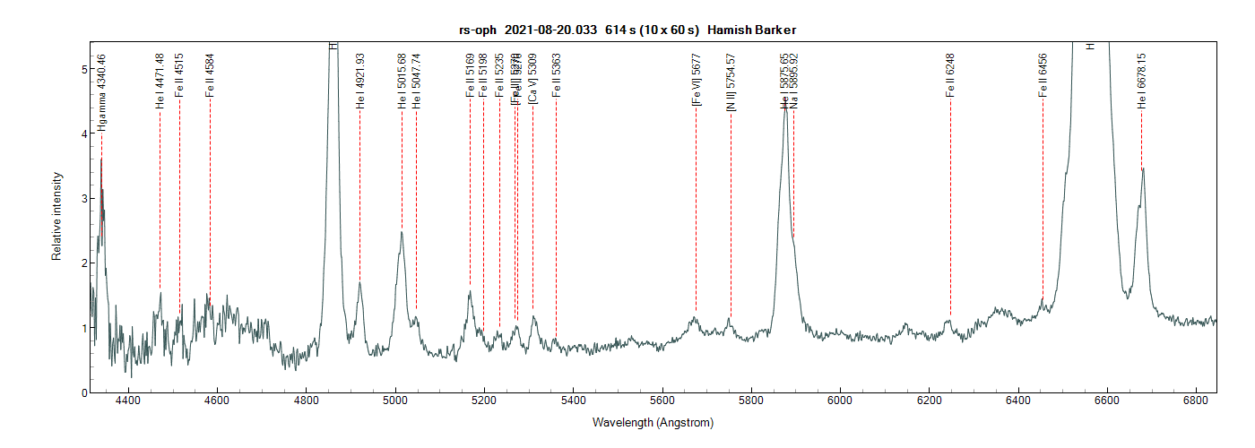

Hamish Barker
Posts: 227
Post by Hamish Barker »
finally joining the party after some equipment drownings last week. 10 minutes at low altitude (21 degrees) with 175mm newtonian at f7, and an L200 littrow, 180lpmm grating.
No sign of pi cyg profiles any more in my spectrum.
Is anyone managing a central location for uploading fits files of spectra of this object?
I see Christian is pushing the limits with star'ex, amazing work!
The ARAS, BAA and AAVSO databases are all accepting spectra of RS Oph
In ARAS you can find it under the Symbiotics here
https://aras-database.github.io/database/rsoph.html
Posts: 1565
Hello Hamisch
You can not detect Ca V or Fe VI at this state.
High ionized lines will appear later when the envelop (and photo-sphere) will recede sufficiently and their temperature increase to about ~100 kK and more.
At the current state, the temperature is about 30 kK ([OIII] for example is raising).
Hamish Barker
Posts: 227
Thank you Francois,
I thought that those IV and V lines were likely not the correct ones, but couldn't see other likely ones in the short list which I had on hand. what do you think they are likely to be?
