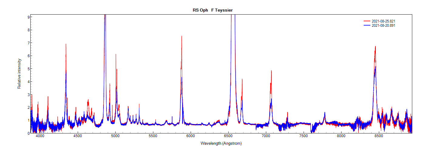

Day 16 after max.
An important milestone in the development of the spectrum: the appearence of high ionized lines in the ejecta.
NIII and He II
[Fe VII] is now obvious
[OIII] in the symbiotic nebula still raising according to the continuum
While EW([NII]) is stable at ~0.45
Now, waiting for very high ionized lines during the next month.

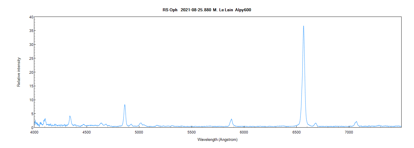

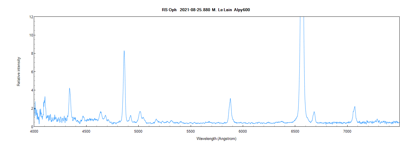

Matthieu Le Lain
Posts: 24
Joined: Mon Apr 15, 2019 4:33 pm
Post by Matthieu Le Lain »
I'm agree with Christophe, very impressive spectra Christian !
Here is a new spectrum of RS Oph with an alpy600
Zoom
Matthieu

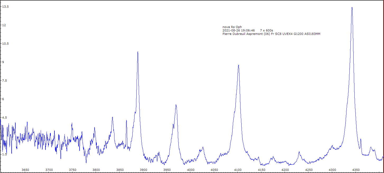

Posts: 206
Post by Dubreuil Pierre »
Bonjour
Région UV avec spectrographe UVEX(4)
G1200 slit 23µ
La magnitude semble avoir diminué .
Spectre zone UV
Spectre Nova Rs Oph
Spectre Nova Rs Oph

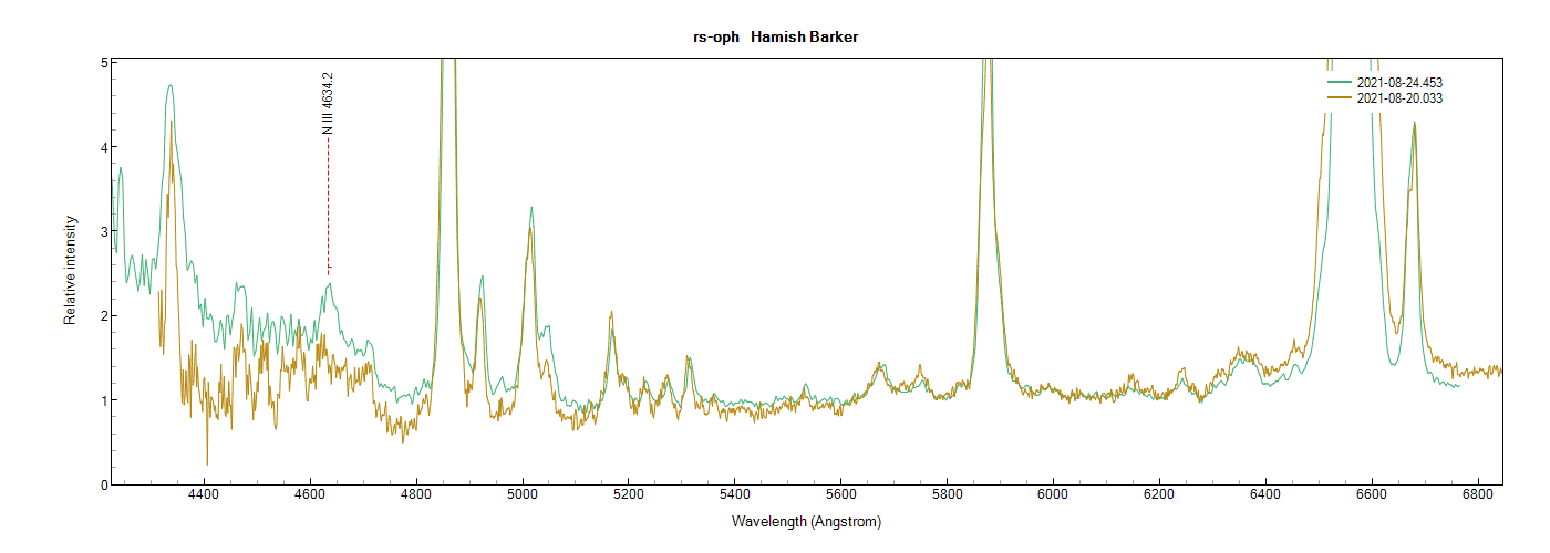

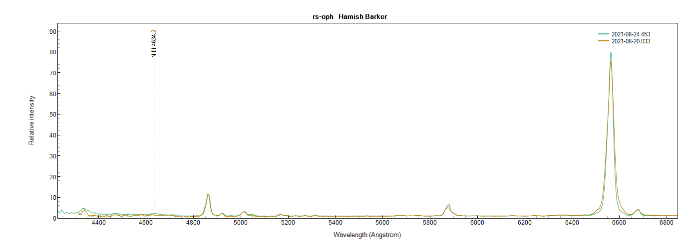

Hamish Barker
Posts: 227
Post by Hamish Barker »
Low resolution with the L200 / 180lpmm grating from a few days ago (24. August). it's raining cats and dogs today!
