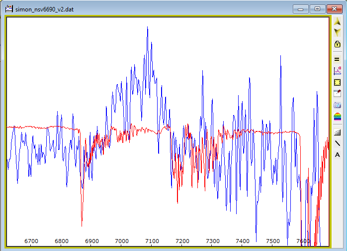

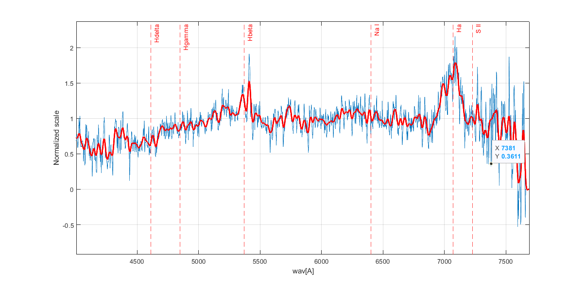

I took 10x900s last night on NSV6690. Done with the Atik414ex on the ALPY600 and Newton 400f5.
I (approximatively) annotated the spectrum without the redshift correction. The instrumental response is based on a A8V star.
The red line is a smoothed version of the blue curve. Things seems to be quite aligned with Robin's data.
The .dat file is put in attachment.
Best,
Simon
NSV6690_v2.zip
(56.08 KiB) Downloaded 1414 times

Nice spectrum Simon ! Your 400mm aperture "light bucket" is working well. My H alpha line looks wider even allowing for the difference in resolution but I think that might be due to the Telluric bands either side of the red shifted H alpha which I removed in my spectra. Are the Tellurics left in your spectrum ?

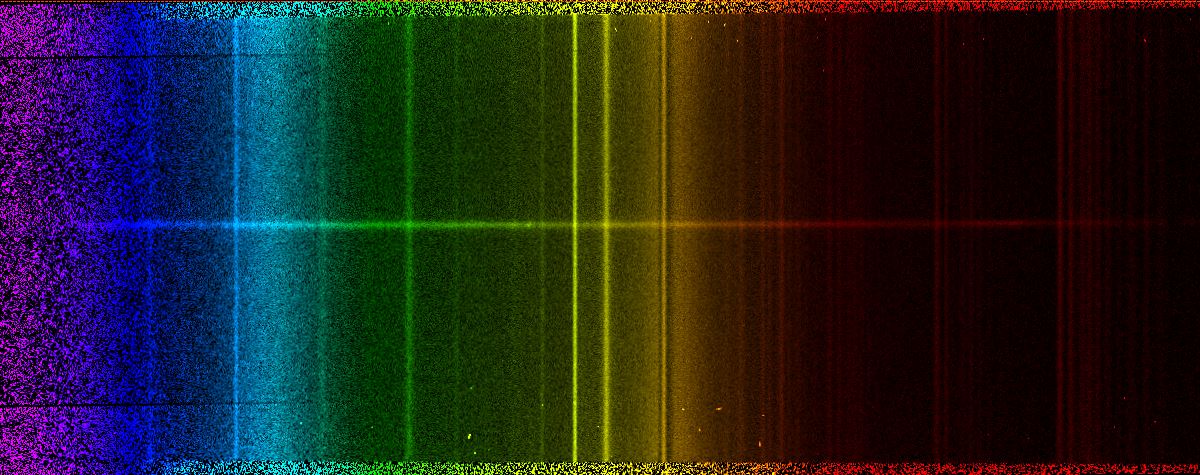

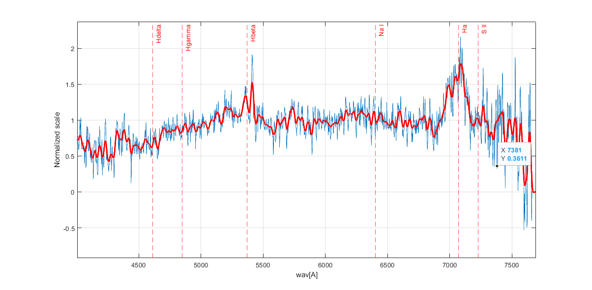

Robin Leadbeater wrote:Are the Tellurics left in your spectrum
That's a good question, and I think the following image partially answers it:
This is the spectrum without the background removal: the telluric lines do appear very clearly (do not mind the colors, that is just to make the image looking good :D) thanks to the skyglow which was apparently quite strong that night.
And this is with the background removed:
So I *suspect* that the telluric lines are efficiently removed because of this*.

I mean the telluric H2O/O2 absorption bands, not the sky glow lines. There are some strong ones either side of the redshifted H alpha and they will not be removed by the sky subtraction.
http://www.spectro-aras.com/forum/viewt ... 925#p16612
Here are the telluric bands (in red) superimposed on your spectrum. You can see the holes produced by the absorption bands
(from Christian Buil's Vega atlas http://www.astrosurf.com/buil/us/vatlas/vatlas.htm )
The recommendation for the BeSS and most other databases is to leave them in and let the end user remove them but they are not always obvious and in this case will affect the result.

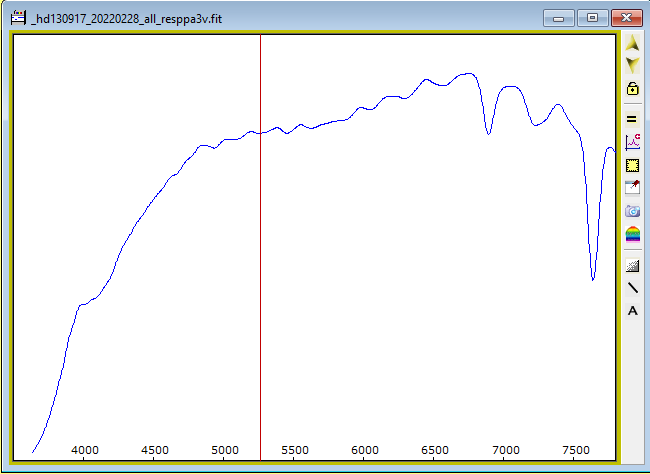

The traditional way to remove them is to make a template from your hot reference star and divide the spectrum by it. In my case I just included them in the response curve. Here is the response I used with the ALPY200 for example. You can see the Telluric bands left in.

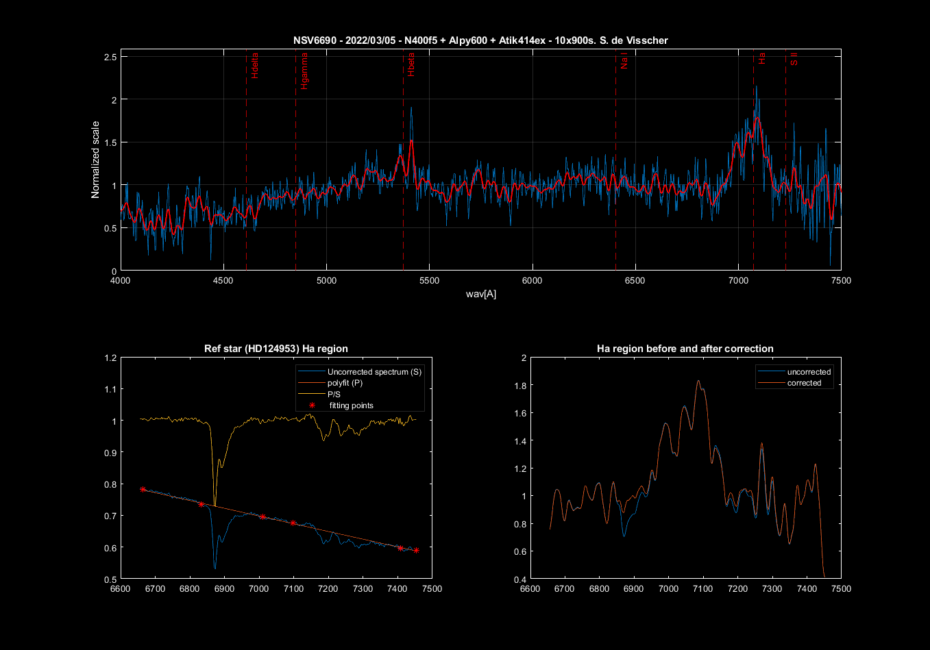

Ah no these ones I didn't do anything particular.
Robin Leadbeater wrote:Here are the telluric bands (in red) superimposed on your spectrum
Ok indeed the effect is unfortunately very strong since it affects both the blue and red tails of the Ha region. I'll try to use the reference stars spectrum to remove them, but that's definitely a delicate data correction.
Robin Leadbeater wrote:In my case I just included them in the response curve. Here is the response I used with the ALPY200 for example. You can see the Telluric bands left in.
Since the instrumental response is based on a blurred ratio of spectra, isn't there a risk to extend the correction beyond the "telluric "areas?
And aren't the high frequency variations of the telluric bands still there after the correction?

Yes including them in the response is only an approximation, you have to use minimum smoothing (It is better than nothing though) It works reasonably well for my very low resolution ALPY200 where the lines blend into bands but is less accurate at higher resolution.

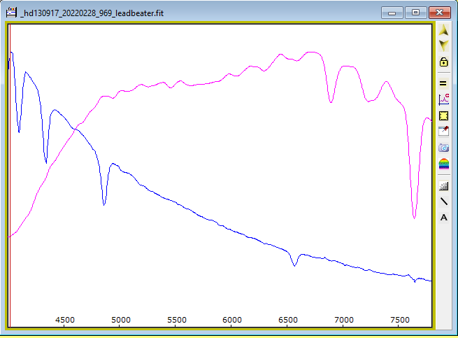

The "professional" way to do it is to produce a telluric line template from a hot reference star taken on the night, adjusting the intensity for any difference in air mass. This is then used to remove them from the target spectrum in a separate operation.
You can also use a pre-prepared template like the one I showed for Vega and "tune" it (scale and filter) to match the tellurics in the target spectrum and then divide the spectrum by it. This only really works well though if the tellurics are obvious, for example In high resolution high SNR spectra. It works well for H alpha profiles of Be stars for example and ISIS has a special function for this. Here it is used on Castor

You can test how well it works by applying the response to the reference star. The tellurics should disappear.

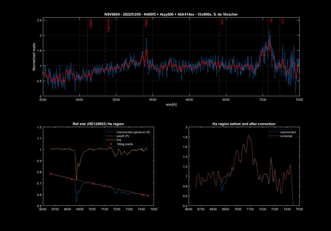

Robin Leadbeater wrote:The "professional" way to do it is to produce a telluric line template from a hot reference star taken on the night, adjusting the intensity for any difference in air mass. This is then used to remove them from the target spectrum in a separate operation.
Yes that was the "simplest" thing I had in mind. Obviously the airmass is the tricky part , but that is a second order effect, having the small over- or under-correction will be less a problem than no correction at all. The reference hot star was a A8V star at ~5 degrees from NSV6690, that should be fine.

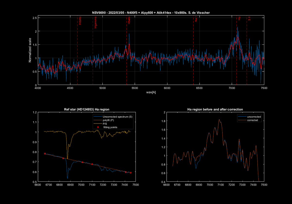

Just played a bit with the telluric lines removal using a simple polyfit to extract the low frequency spectrum and then the HF one which I use as a divider to the uncorrected NSV spectrum. The correction is done without any loss of resolution. The lower right plots are blurred *after* calculating the correction, just to help the visualization. The main conclusion is that the SNR is so low at full resolution that the effect is sub-dominant.
Anyway, that's good to try. It may become relevant if I manage to make longer sessions on that object.
