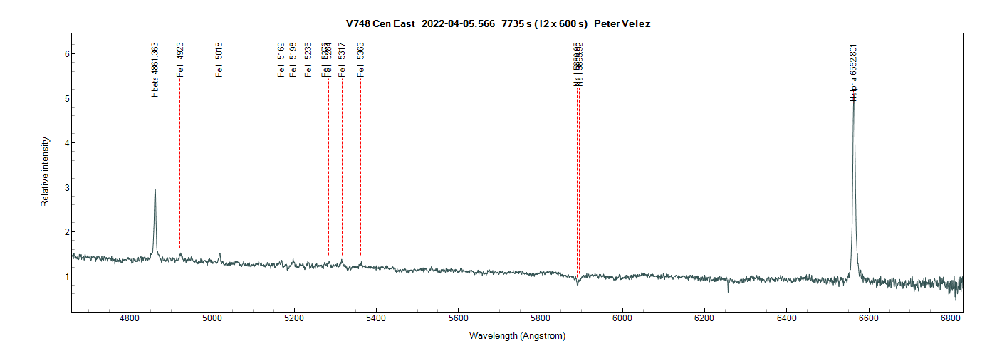

Here is my spectrum from V748 Cen taken last night. The Balmer lines are in emission and I've marked the Fe II lines that are clear (also the Na lines). The SNR is not great as it was taken with my new automated set up. I'll look to have another crack at this later in the season.
Pete
Pete
