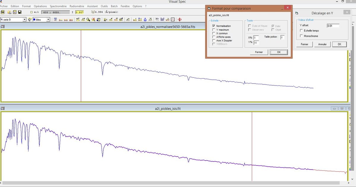

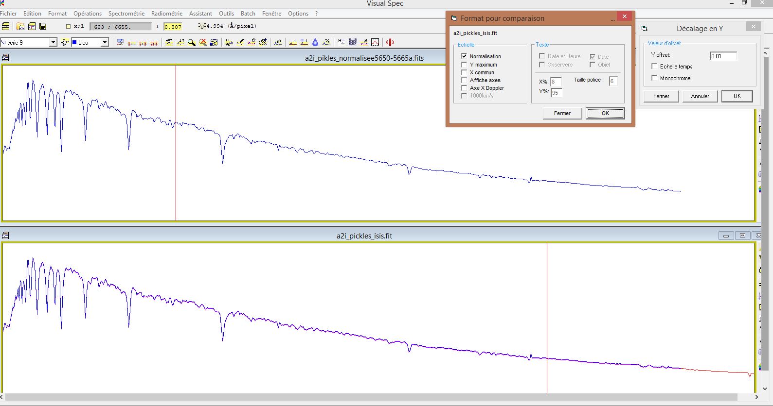

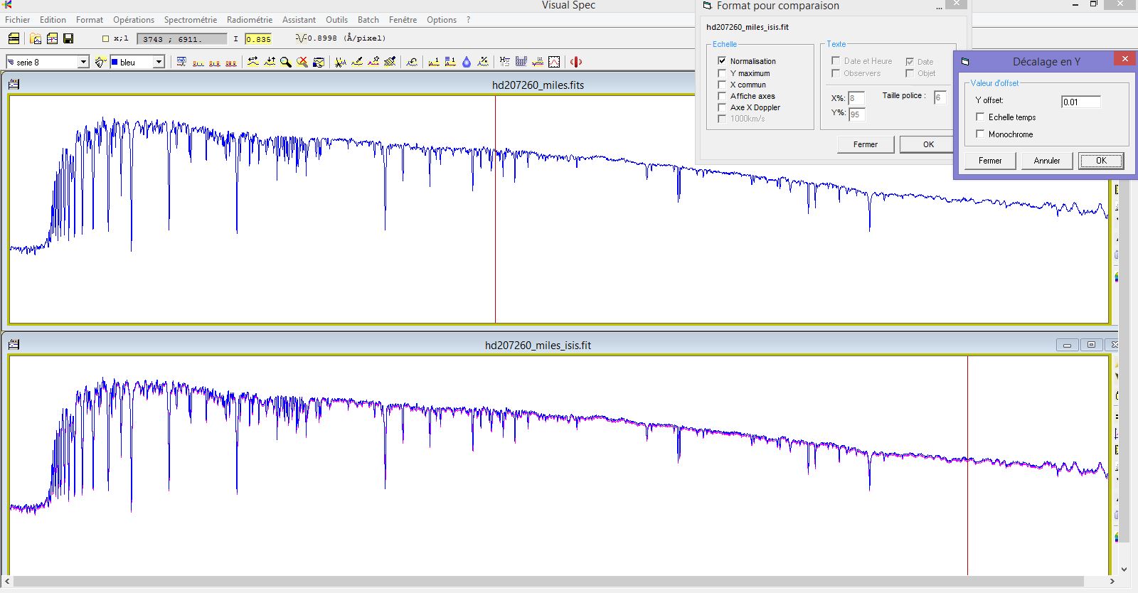

For the comparison between the Pickles profile and the hd207260_miles_ISIS you sent me and mine: they correspond exactly
(with Y Offset=0.01 for readability):
Comparison(Y_Offset=0p01)_a2i_pickles_isis.fit_&_a2i_Pikles_normalisee5650-5665A .JPG

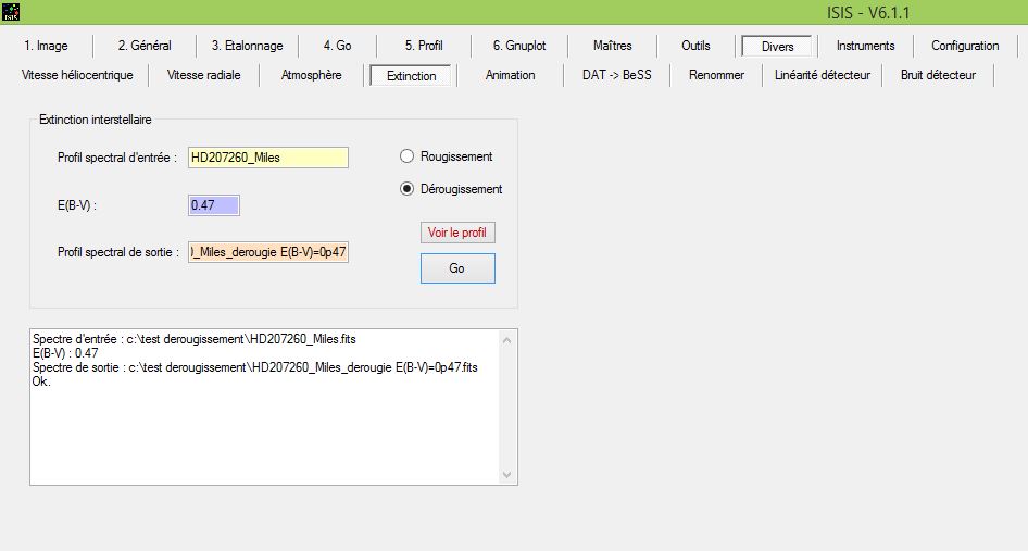

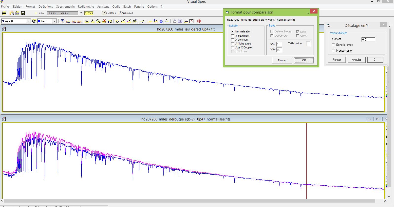

For the comparison between the profile “hd207260_miles_isis_dered_0p47” that you sent me and my profile “HD207260_Miles_derougie E(B-V)=0p47_normalisee”, there is a visible difference:
Comparison HD207260_Miles_derougie E(B-V)=0p47_normalisee & hd207260_miles_isis-dered_0p47.JPG
It seems that with the same E(B-V)=0.47, the development operation performed is not identical.
Would it come from the calculation process for dered, or the ISIS version? I used the “Extinction” tab below:
HD207260_Miles for Dered 0p47 (tab Extinction)_with_ISIS-V6.1.1.JPG (48.6 KiB) Viewed 19277 times
I wanted to do the same tests with your ISIS 5.9.3 version, but I didn’t find it on the Internet.

Re: Ecart de continuum
Yes it looks like there has been an undocumented change in the way ISIS calculates the extinction.
http://www.spectro-aras.com/forum/viewt ... =10#p17284
I have opened a new thread here to see if anyone has more information
http://www.spectro-aras.com/forum/viewt ... =48&t=3031
