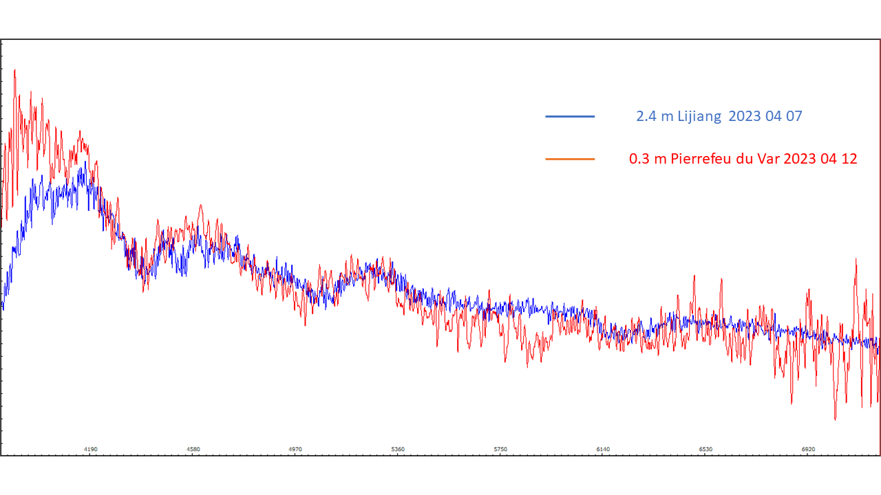

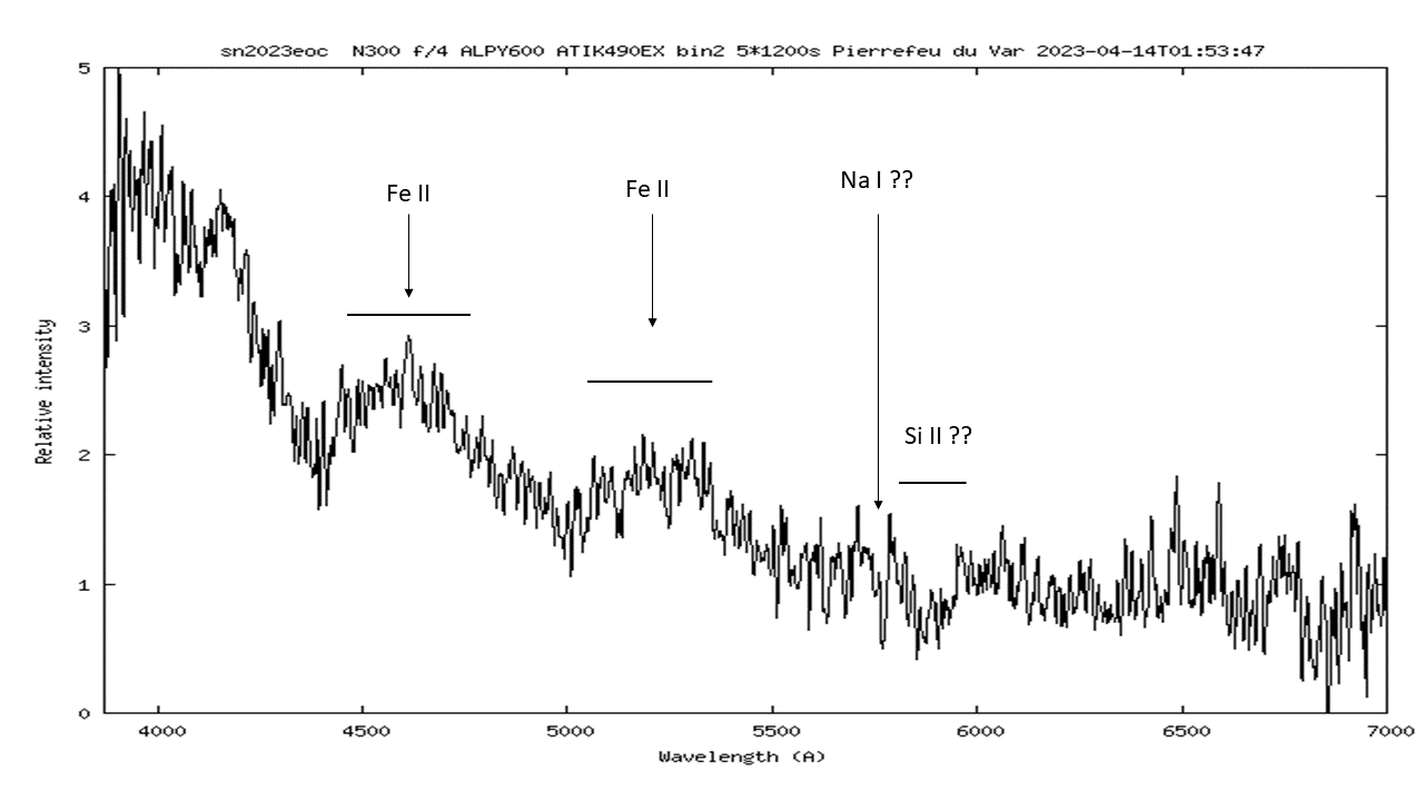

sn 2023eoc appeared in the constellation of the dragon and taked with a Newton 0.3 m and Alpy 600.
When it was discovered on April 4, it had a magnitude of 17.4 (z=0.036). It is given for 16.3 today. Host galaxy is anonymous (possible CGCG275-028)
See the comparing spectrum with that obtained by the spectro mounted on the 2.4 m Chinese Lijiang telescope. Apart from a small anomaly on my spectrum around 5850-5900 A that could correspond to the band of blueshifted silicon, the profiles appears substantially similar.
