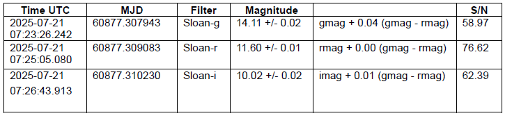

The photometric results:
Nova Ser 2025

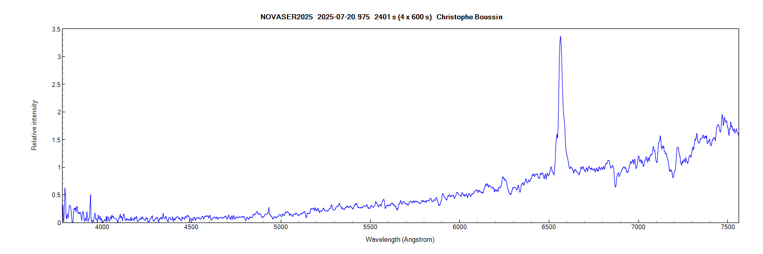

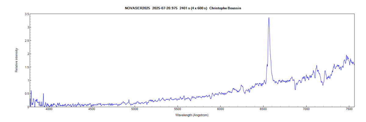

Thank you very much François for this field, because the Nova is not so easy to find !
Here is my contribution to the monitoring of Nova Ser 2025.
I obtained the following spectrum the 20th of July at 23 h 24 UT with my Alpy 600 (resolution of 516, JJ = 2460877.4753) and an acquisition time of 40 min (4 x 600 s) :
Clear skies,
Clear skies,

Nice spectrum, Christophe.

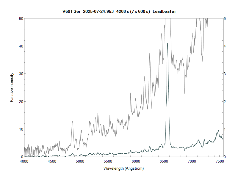

Re: Nova Ser 2025
An ALPY 600 spectrum from last night

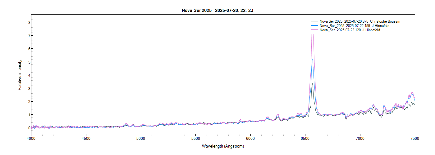

Re: Nova Ser 2025
These three spectra of Nova Ser 2025 were collected at ~24 hr intervals, the first by Christophe Boussin and the other two by me, all with the Alpy 600. The three spectra have been added to the ARAS Spectral Database: https://aras-database.github.io/databas ... r2025.html
-- Jerry Hinnefeld
-- Jerry Hinnefeld

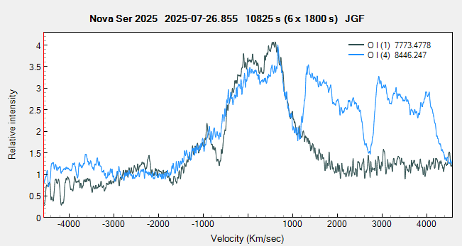

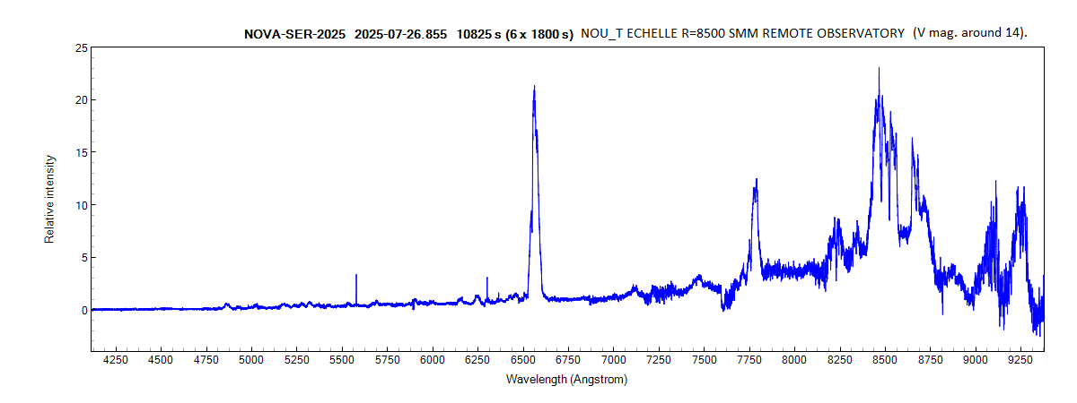

After a lot of cloudy days I could observe Nova Ser 2025 yesterday night. It was on the boundary of SMM remote equipment,
but I have been able to reach this graphics by a NOU_T echelle.
Cheers, J. Guarro.

- Posts: 1562
Re: Nova Ser 2025
That's very great, Joan.
Congratulations for the NOUT and the spectrum.

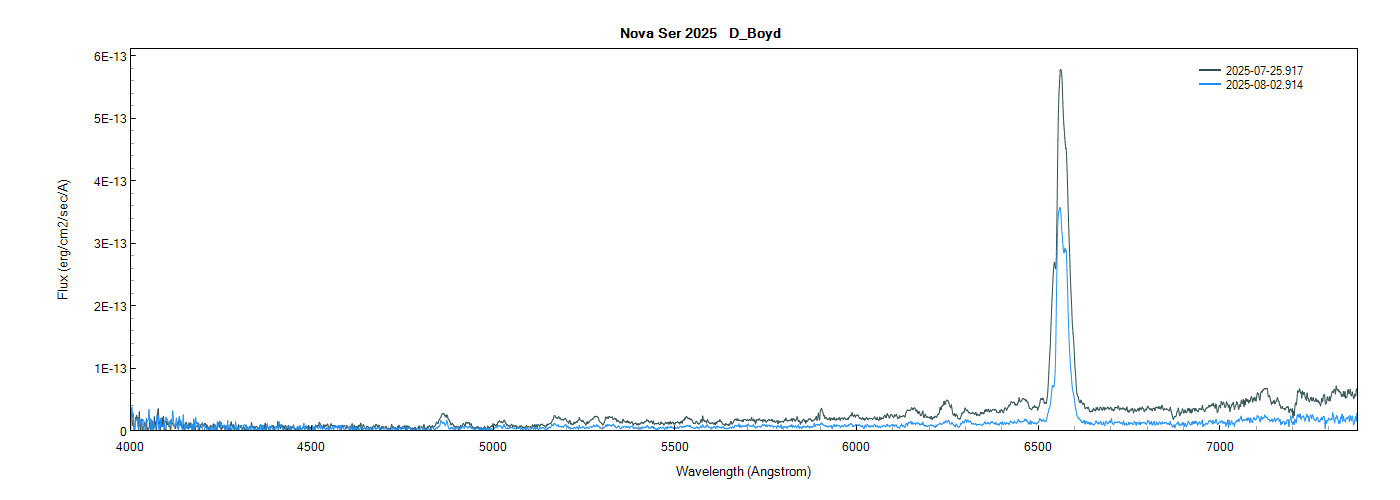

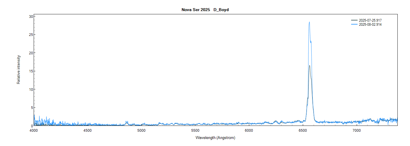

Re: Nova Ser 2025
Spectra of Nova Ser 2025 were recorded with a LISA on a C11 on 25th July and 2nd August, 8 days apart. When these spectra are compared in relative flux, it appears that the H-alpha emission line is increasing in strength.
However, when these spectra are calibrated in absolute flux using concurrently measured V magnitudes, it is clear that flux in the H-alpha line is decreasing - from 2.25E-11 erg/cm2/sec on 25th July to 1.24E-11 erg/cm2/sec on 2nd August. V magnitudes were 13.49 and 14.47 respectively.
