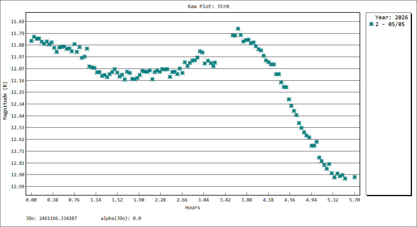

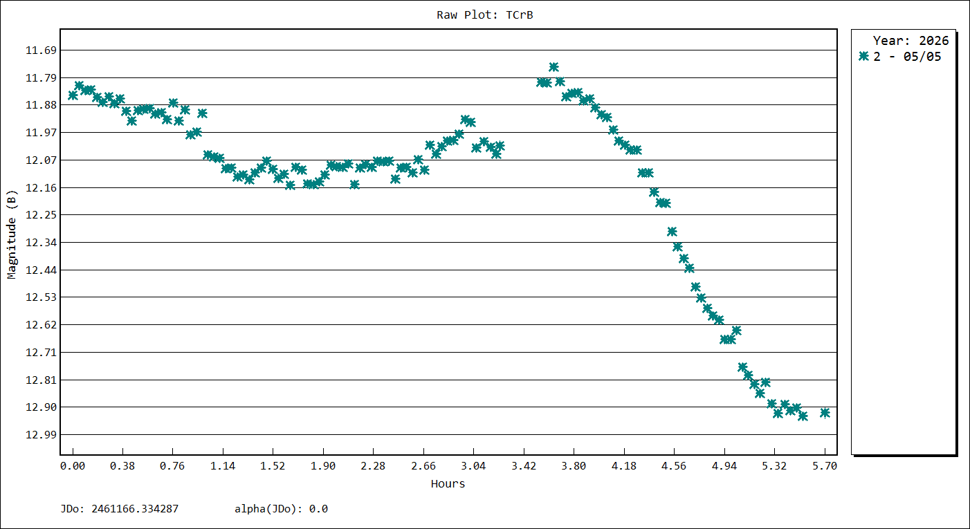

Hello

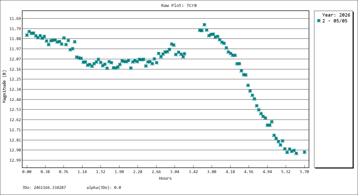

I started a photometric analysis of this recurring nova a year ago, with some interesting results this year. I found some fairly large amplitude fluctuations in the U band. This type of flicker is not uncommon for such stars. What was a bit unusual (in my humble opinion) was the amplitude of the flicker - about 1 mag.

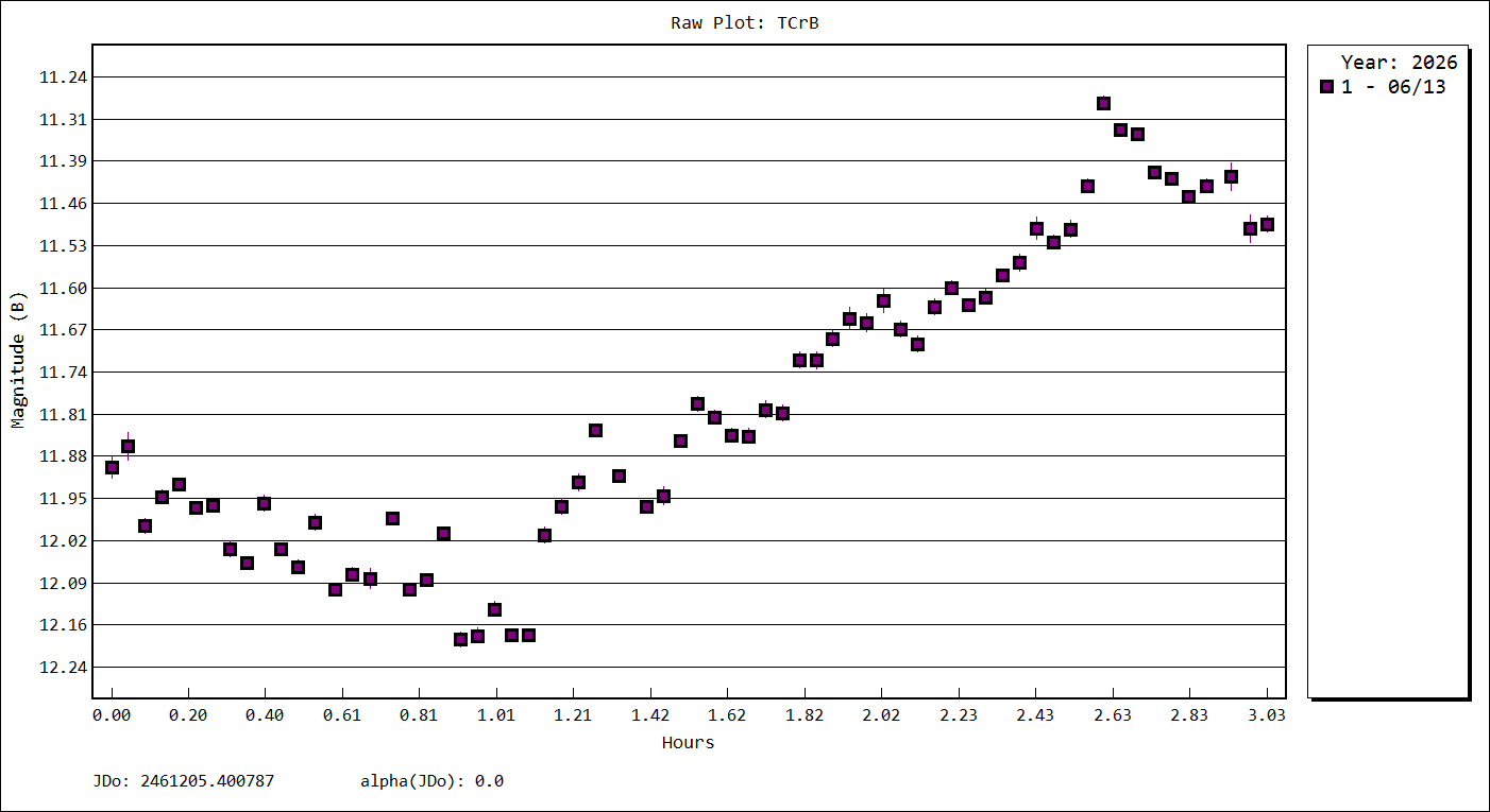

The most interesting fluctuation (but not the only one) occurred on 05.05.2026. Attached is the photometric graph from that night. Another interesting night was 13.06.2026.

Re: T CrB latest spectra
Have you performed an autocorrelation test (LombSscargle, Edelson-Krolik..), in order to assure that it is really flickering. The drop in the second graph looks very (too!) smooth

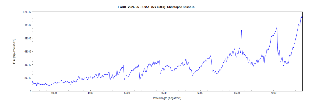

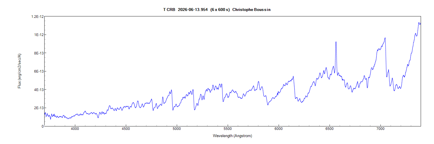

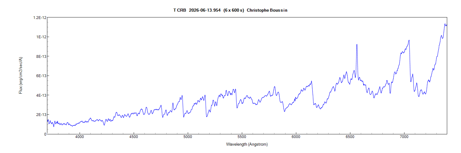

Hello Cristian,
I recorded an absolute flux calibrated spectrum of T CrB with my Alpy 600 on June 13, 2026 (resolution of 517, JJ = 2461205.4538 (start of my observation)) and an acquisition time of 60 min (6 x 600 s) :
T CrB on June 13th, 2026 (3700-7396 A)
This spectrum is available on the ARAS database in FITS format.
I measured an average V magnitude of 10.031 (standard deviation = 0.015) over the duration of my data acquisition.
Unfortunately, I didn't record a spectrum of T CrB on May 5, but I hope this one will be useful to you !

Francois Teyssier wrote: Mon Jun 22, 2026 6:45 pm Have you performed an autocorrelation test (LombSscargle, Edelson-Krolik..), in order to assure that it is really flickering. The drop in the second graph looks very (too!) smooth
I have PERANSO to find periodicity of light curves. PERANSO use Lonb-Scargle method to determine periods in specific cases, but in this context I do not understand what an "autocorelation test" is.

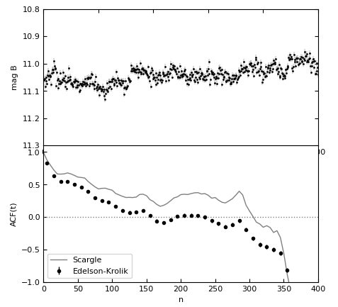

The variations in brightness of T CrB (and other symbiotic stars whose main source of energy is accretion) on a short timescale (minutes to hours) produce a flickering phenomenon, the cause of which (as is generally accepted) is accretion through the boundary layer from the disc towards the white dwarf: accretion does not occur at a uniform rate but in bursts. This results in stochastic, quasi-periodic (QPO) variations. Determining whether an observation is quasi-periodic requires an analysis of the signal using autocorrelation.
Here's an analysis on a series (B Band) obtained by Xavier Dupont:
The autocorrelation function is more or less a straight line with a negative slope: flickering is confirmed.
A non-variable star would have produced a horizontal line with an y-coordinate of 0. A periodic star would have produced one or more peaks corresponding to the period (as in the example you cite, using Peranso, for instance).
Note: here the graph is plotted against the number of observations; it would be preferable to plot it against frequency.
I hope it's help.
