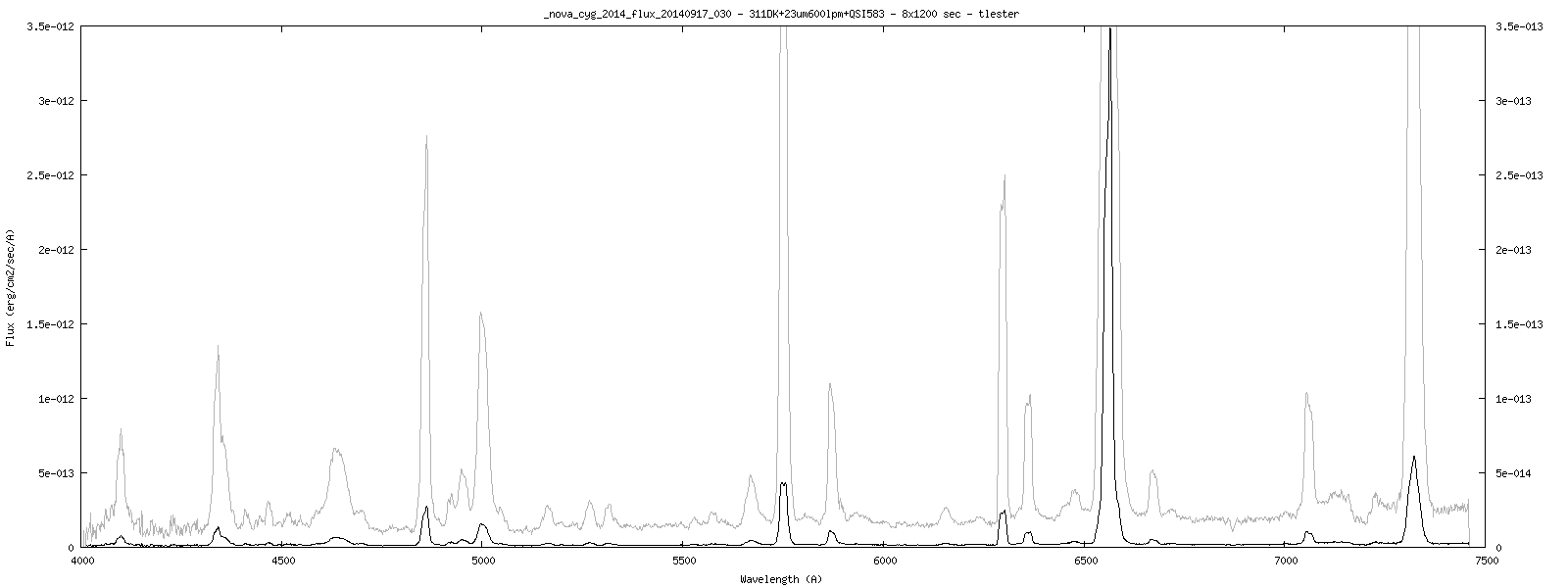

Re: Nova Cyg 2014 = PNV J20214234+3103296
Post by Tim Lester »
Nova Cyg for Sept 17 calibrated for flux.
Multiplying by the V Bessel function gives a V magnitude of 12.65, in very good agreement with AAVSO data.
