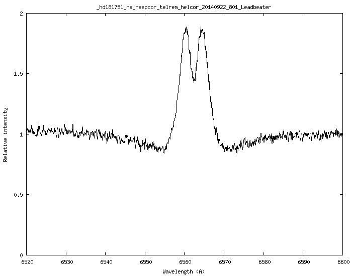

The fully calibrated H alpha line from last night
LHIRES 2400 4x 600sec R~16000 SNR ~60

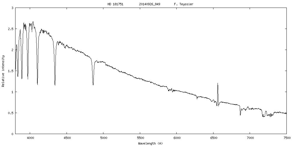

A spectrum of Andrew's Star (HD 181751)
LISA R = 1200

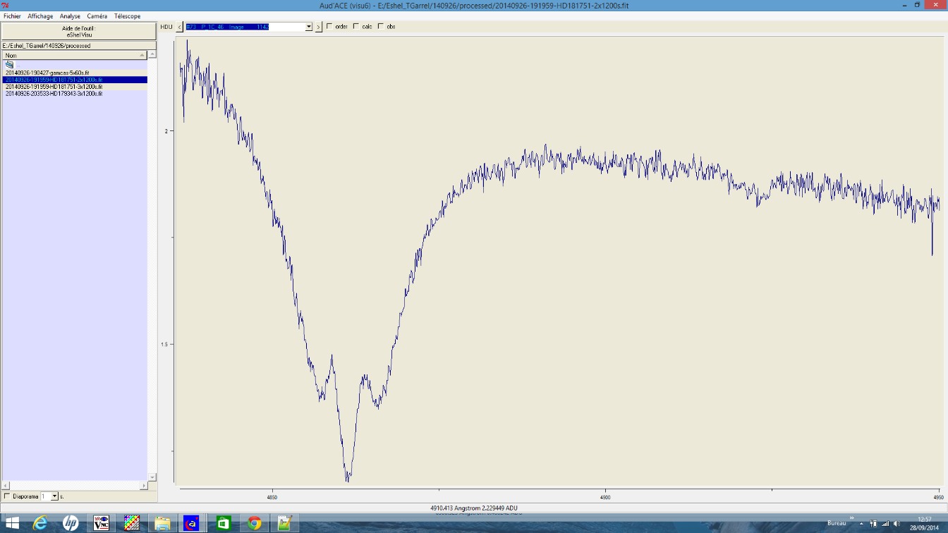

There is also a weak emission in HeI5876 and HeI6678. No forbidens lines and very weak FeII absorption lines. Could be a good Be candidate.
Attached here is h beta,
