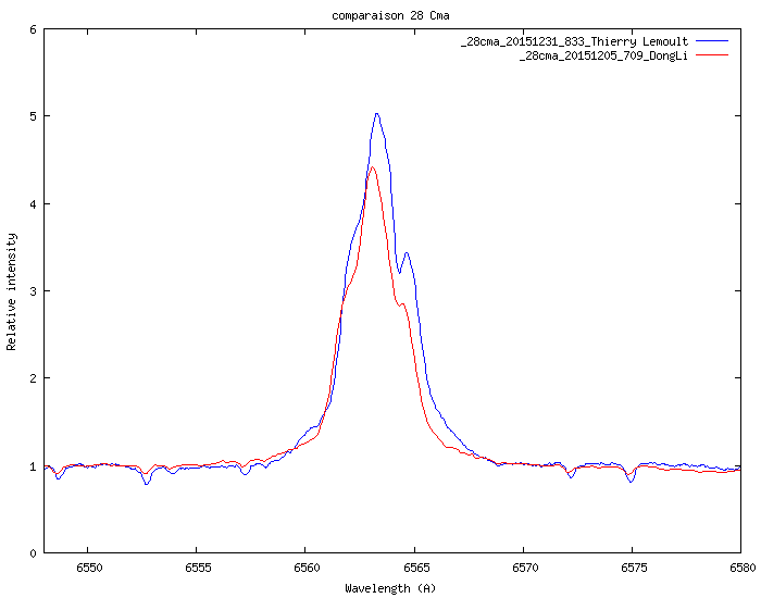

Thierry Lemoult
Posts: 136
Re: 28 CMa outburst
Post by Thierry Lemoult »
Hello
I took a new spectrum of 28 Cma last night and the night before. The Ha emission continusly increase. Relative continuous: more than 5 unit now.
LHIRES 2400T, Telescope Newton 200mm. R=17000. From Abu dhabi, lat=25°N. This star is high is the sky. Alt=35°
